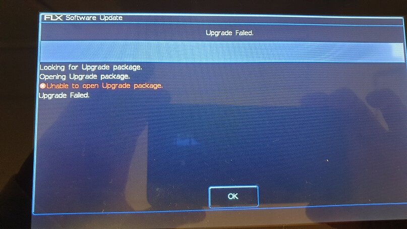

M. Torka Posted December 6, 2021 Report Posted December 6, 2021 When I try to load the ZerOS 7.9.9.5exe from USB stick, load Setup & Palettes, I get the respose: Looking for Upgrade package in red: File does not contain an Upgrade package upgrade failed. What goes wrong? Quote

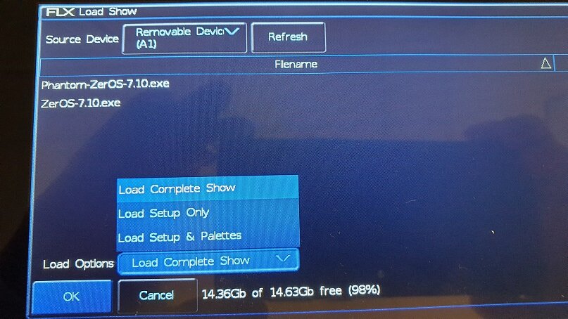

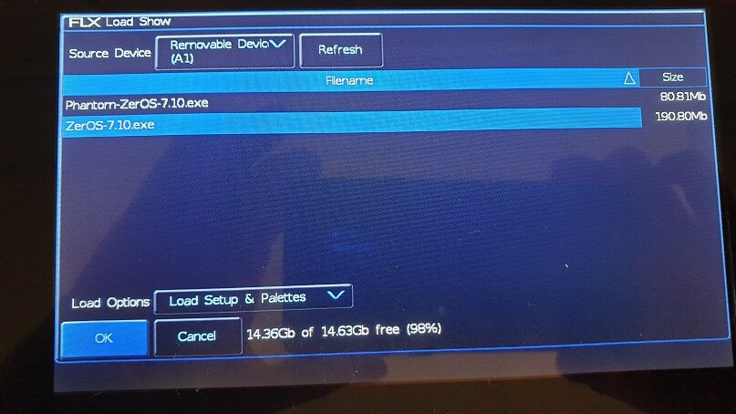

M. Torka Posted December 7, 2021 Report Posted December 7, 2021 (edited) Hi Edward, in my understanding 7.9 is higher = newer than 7.1......but nevertheless, the actual update is 7.10. I´ve downloaded this .exe file from your website, transferred the file to a FAT32 formatted USB stick and put it into the FLX S24 USB input. The initial situation on the console is seen on Pic1. The I did it as recommended, see progress in the Pic2,3,4 and 5. What is wrong? Why can the console not find the update file????? KR Marius Unfortunately I´ve no idea and need your help. KR Marius Edited December 8, 2021 by Edward Z88 Serial number hidden Quote
Edward Z88 Posted December 8, 2021 Report Posted December 8, 2021 Hi Marius, Thank you for attaching images of the process. 13 hours ago, M. Torka said: I´ve downloaded this .exe file from your website, transferred the file to a FAT32 formatted USB stick and put it into the FLX S24 USB input. 13 hours ago, M. Torka said: What is wrong? Why can the console not find the update file????? Good question. From your images, everything seems to be correct. You will receive this "Unable to open Upgrade package" error message when loading "Phantom ZerOS" into a console, but shouldn't see this when loading the console software. If you haven't tried already, please download a fresh copy of the software, and transfer this to the USB drive and overwrite the original file. Please then plug this into the console, tap SETUP, tap Load File, and then choose ZerOS 7.10.exe and click OK. As a side note, the "Load Options" are only used when loading in show files. Please let me know how you get on. Edward Quote Edward Smith Formerly: Zero 88 Product Specialist - Email Support Currently: Obsidian Control Systems Product Specialist

Troncosauce Posted December 12, 2021 Author Report Posted December 12, 2021 I found my problem, Do not attempt to open the 7.10 download on your pc/mac but send the unopened file directly to your usb stick. Quote
