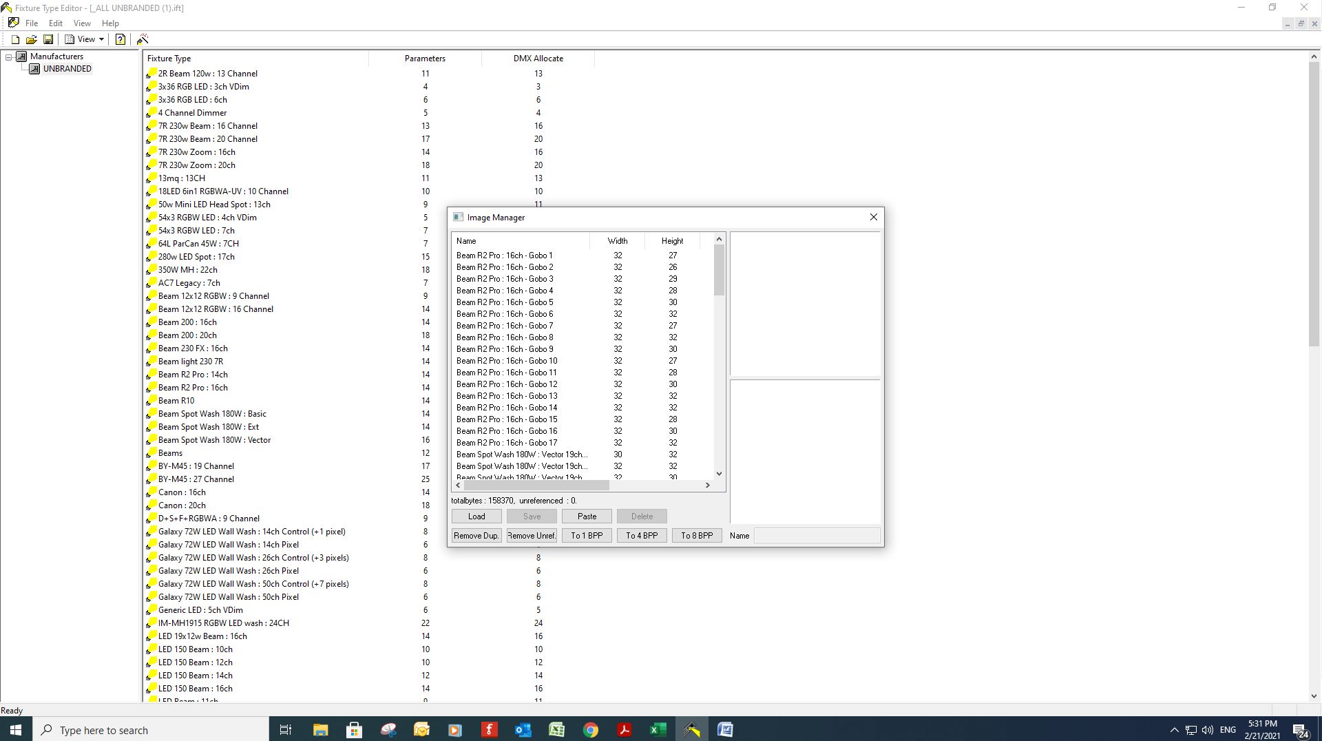

Hello Edward
I am working my way through the ALL_UNBRANDED.ift and I opened up an Image Manager. Is this a stand alone program that I can use to add gobo pictures to my moving head profiles?
Thanks
Don
The Image Manager is just part of the Fixture Editor tool. You can add gobo images that will display on the FLX by attaching the images for each gobo under the Detail tab of the appropriate Beamshape attribute for the fixture within the Fixture Editor software.
Hi Don,
As @kgallen explains, the Image Manager is part of the Fixture Editor, not a stand alone program. It can be used to show you all the images used by fixtures in the current fixture file.
To edit the gobo images of a gobo parameter, go to the properties of the gobo parameter of a fixture, and then go to the details tab at the top. You can then edit the details, including loading images to a detail.
