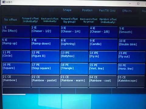

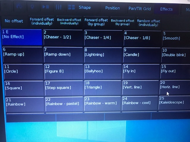

Hello Edward
infortunatly I can’t come back to version 7.9.8 on our FLX48.

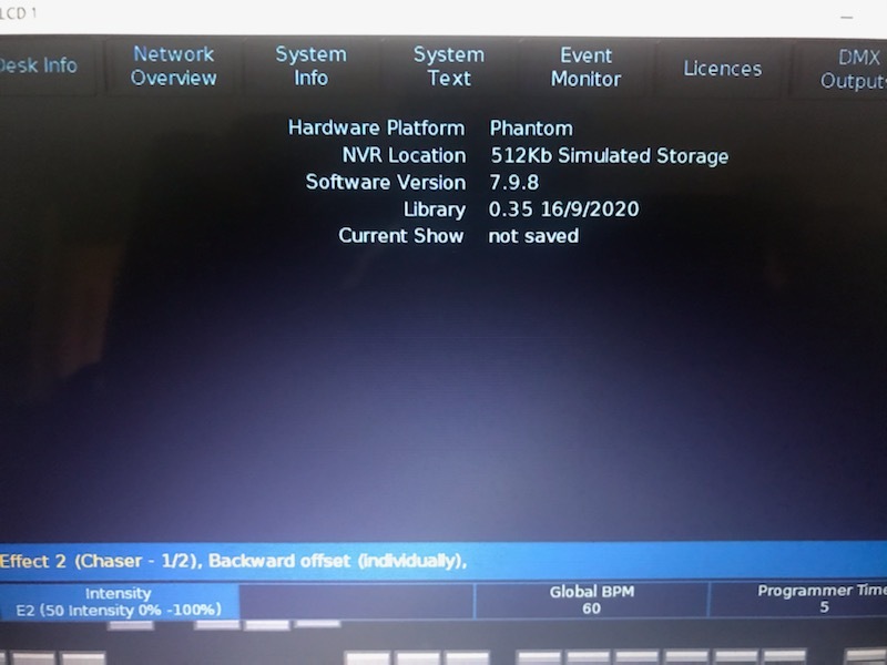

But, I did some experiences on phantom on my PC.
I desintalled  Phantom 7.9.8 and re-installed it from file extracted from Zero88 web site.
After that I see in system information that the library version is 035. See photo 1.
In this configuration, effects correctly works for my motorized spots. See photo 2

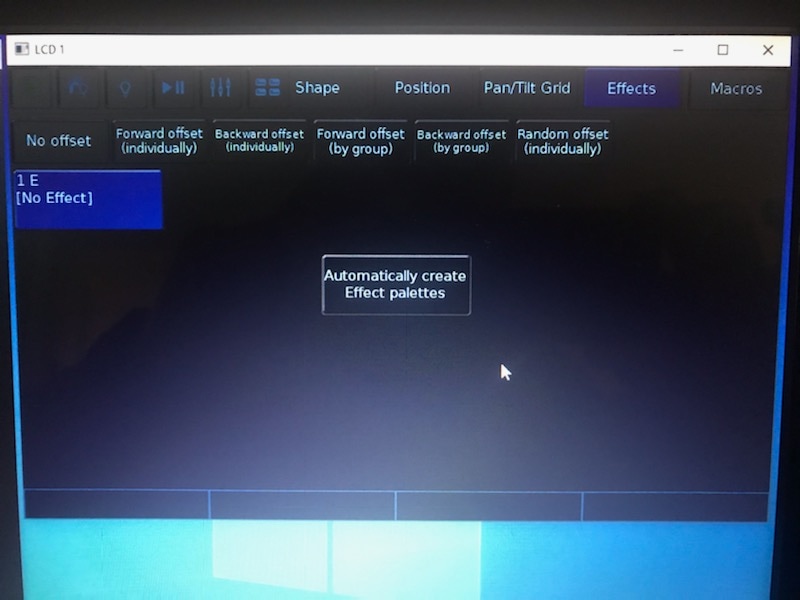

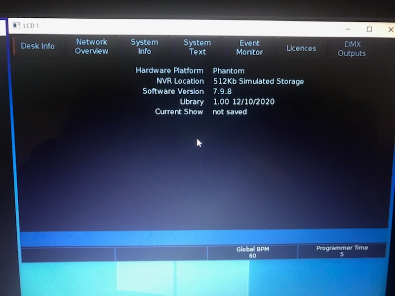

To continue my experience, I loaded the library version 1.00. See photo 3
Now the effects no more work. All previous one are now grey. See photo 4
When I pushed the « automatic create effect » button, all grey buttons disappear. See photo 5.
To summarize, From my point of view the problem is more from library 1.00 than from 7.9.8 version.

Hi Michel,
Thank you very much for your investigations. We have found that ZerOS Library v1.0 has auto effects missing, whereas they are included in Library 0.35, which is part of the ZerOS 7.9.8 download.
Therefore when you are ready to, please download a fresh copy of ZerOS 7.9.8 from the website, and do not update the Library separately. We have removed the Library file from the website until we release a new version.
Thanks very much, if you have any questions let me know.
