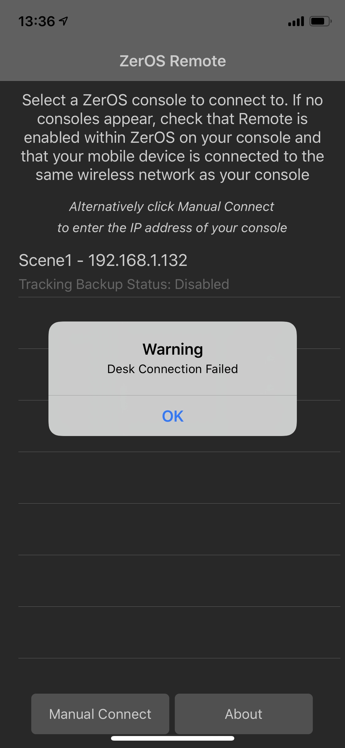

PerS Posted August 5, 2020 Report Share Posted August 5, 2020 I've got a similar problem, but on an Iphone. Both remote and monitor apps give med the same error, "Desk Connection Failed" I've tried with and without password, I've tried to change the DHCP-range. Any suggestions? Console software 7.9.7, Zeros Remote version 4.2.7.14 Per Quote Link to comment Share on other sites More sharing options...

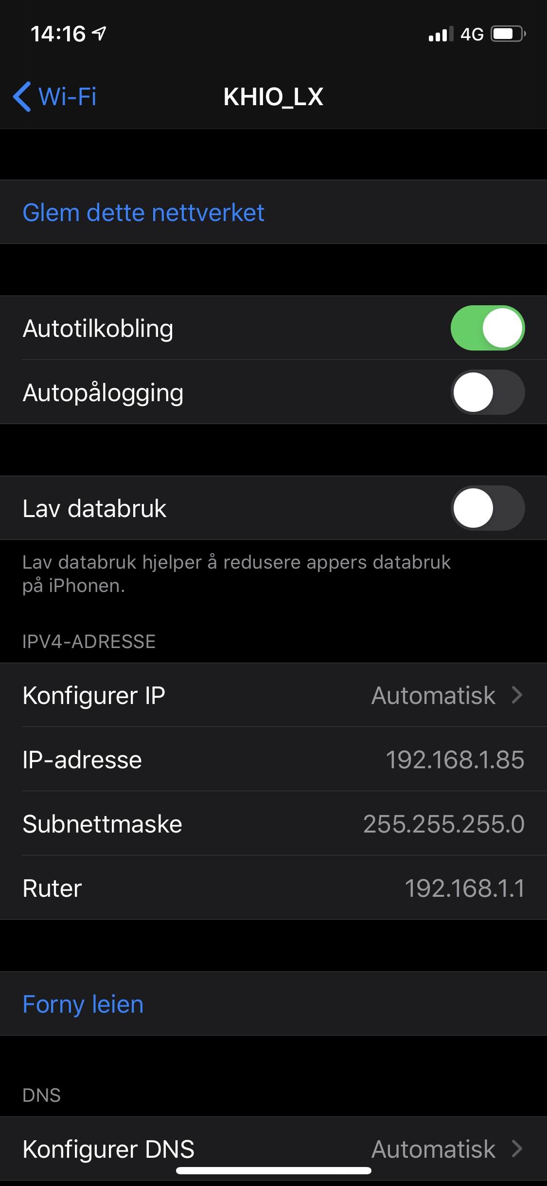

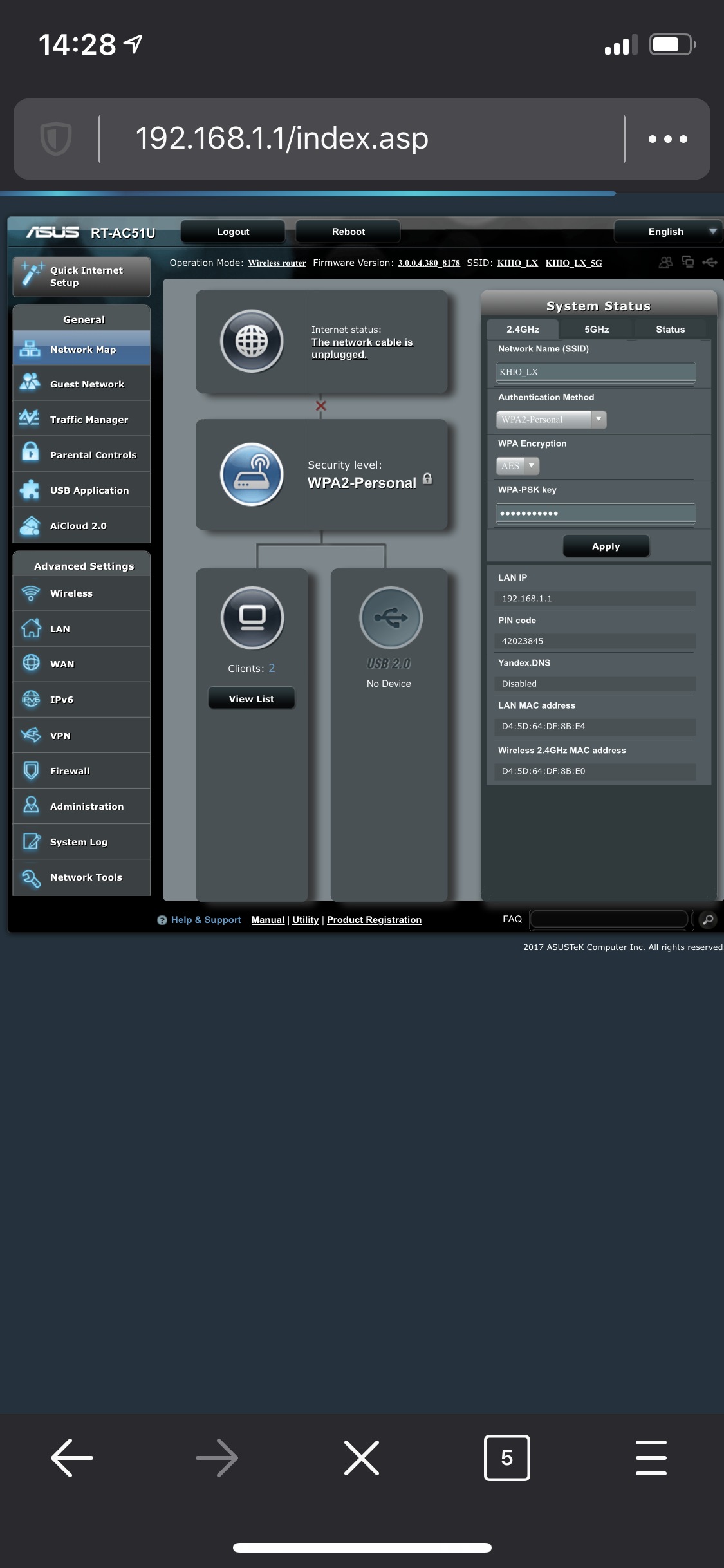

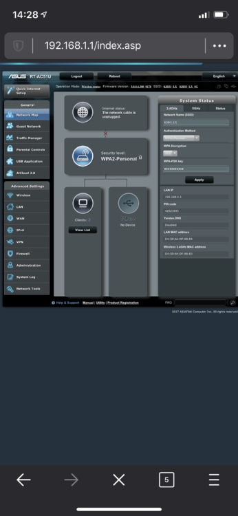

PerS Posted August 5, 2020 Report Share Posted August 5, 2020 Thanks. The network has DHCP, and is just 3 units; the router, FLX S48 and my Iphone. And as the name of the console "Scene1" with IP-adresse is showing, I'm expecting the phone and console to be in contact. The ip of the phone is 192.168.1.85. (router is 192.168.1.1) The phone connection to the network enables me to open the config-page of the router, so I beleive the phone should be correctly connected. Quote Link to comment Share on other sites More sharing options...
