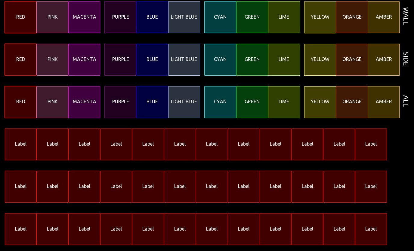

Davidmk Posted October 29, 2023 Report Posted October 29, 2023 3 hours ago, Hummel said: OSC seems to open a lot of options and I'm curious about those possibilities It sort of does and doesn't. All I'm doing with it really is using it to give single key access to go cue. TouchOSC lets me put a label on the button and give it a colour so I can find it quickly and it lets me line up several go cues to execute (almost) at the same time. Each button can execute the same go cue in multiple playbacks and, although I can't change which on the fly I can switch them in and out. There's something like 2000 lines of code in it. I used to be a computer programmer so it wasn't too hard to pick up the new language but it still took me a few weeks to write and I still regard it as a trial version. Quote
Hummel Posted October 29, 2023 Author Report Posted October 29, 2023 Quite impressive and very well structured! So you can select different parameters for all of your fixtures and "GO" all at once. Nice. If I'm gonna be using OSC, I'd be happy if it just gives me some buttons to select different cues directly (a color, a position...). FIrst layout inspired by your picture to gain access to colors for wall and side seperately or all the same. (The last three rows are just placeholders right now). And those are just nice looking buttons without any OSC-messages yet. Quote
