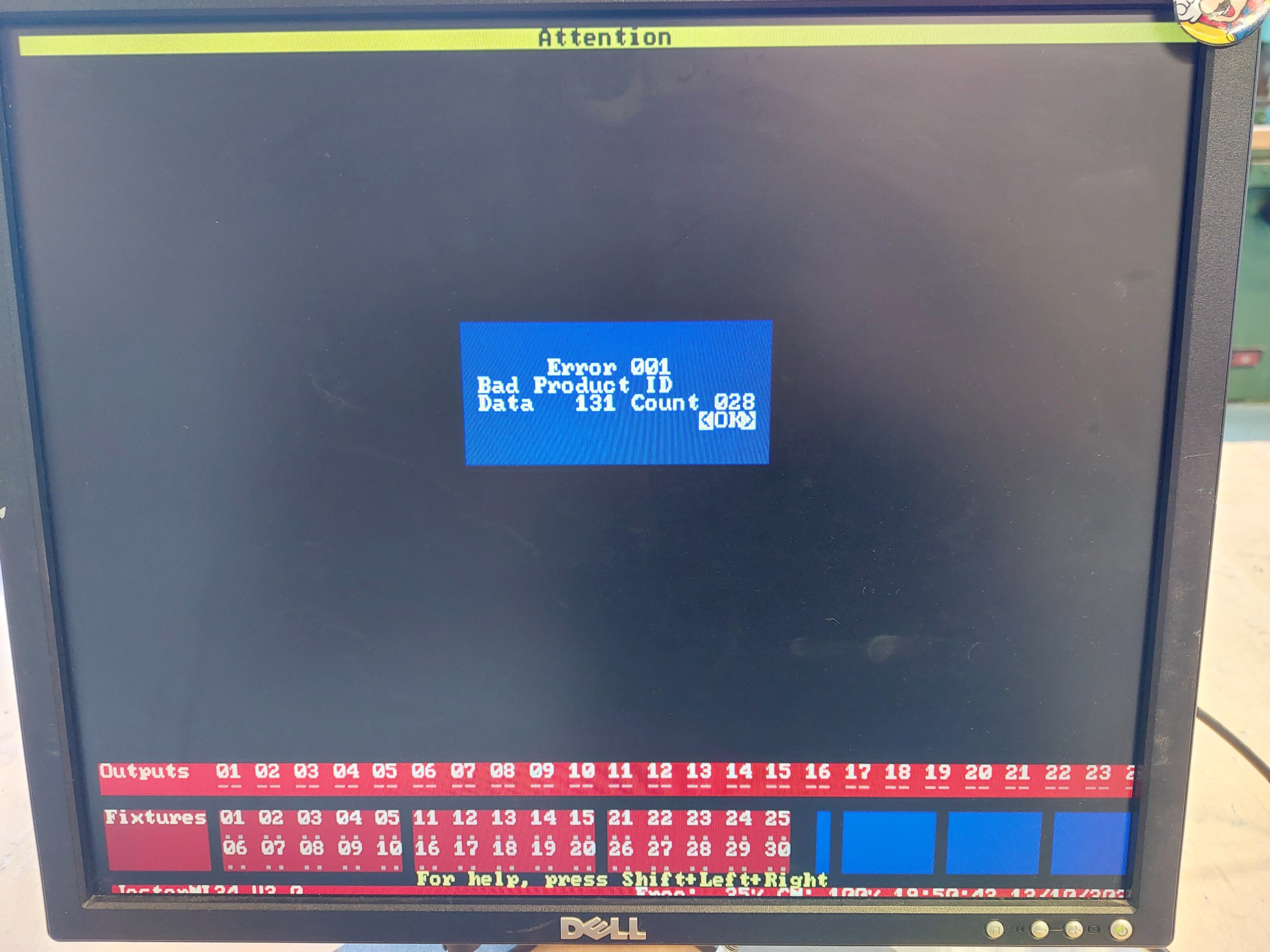

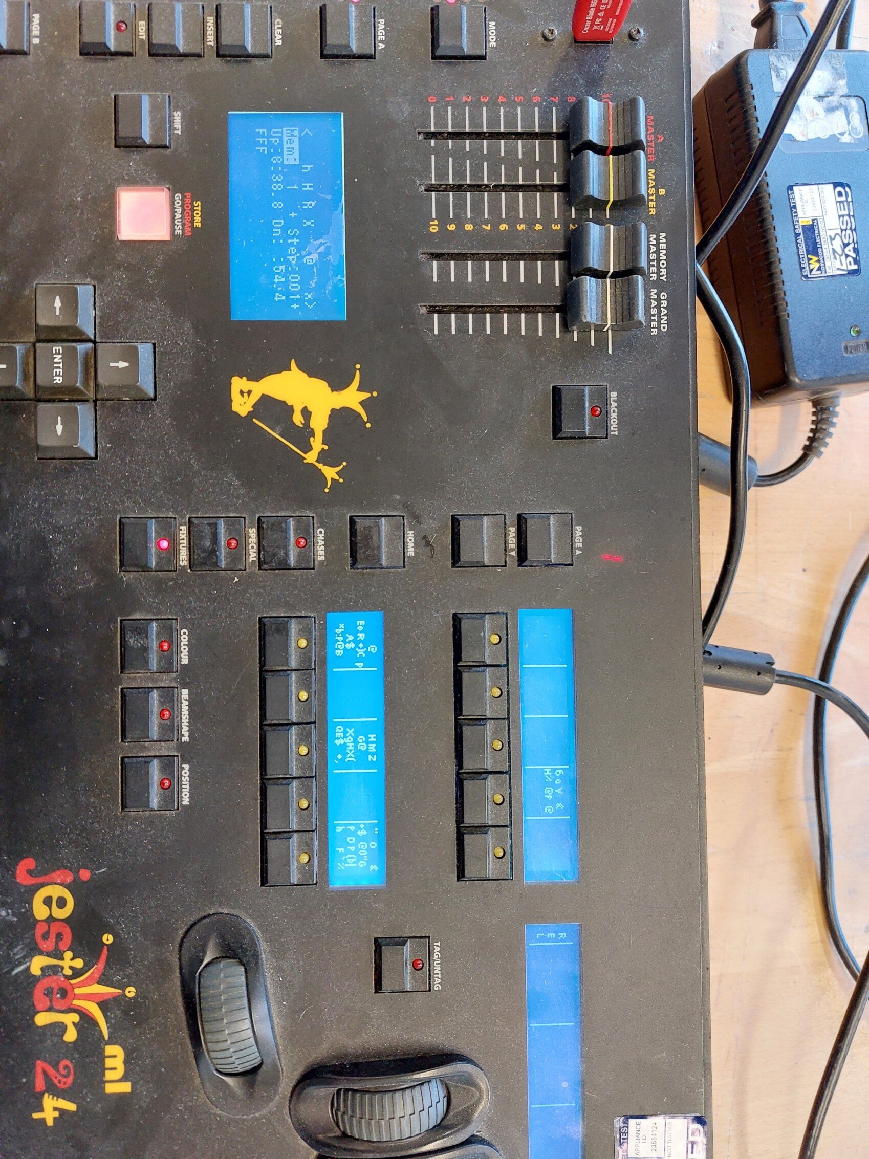

Mr Willis Posted October 24, 2023 Report Posted October 24, 2023 Hello, having read other posts, this seems to be a recurring theme, I am a technician in a school that has no previous experience with this sort of equipment, Help!!!!! I have worked here for several years and it has worked well, but its now been brought to me with an Error 001, I have followed a few threads in here and done a few basic things, I have replaced the internal battery, I have downloaded and extracted and ran the .Jos file and everything seemed to work correctly, pressed enter and I am back to where I was before, the error comes up, before i done the battery change and update hand I was getting weird text on the screen but now the enter button wont take me out of the error message. ill add another couple of images, any help would be greatly appreciated Ross Quote

Mr Willis Posted October 24, 2023 Author Report Posted October 24, 2023 Hi Jon, thanks for the timely reply, the buttons all work fine when I powered on holing the left+right arrows and went through the update sequence. Pressing enter causes the fixture led to come on so something is happening Quote
iank99 Posted October 25, 2023 Report Posted October 25, 2023 Sorry to hear you're having hassle with your Jester ML - Keith will be along soon with a better solution but for the time being... 'Bad Product ID' is usually because the battery has failed - once the battery is replaced then selecting 'OK' should boot the desk - first thing to do before all else is to a Clear/Reset in SuperUser before doing anything else so the desks internal processor tables can be set to a default vale - this often resets the 'Bad Product' message. Daft question but was the new battery inserted correctly ii.e not upside down? It does happen - I had a customer do this earlier this year & swore blind the desk was corrupted until he realised someone else had replaced the battery and put the new one in the wrong way. (To be honest - in my experience Jesters have proved as reliable as the old Sirius) What happens if you remove the update flash drive and just power the desk on with no buttons held down? I can't say for definite but the presence of a flash drive as the desk boots might be skewing things - it shouldn't but it might. I've had it happen to me, the USB bus is initialised early in the boot process to ready a keyboard or it might simply be trying to 'size' the flash drive - this might be upsetting the boot process? If all else fails - I have a couple of processor boards in stock, along with an ML front panel and fader boards - I'm sure we can get you sorted but it's likely to be something simple. 1 Quote Ian Knight aka The Service Guy - www.serviceguy.co.uk
