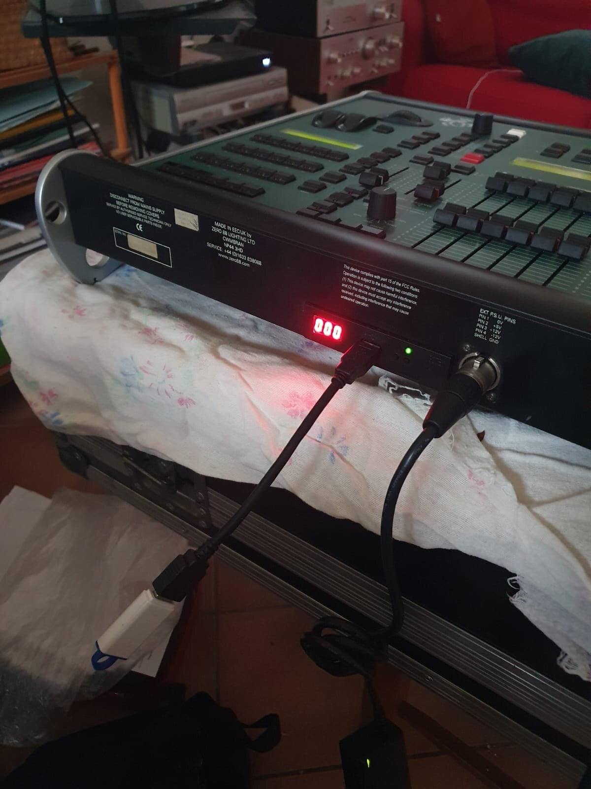

iank99 Posted May 2, 2023 Report Share Posted May 2, 2023 It looks like you're using a GoTek Floppy Emulator on that desk - I'm not sure how the Zero firmware update calculates checksums but it might well be that the emulator isn't returning the correct values to create the checksum - so the routine will always fail I would try a boot with a conventional floppy disk if you can find one - there's nothing special about the disk & if you're careful it needn't be screwed in to the chassis, you might get away with resting it on some cardboard alongside the mainboard (the cardboard is for insulation). If you can get the Zero upgrade disk to boot and upgrade then you should be able to revert to using the GoTek for show files as you have been doing. Quote Ian Knight aka The Service Guy - www.serviceguy.co.uk Link to comment Share on other sites More sharing options...
Renato Posted May 2, 2023 Author Report Share Posted May 2, 2023 perfect tomorrow I 'll try by it's original floppy disk device. I own another leap frog that works fine with IPCAS emulator so I can try to use that device cause on the second desk I can load SO by IPCAS without problems. Quote Link to comment Share on other sites More sharing options...

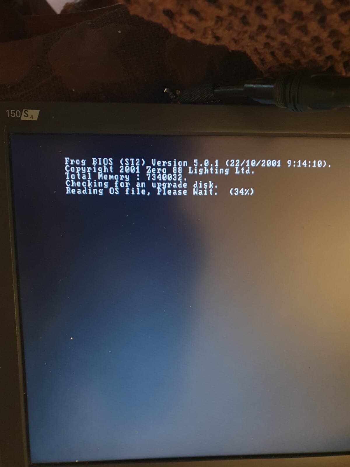

Renato Posted May 4, 2023 Author Report Share Posted May 4, 2023 Hi Iank. Cleaned RAM contact. Booting by GOTEK. This is displayed. What do you thing? this evening I'll try installing the OS from an actually floppy drive as you suggest. thank you 1 Quote Link to comment Share on other sites More sharing options...
Renato Posted May 4, 2023 Author Report Share Posted May 4, 2023 no more checksum error 1 Quote Link to comment Share on other sites More sharing options...

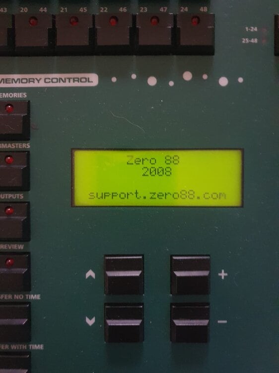

kgallen Posted May 4, 2023 Report Share Posted May 4, 2023 Looks better. Desk ID is invalid - start the console again and see if this disappears (console re-wrote the desk ID). Or some internal switches got moved? @KWR88 will know the answer. Keep posting info here, but @KWR88 said above to PM (private-message) him. You should be able to do that by clicking on his icon above or using the envelope icon at the top of the Forum. Quote Link to comment Share on other sites More sharing options...
Renato Posted May 4, 2023 Author Report Share Posted May 4, 2023 Reassigned S/N using SETDSKID.OSF from Keith. Installed OS by GOTEK Seems to work. Thank you bye 2 Quote Link to comment Share on other sites More sharing options...
