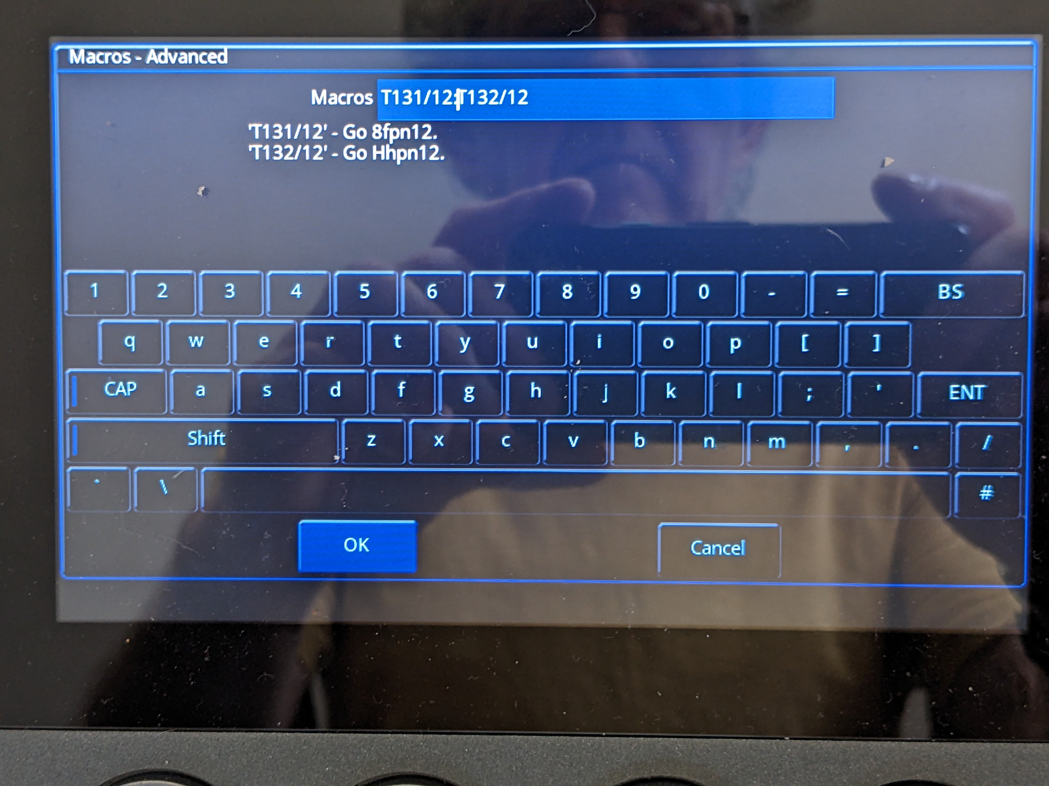

What's with the "8fpn12" and "Hhpn12" in the attached image?
I'm getting these (apparently) extraneous characters whenever I put a single or - as here - double cue-trigger in the macros field. The playback(s) & cue(s) do exist and they are named.

Good question. This is what I see when creating this macro...
If you click OK, and then click "Advanced" again, do you still see these erroneous values?
Would you be able to share a copy of your show file? I'll then investigate further.

I see them consistently although the actual characters vary. My showfile is a bit of a work in progress but based on one I've been using for a long time on this and my other desk and across more than one version of ZerOS. It has a lot (127) of cues triggering other cues or releasing playbacks. Not sure when it started or on which desk.
I'll try and send it tonight but before I do I'll do some checking on older versions, maybe even the other desk.

Edward has taken a look at this and it turns out it is confined to consoles (phantom ZerOS doesn't have the issue). It has been logged on the system to allow the software team to investigate. Initially, this is at a low priority which is fair enough as it doesn't cause any actual harm.
