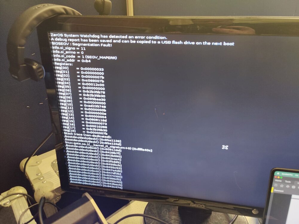

Primax98 Posted January 16, 2023 Report Share Posted January 16, 2023 Hi Guys, We are starting to have issues with our desk crashing and becoming unreliable. Typically these always seem to choose to crash during production time...... Desk is a Zero88 solution OS 7.10 Generic Microsoft Mouse and Dell keyboard. VGA Monitor no touch screen. ZerOS System WAtchdod has detected and error condition A debug report has been saves and can be cpoied to a USB flash drive on the next boot SIGSEGV : Segmentation Fault! info.si_signo = 11 info.si_errno = 0Info.si_code = 1 (SEGV_MAPERR) info.si_addr = 0xb4 Registers: reg[00] = 0x00000033 and there are more.......... Stack trace (non-dedicated): Bootdev/desk/desk() [0x85a1136] and more.... attached image if it helps too. Obviously were nervous about doing a further update. Any help appreciated. Thank you all. Quote Link to comment Share on other sites More sharing options...

iank99 Posted January 17, 2023 Report Share Posted January 17, 2023 It looks from your image that the desk might be moved around regularly? In which case I'd be tempted to open it and ensure the Compact Flash drive is seated properly on it's connector - there's no retaining clip on it & it's feasible that it might have worked slightly loose, a gentle push to reseat it might be enough... I'd also change the internal battery whilst you have the case open - just in case or if you haven't swapped the battery lately - it's a CR2032 so commonly available. It would also be worth trying a boot without the keyboard attached, they do go bad & it might be drawing too much current from the onboard USBHub (but to be honest - this is a rare error these days). Quote Ian Knight aka The Service Guy - www.serviceguy.co.uk Link to comment Share on other sites More sharing options...
Primax98 Posted January 17, 2023 Author Report Share Posted January 17, 2023 HI ian, thank you for the reply. i have just arrived on site.... Yes she is a busy girl indeed. we are on the road pretty much for the next 3 weeks from school to school so this could indeed be a possibility. I am awaiting my colleague to arrive before firing up the desk. I am pretty sure i replaced the bios battery last year, however you never know how good they are out of the packet so..... I will reply with any news. Thank you all indeed. Quote Link to comment Share on other sites More sharing options...
