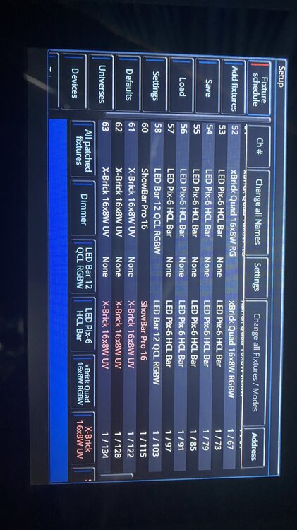

Hi - When I add a fixture into a cue - I build the cue state on the board, and press record, all the channels and fixtures are recorded execept a Stairville X-brick which immediately goes to zero...
tried various 'record next cue, record cue number x etc - behaviour is always the same - all fixtures record except this - which goes to zero.

I’ve also noted that the red text just means a custom fixture file.

We’ll there should be ‘nothing to know’ really - the fixture should just work for colour and intensity like any other. Sounds a bit like the fixture profile is wrong for the actual device, like the DMX channels are mixed up.
If you have the opportunity I’d patch a bunch of 1-channel dimmers from the base address of one of your x-Bricks and see what each channel does. List what you find here and with your show file Edward should be able to decode what the fixture profile says versus what you found from a channel-by-channel analysis.
