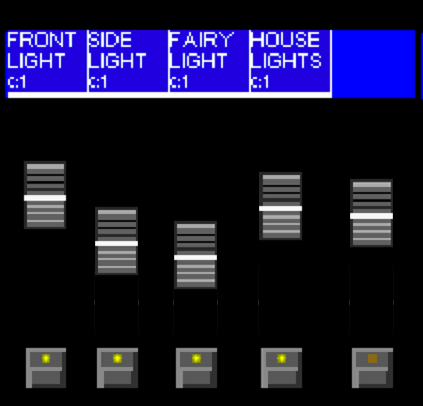

i don't like new "square" interface of submasters on monitor. This is not very informative for me. I am satisfied with the inline design of submasters.
In ZerOS 7.9 software, the "Submasters" window was replaced with the Faders window, graphically showing you what your playback faders are doing. No functionality was lost in this change.
37 minutes ago, Zebroid66 said:
It very cool to read the text on the submaster's display in capital letters. in the new version they are also not comfortable to read, because they are very small
In ZerOS 7.9 software and later, it is still possible to name playbacks in capitals if you wish...
