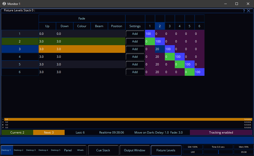

Ed75 Posted November 9, 2022 Author Report Posted November 9, 2022 2 minutes ago, Edward Z88 said: The Fixture Levels window can be used as a "track sheet", to allow you to edit cue values in spreadsheet form. This allows you to make a change to a value in a cue, and then decide whether to make the change cue-only or with tracking. Yes, I am aware of this, I just wondered if one could change values (of the same attribute) in more than one cue at once. I used to work with some lighting-sofware on a laptop which had this possibility in the "track sheet" . can be very convenient. If this is not possible I do not expect this to be changed, given the fact it is only an "outdated" Solution/Orb feature Quote Freelance Theatre Lighting designer/operator/allround technician/tech production/rental . Netherlands. FLX, FLX S48 2U, Solution, 13" multitouch monitor, 15" portable multitouch monitor, 11.4" lenovo thinkpad touch, network hub with wifi, powered usb hub, keyboard, trackball. 2x Elgato Streamdeck, nodes: showtec 2-3 and Lightshark node-4 2x 19" networkswitch, IOS zeros remote. 22" Iiyama.

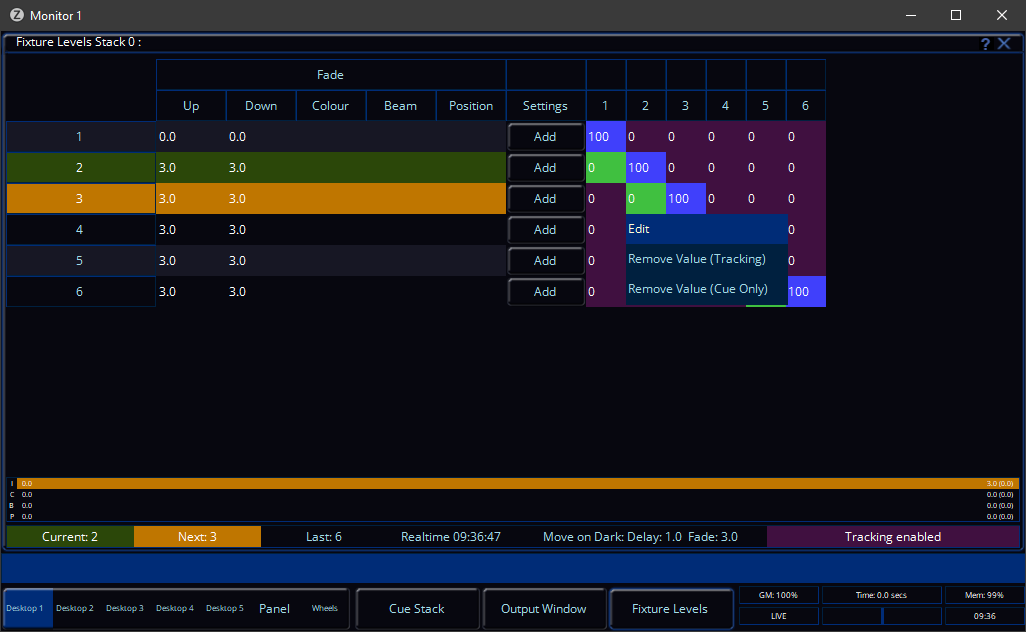

Edward Z88 Posted November 10, 2022 Report Posted November 10, 2022 Hi @Ed75 15 hours ago, Ed75 said: I just wondered if one could change values (of the same attribute) in more than one cue at once. By allowing that change to track, yes. In the example below, I have double-clicked on fixture 2's intensity value in cue 3, which is currently @ 0%... I am given the option to remove the value cue only, meaning the next cue's value stays as it is, or remove the value with tracking, meaning changes from previous cues can track through. I am also given the option to edit the value. In the example below, I have edited the intensity to 20%... This intensity change then tracks down through subsequent cues. This logic also applies to all other parameters that may have been recorded. Hope this helps, Edward Quote Edward Smith Formerly: Zero 88 Product Specialist - Email Support Currently: Obsidian Control Systems Product Specialist

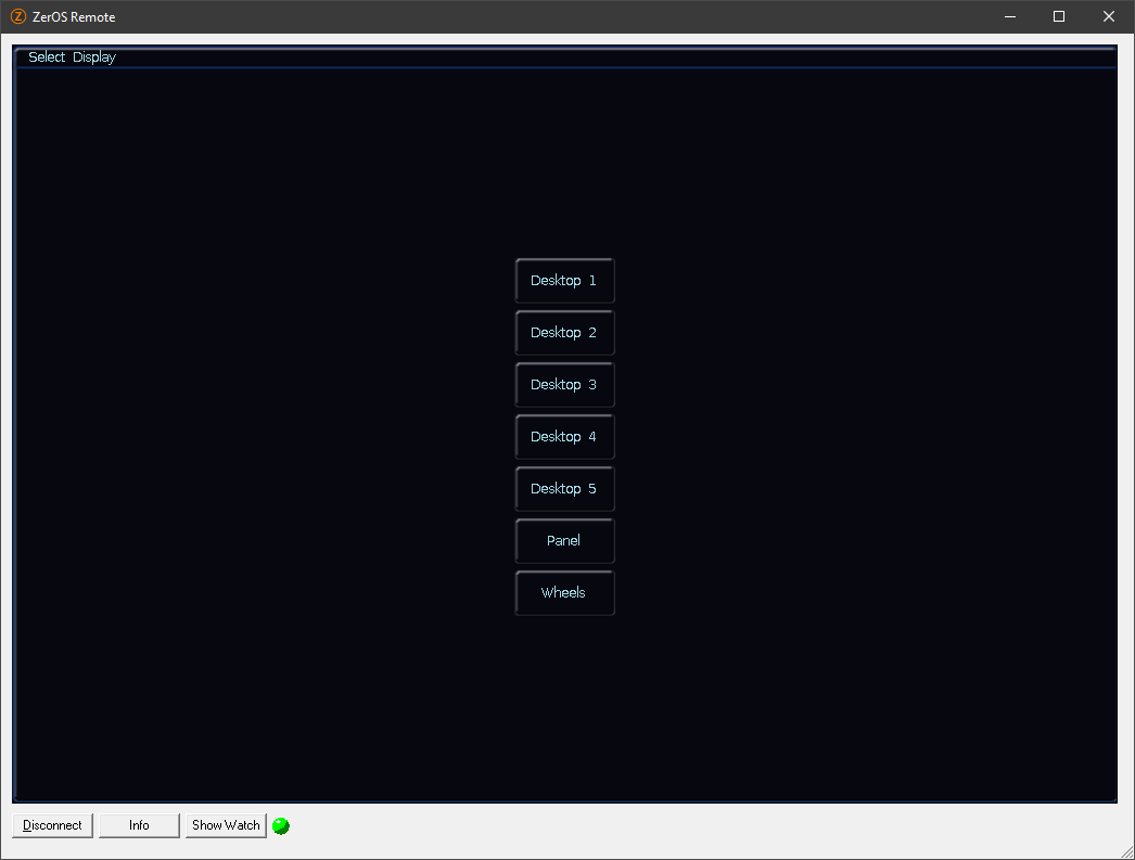

Ed75 Posted November 29, 2022 Author Report Posted November 29, 2022 Hi all, It seems Zeros monitor doesn't work on my Solution. I can connect to the desk, after that I get the black Zeros screen, but it doesn't give me the option menu which screen to show. Any idea's? Quote Freelance Theatre Lighting designer/operator/allround technician/tech production/rental . Netherlands. FLX, FLX S48 2U, Solution, 13" multitouch monitor, 15" portable multitouch monitor, 11.4" lenovo thinkpad touch, network hub with wifi, powered usb hub, keyboard, trackball. 2x Elgato Streamdeck, nodes: showtec 2-3 and Lightshark node-4 2x 19" networkswitch, IOS zeros remote. 22" Iiyama.

Edward Z88 Posted November 29, 2022 Report Posted November 29, 2022 Hi @Ed75 4 hours ago, Ed75 said: It seems Zeros monitor doesn't work on my Solution. I can connect to the desk, after that I get the black Zeros screen, but it doesn't give me the option menu which screen to show. Any idea's? Upon connecting ZerOS Monitor to your Solution, you should see the screen below... This allows you to choose which desktop to view. After choosing a desktop, you can then use the desktop switcher bottom-left of the screen to change desktop. Are you running ZerOS Monitor on Windows, iPadOS, or Android? Are you connecting to the console via Wi-Fi or Ethernet? If you are connecting wirelessly, does your device have strong signal? Let us know if you have any questions. Edward Quote Edward Smith Formerly: Zero 88 Product Specialist - Email Support Currently: Obsidian Control Systems Product Specialist
Ed75 Posted November 30, 2022 Author Report Posted November 30, 2022 21 hours ago, Ed75 said: after that I get the black Zeros screen, but it doesn't give me the option menu which screen to show. Any idea's? Hi Edward, I do not see these options. I connect via ethernet, on a windows 10 laptop. Which setup worked flawlessly with my FLXS . (before I installed the last version of Zeros monitor it did) I have to check if it still works now. I hope I have time for this today. Quote Freelance Theatre Lighting designer/operator/allround technician/tech production/rental . Netherlands. FLX, FLX S48 2U, Solution, 13" multitouch monitor, 15" portable multitouch monitor, 11.4" lenovo thinkpad touch, network hub with wifi, powered usb hub, keyboard, trackball. 2x Elgato Streamdeck, nodes: showtec 2-3 and Lightshark node-4 2x 19" networkswitch, IOS zeros remote. 22" Iiyama.
