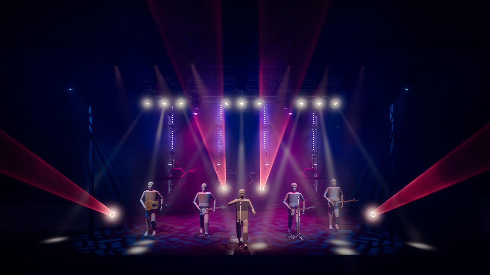

Edward Z88 Posted September 7, 2022 Report Posted September 7, 2022 Hi Kevin, On 9/7/2022 at 2:42 PM, kgallen said: Aside from using Dockhouse have you actually built your own stage and rigs in Capture (application possibly outside of Z88)? Expand Yes - for our recent Trade Shows, I have created a "Trailer Stage" visualisation project from scratch, which uses a fully VL rig... Edward 1 Quote Edward Smith Formerly: Zero 88 Product Specialist - Email Support Currently: Obsidian Control Systems Product Specialist
