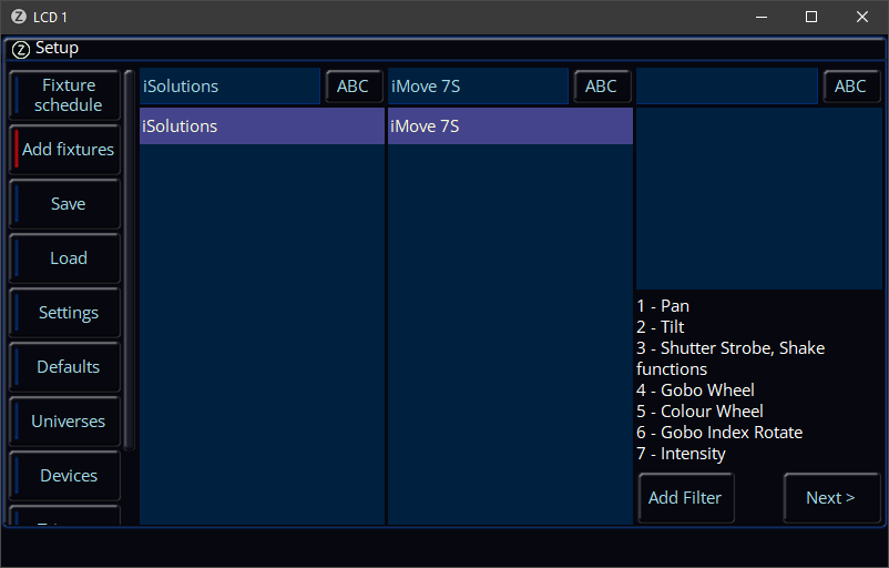

I've been trying to patch an isolutions imove 7s
The iSolutions iMove 7S is included in the latest ZerOS software for FLX S24 consoles...
If you cannot find this fixture in Add Fixtures, I'd recommend updating your console's software.
As this fixture doesn't have "modes", it should be as simple as adding the iMove 7S to your daisy chain, and assigning it a DMX address that matches the address patched in the console.
