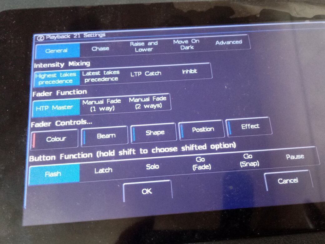

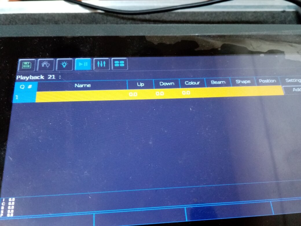

RichardNR3 Posted July 30, 2022 Report Posted July 30, 2022 What am I doing wrong? I have a LED which comes up on its default colour before going to the desired green. The same happens on other channels. I have tried deleting and recreating to no avail. Up, down and colour times are set to zero. What am I missing?
kgallen Posted July 30, 2022 Report Posted July 30, 2022 From your screenshots what I think is happening is the default trigger threshold is 5%. As you move up the fader the LEDs intensity raises but the colour trigger doesn’t happen until 5%. You should set the playback button to GO function (Setup+Playback) and press that button before raising the fader to ‘prep’ your LEDs. You could try reducing the trigger threshold and/or disabling release on lower if that would work in the context of your other playbacks. The latter could cause issues though if you want to overlay playbacks.

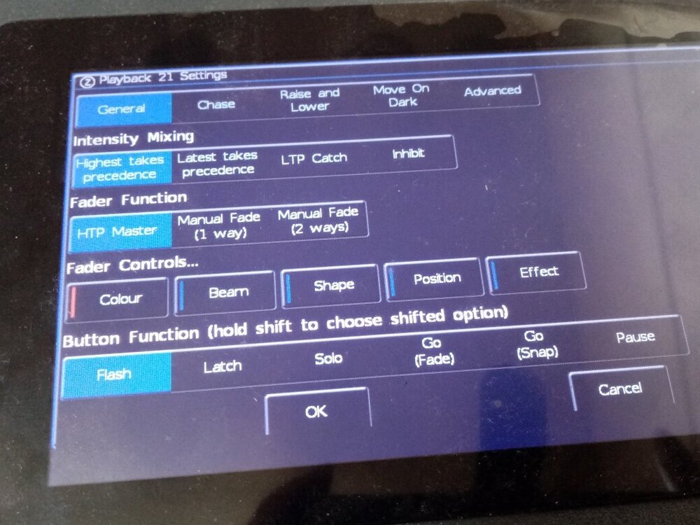

Edward Z88 Posted August 1, 2022 Report Posted August 1, 2022 Hi @RichardNR3 On 7/30/2022 at 5:54 PM, RichardNR3 said: I have a LED which comes up on its default colour before going to the desired green. The same happens on other channels. I have tried deleting and recreating to no avail. Up, down and colour times are set to zero. What am I missing? Thank you very much for attaching images of your playback. In Playback 21's settings, Fader Controls Colour has been enabled. Therefore, your playback is acting as a crossfader to transition your fixtures from their current colour, to their recorded colour. If they are in default, you therefore see a crossfade from default, which is white as standard, through to your recorded green. To avoid this behaviour, disable Fader Controls Colour, so that the Colour button in the Playback Settings has a blue rather than red stripe. The moment the playback is raised, the fixtures will then use the cue's colour fade times. Your cue colour fade time has been set to 0 seconds, and so your fixtures will snap to the recorded colour, allowing you to raise the fixture's intensity over the top using the playback's fader. See the link below for more information on Fader Controls... https://zero88.com/manuals/zeros/cues-playbacks/playback-settings/general#fadercontrols On 7/30/2022 at 8:33 PM, kgallen said: From your screenshots what I think is happening is the default trigger threshold is 5%. As you move up the fader the LEDs intensity raises but the colour trigger doesn’t happen until 5%. On 7/30/2022 at 8:33 PM, kgallen said: You could try reducing the trigger threshold and/or disabling release on lower if that would work in the context of your other playbacks. The latter could cause issues though if you want to overlay playbacks. The trigger level is used for all attributes, including intensity. Therefore if you have a fixture recorded @ full on a playback, you can raise the playback, and once you get to 5% travel, the fixture will go to 5%, and other attributes will go to their recorded values, all using the cue timings. It can be beneficial to reduce a playback's trigger level, particularly when controlling LED fixtures with poor dimmer curves. To adjust the trigger level hold SETUP and tap your playback's button. Choose Raise and Lower from the top, and then reduce the Trigger Level to 1% for example. See the link below for more information on the Trigger level... https://zero88.com/manuals/zeros/cues-playbacks/playback-settings/raise-and-lower#level I hope this helps. Let me know if you have any questions. Edward 1 Edward Smith Formerly: Zero 88 Product Specialist - Email Support Currently: Obsidian Control Systems Product Specialist
