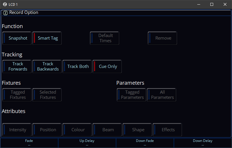

Edward Z88 Posted July 25, 2022 Report Share Posted July 25, 2022 Hi @Sven Nilsen 16 hours ago, Sven Nilsen said: Not able to use Fixtures - Parameters and Attributes when Record Option is selected (hold Rec) . Not sure , but it might have happened after installing 7.10 . Have done a Factory Reset . Are you seeing a Record Options window that looks like this... If so, this means your console is in global Cue Only mode, limiting the number of record options that are available to you. To access the normal Record Options, please ensure your Tracking Options are enabled in SETUP -> Settings -> Record & Update. 15 hours ago, Sven Nilsen said: Just loaded an old show , and everything is fine . But still dead when programming a new show . This setting is saved in the show file. Therefore it sounds like your older show file has the Tracking Options enabled. Please see the link below for more information... https://zero88.com/manuals/zeros/cues-playbacks/record-options/tracking#GlobalOptions I hope this helps. If you have any questions, please let me know. Edward Quote Edward Smith Product Specialist Email Support Link to comment Share on other sites More sharing options...
Sven Nilsen Posted July 25, 2022 Author Report Share Posted July 25, 2022 IMG_2404.jpeg-alias Tracking Options is Enabled . In Record Option : Function and Tracking are OK (red/blue) , but Fixture-Parameters and Attributes are frozen . Sven Quote Link to comment Share on other sites More sharing options...
Edward Z88 Posted July 25, 2022 Report Share Posted July 25, 2022 Hi Sven, 1 hour ago, Sven Nilsen said: In Record Option : Function and Tracking are OK (red/blue) , but Fixture-Parameters and Attributes are frozen . If "SmartTag" is enabled in the Record Options, indicated with a red stripe, the Fixtures, Parameters and Attributes options will be unavailable... This is because when SmartTag is enabled, the console decides what does and what doesn't get recorded, and so you won't have the options to choose. With SmartTag disabled, you get to decide what gets recorded, and therefore the Fixtures, Parameters and Attributes filters become available. The SmartTag state will be saved in the show file, and so if SmartTag was disabled and the show was saved, SmartTag will be disabled upon loading in that show file. See the link below for more information on SmartTag... https://zero88.com/manuals/zeros/cues-playbacks/record-options/snapshot-smarttag#smarttag I hope this helps. Edward Quote Edward Smith Product Specialist Email Support Link to comment Share on other sites More sharing options...
