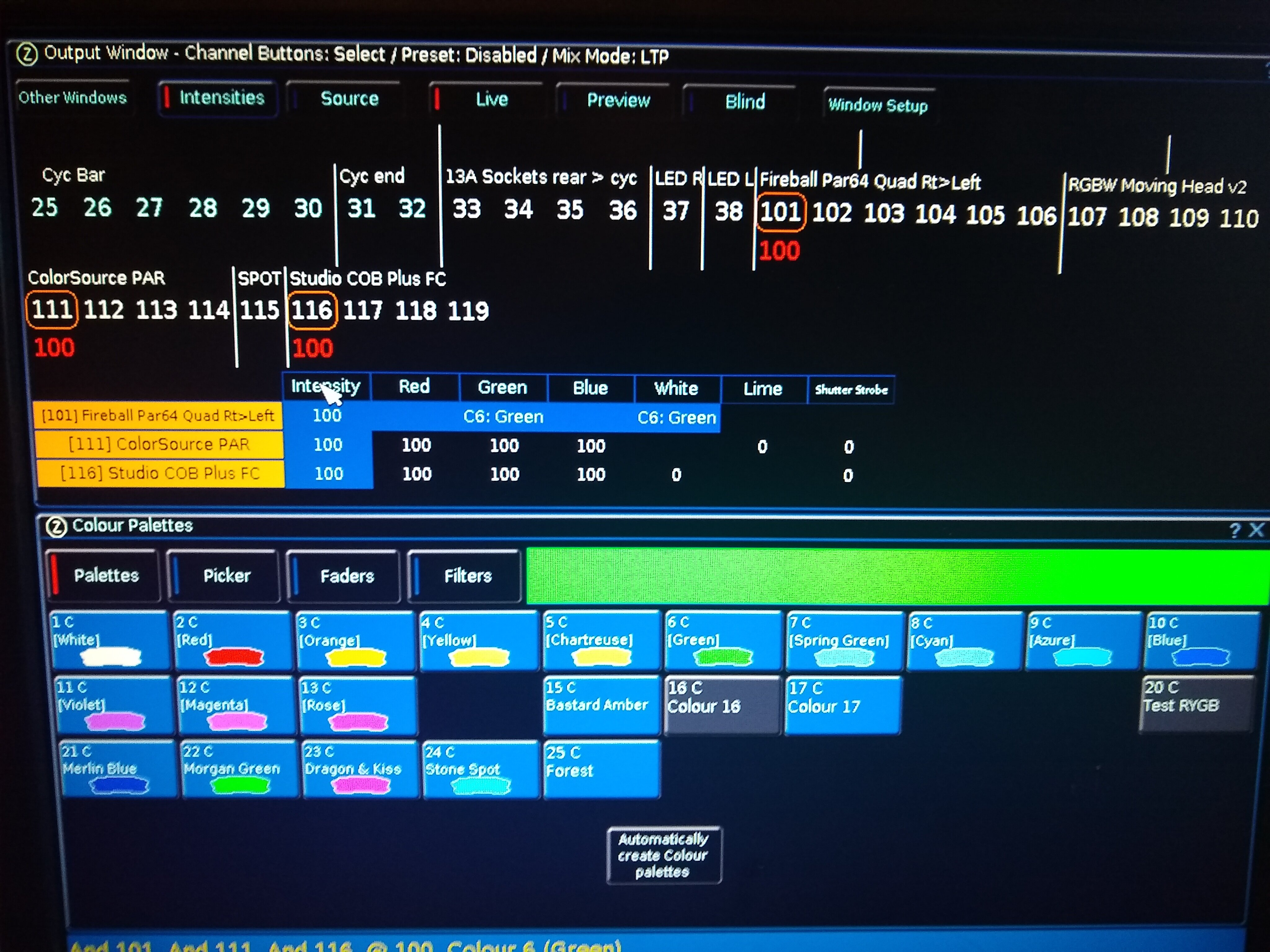

Patched some new fixtures into Solution desk (os 7.8.1.2).  ETC Colorsource PARs and Prolights StudioCob PlusFC using standard library. I can control intensity but colour selections having no effect on Output levels - stuck at RGB @100, W@0.
Any obvious troubleshooting?

How are you trying to adjust the fixture's colour? Do the colour encoder wheels give you control?
If it is just the automatic colour palettes that are not working, as @keredyelesob mentions, please try clicking "Automatically Create Colour Palettes", and try again.
