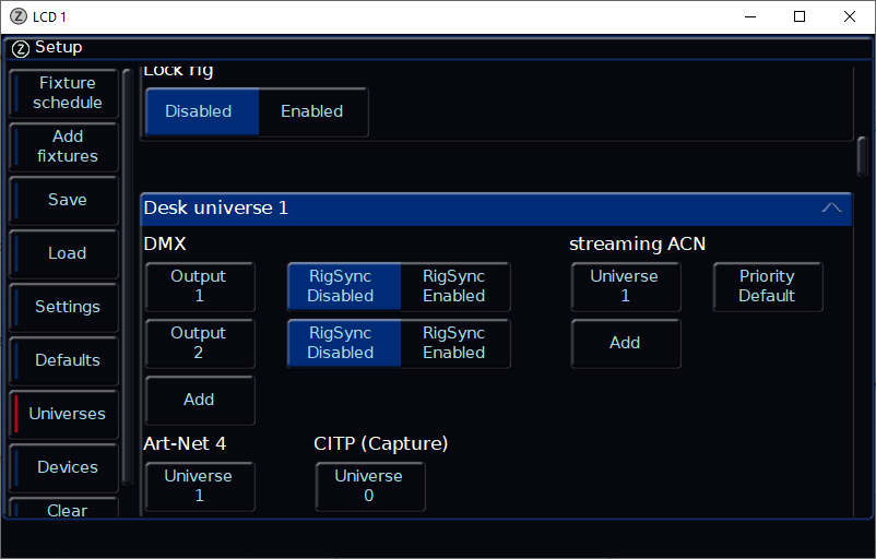

Could be the problem. May you suggest what I should do with the name? (See attachments)
DeskUniverseOutput_a.jpg - Settings
DeskUniverseOutput_b.jpg - After Add
DeskUniverseOutput_c.jpg - After click on Output
DeskUniverseOutput_d.jpg - After entering 2 as in your screenshot

As you have done enter the number2 and on the next screen select the "use on this desk universe instead" option. That should then give you the name Output 2 as per my original image.
