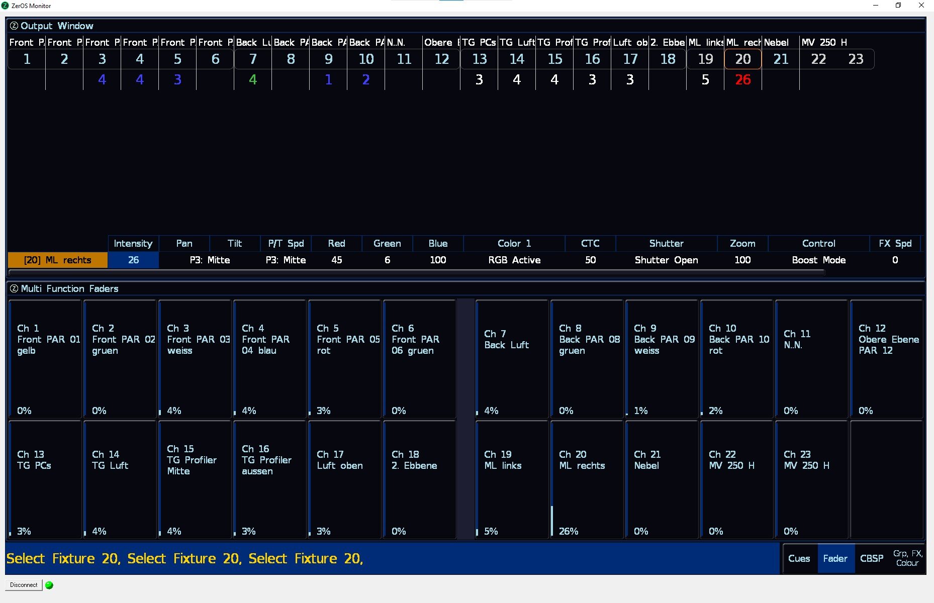

Holger Posted April 21, 2022 Report Posted April 21, 2022 Hi once more - just another question.... In an master playback I went through and there are intensities given in blue, red, white and red colors. Whats is the meaning? red - I suppose this is the manually changed value via the FLX S24. But the other colors? I even searched the German manual for "blau" (blue) but I couldn't find something.
Edward Z88 Posted April 21, 2022 Report Posted April 21, 2022 Hi Holger, Please see the link below for information on the Output window, including the different colour codes... https://zero88.com/manuals/print?manual=zeros&type=section&content=output-window Edward Edward Smith Formerly: Zero 88 Product Specialist - Email Support Currently: Obsidian Control Systems Product Specialist
Holger Posted April 21, 2022 Author Report Posted April 21, 2022 Thanks, but there is only the information that there are different colors but not their meaning. And - the link has a pdf which is mainly in English but some parts are in German....
Edward Z88 Posted April 21, 2022 Report Posted April 21, 2022 Hi Holger, 15 minutes ago, Holger said: Thanks, but there is only the information that there are different colors but not their meaning. And - the link has a pdf which is mainly in English but some parts are in German.... Please see the PDF attached... zeros-output-window.pdf Hope this helps. Edward Edward Smith Formerly: Zero 88 Product Specialist - Email Support Currently: Obsidian Control Systems Product Specialist
