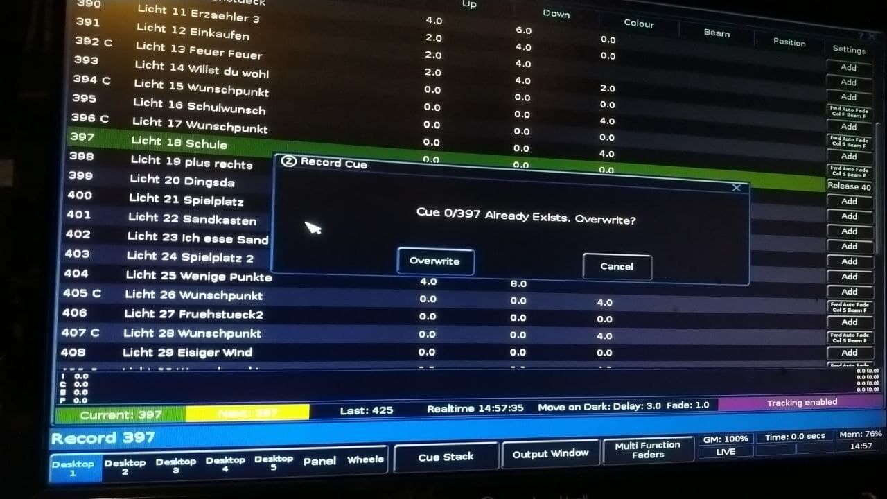

Here is also a picture of the popup, no options for chase or stack.
We are doing a workaround triggering a chase from a playback instead of programming it into the cuelist directly.
In ZerOS 7.9 and later, the ability to record multiple steps into a single cue was removed. Instead, you can now record multiple cues onto the "submaster" faders.
