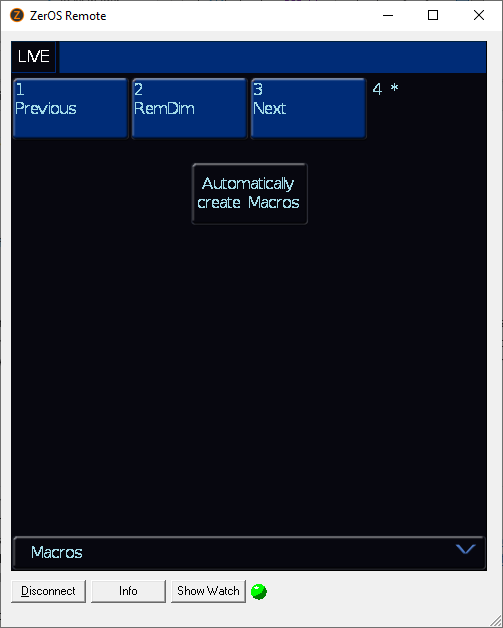

You could use Macros to achieve this via ZerOS Remote app. Add "RemDim" as a UDK, and then record a Macro of you recording that ("RECORD MACRO 2 ENTER {Commands}" - then press the UDK - then press MACRO to stop recording the Macro).
(Because you select "Commands" rather than "Keys", you can delete RemDim from the UDK after recording the Macro and the Macro will continue to work).
Next / Previous is holding SHIFT whilst pressing the left / right arrow keys. Again, you could record Macros of this, so you then have a screen on ZerOS Remote which looks like this:

Sorry Simon, that was a typo by me. I meant "Next / Previous is holding SHIFT whilst pressing the left / right arrow keys"... I've edited my origional post to avoid any future confusion!
