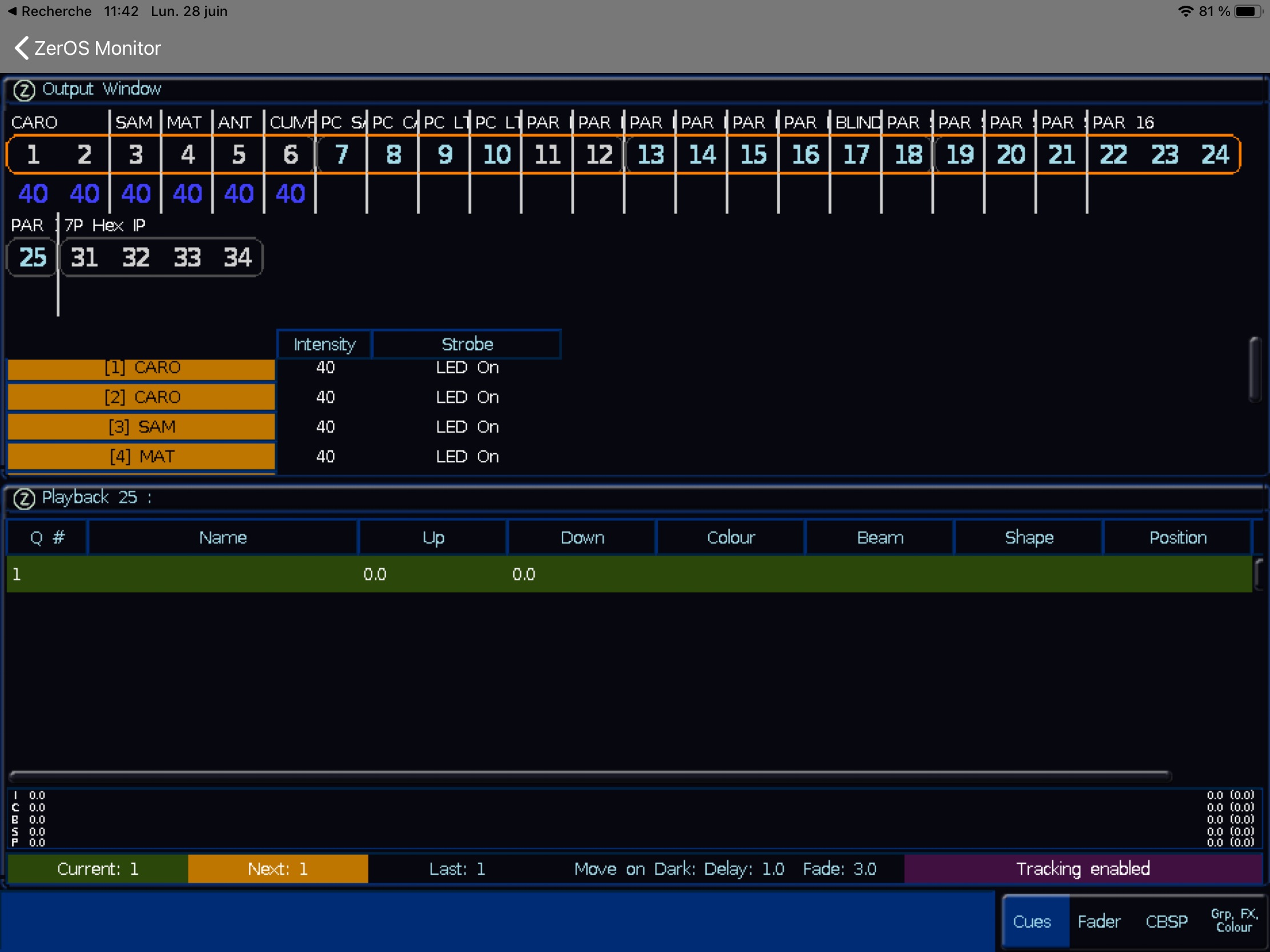

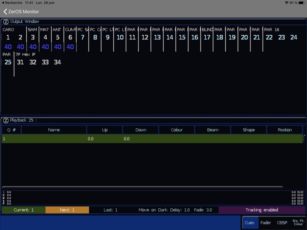

delfine Posted June 28, 2021 Author Report Share Posted June 28, 2021 1 hour ago, Jon Hole said: Hello, please could you send us some photos / screenshots of what you're seeing please? Bonjour, pourriez-vous nous envoyer des photos / captures d'écran de ce que vous voyez s'il vous plaît ? Oui. IMG 123 : Je suis sur mon playback 25, mes circuits ne sont pas sélectionnés, je vois le détail sous forme de ligne de l'activité de mes projecteurs. IMG 124 : Je suis toujours sur le même payback, je ne vois pas les lignes. J'ai eu l'occasion d'être dans une salle où l'on voyait les ligne dans les deux cas, sur l'écran externe. Ici, c'est la visualisation sur une tablette par Z Monitor. Merci Quote Link to comment Share on other sites More sharing options...
kgallen Posted June 28, 2021 Report Share Posted June 28, 2021 On the first image, fixtures 1-24 are selected in the programmer - see the orange box around them. Hence the fixture detail shown. In the second image, no fixtures are selected in the programmer. Quote Link to comment Share on other sites More sharing options...
delfine Posted June 28, 2021 Author Report Share Posted June 28, 2021 2 minutes ago, kgallen said: On the first image, fixtures 1-24 are selected in the programmer - see the orange box around them. Hence the fixture detail shown. In the second image, no fixtures are selected in the programmer. Yes I know, but in an external monitor we can see that even if the fixtures arn't selected ? No ? Quote Link to comment Share on other sites More sharing options...
kgallen Posted June 28, 2021 Report Share Posted June 28, 2021 5 minutes ago, delfine said: Yes I know, but in an external monitor we can see that even if the fixtures arn't selected? No? No. You only see the detail lines for fixtures selected in the programmer. And by "detail lines" I mean the lines in orange on the first image with "[1] CARO", "[2] CARO", "[3] SAM" and "[4] MAT" in them. If you're in the state of the first image, then click fixture buttons 1,2,3,4 you will see those "detail lines" disappear. Quote Link to comment Share on other sites More sharing options...
delfine Posted June 28, 2021 Author Report Share Posted June 28, 2021 1 minute ago, kgallen said: No. You only see the detail lines for fixtures selected in the programmer. And by "detail lines" I mean the lines in orange on the first image with "CARO", "SAM" and "MAT" in them. Oh ok. So it's normal. Thanks. Do we see the same in a external monitor or a Ipad with Z monitor ? Quote Link to comment Share on other sites More sharing options...
kgallen Posted June 28, 2021 Report Share Posted June 28, 2021 1 minute ago, delfine said: Oh ok. So it's normal. Thanks. Do we see the same in a external monitor or a Ipad with Z monitor? External monitor is the same as the internal touchscreen. You are using FLX S48? I don't know about Z monitor (I don't use it), sorry! Quote Link to comment Share on other sites More sharing options...
Jon Hole Posted June 28, 2021 Report Share Posted June 28, 2021 1 hour ago, kgallen said: You only see the detail lines for fixtures selected in the programmer. You'll see selected fixtures AND any fixtures with information in the programmer... so if you select Fixture 1, change it's colour, deselect Fixture 1, you'll still see the fixture's details in the Output Window because the colour infromation is in the programmer. However, when you then Record that to a cue, the information is transfered from the Programmer to the Cue, so you'd no longer see that fixture (this is assuming "Smart Tag" isn't enabled. If it is enabled, you'd need to clear the programmer). 57 minutes ago, delfine said: Oh ok. So it's normal. Thanks. Do we see the same in a external monitor or a Ipad with Z monitor ? External Monitor and Z Monitor should show you the same thing. 56 minutes ago, kgallen said: External monitor is the same as the internal touchscreen. You are using FLX S48? Not quite, the Internal Touchscreen doesn't show you the Fixture Details of fixtures that are selected or in the programmer, only the external screen & Z Monitor shows you that. Quote Link to comment Share on other sites More sharing options...
delfine Posted June 28, 2021 Author Report Share Posted June 28, 2021 5 hours ago, Jon Hole said: You'll see selected fixtures AND any fixtures with information in the programmer... so if you select Fixture 1, change it's colour, deselect Fixture 1, you'll still see the fixture's details in the Output Window because the colour infromation is in the programmer. However, when you then Record that to a cue, the information is transfered from the Programmer to the Cue, so you'd no longer see that fixture (this is assuming "Smart Tag" isn't enabled. If it is enabled, you'd need to clear the programmer). External Monitor and Z Monitor should show you the same thing. Not quite, the Internal Touchscreen doesn't show you the Fixture Details of fixtures that are selected or in the programmer, only the external screen & Z Monitor shows you that. Yes, it's clear ! Thanks a lot Quote Link to comment Share on other sites More sharing options...
