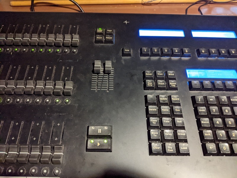

Nathan Bell Posted June 8, 2021 Author Report Posted June 8, 2021 Are you referring to these two faders in the center of the board? They are both all the way up. I tried all possible combinations of them being up or down, and cues did not fade. All cues snapped at 0 sec.
Nathan Bell Posted June 8, 2021 Author Report Posted June 8, 2021 Update - I re-read your explanation and put it at 50%. That did the trick. Thanks for your help with this issue.
Edward Z88 Posted June 8, 2021 Report Posted June 8, 2021 Hi Nathan, 1 minute ago, Nathan Bell said: Update - I re-read your explanation and put it at 50%. That did the trick. Thanks for your help with this issue. No problem at all, glad that solved the issue. We have received your email to support, and will advise on the procedure to get the battery replaced. If you have any questions let us know. Edward Edward Smith Formerly: Zero 88 Product Specialist - Email Support Currently: Obsidian Control Systems Product Specialist
