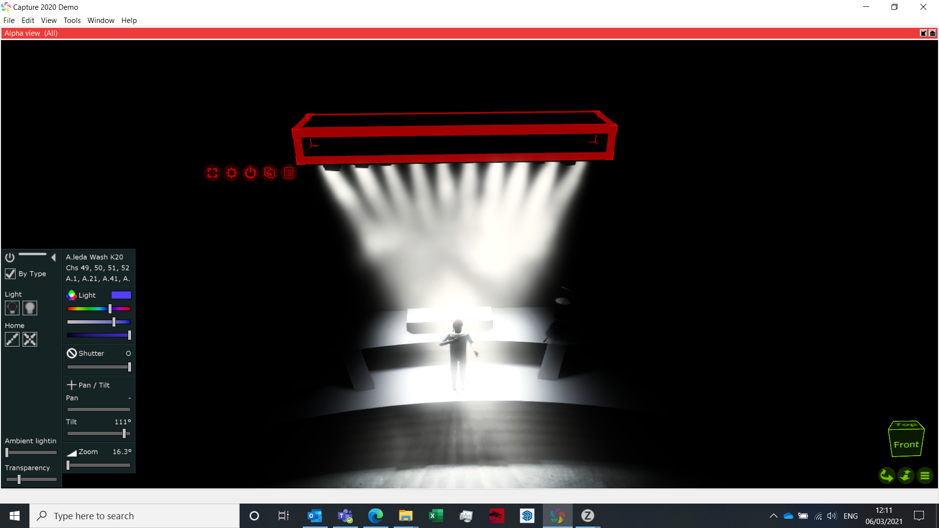

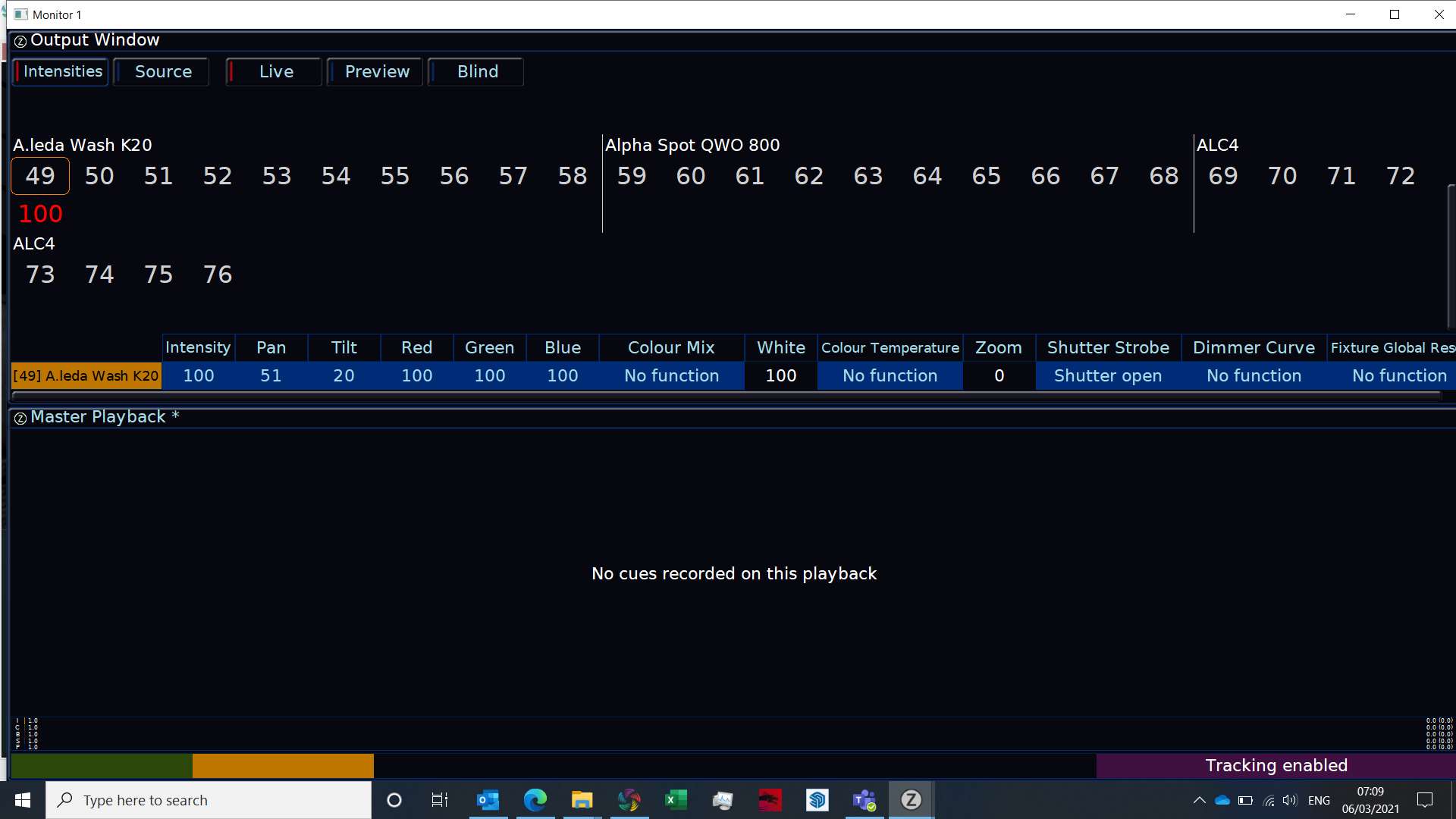

Ok, I've got the correct files loaded now thanks but the focus method doesn't work still and the fixture info doesn't match. This is the same problem I'm having with my show file.

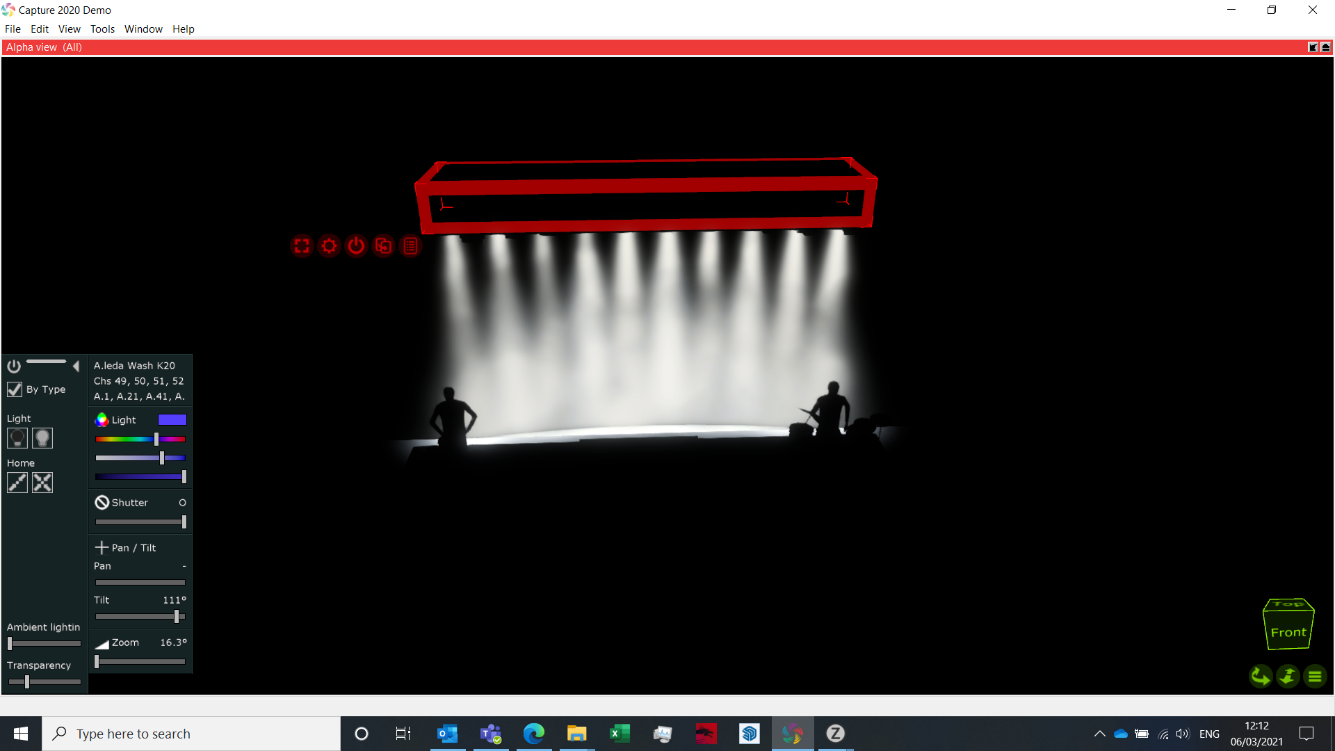

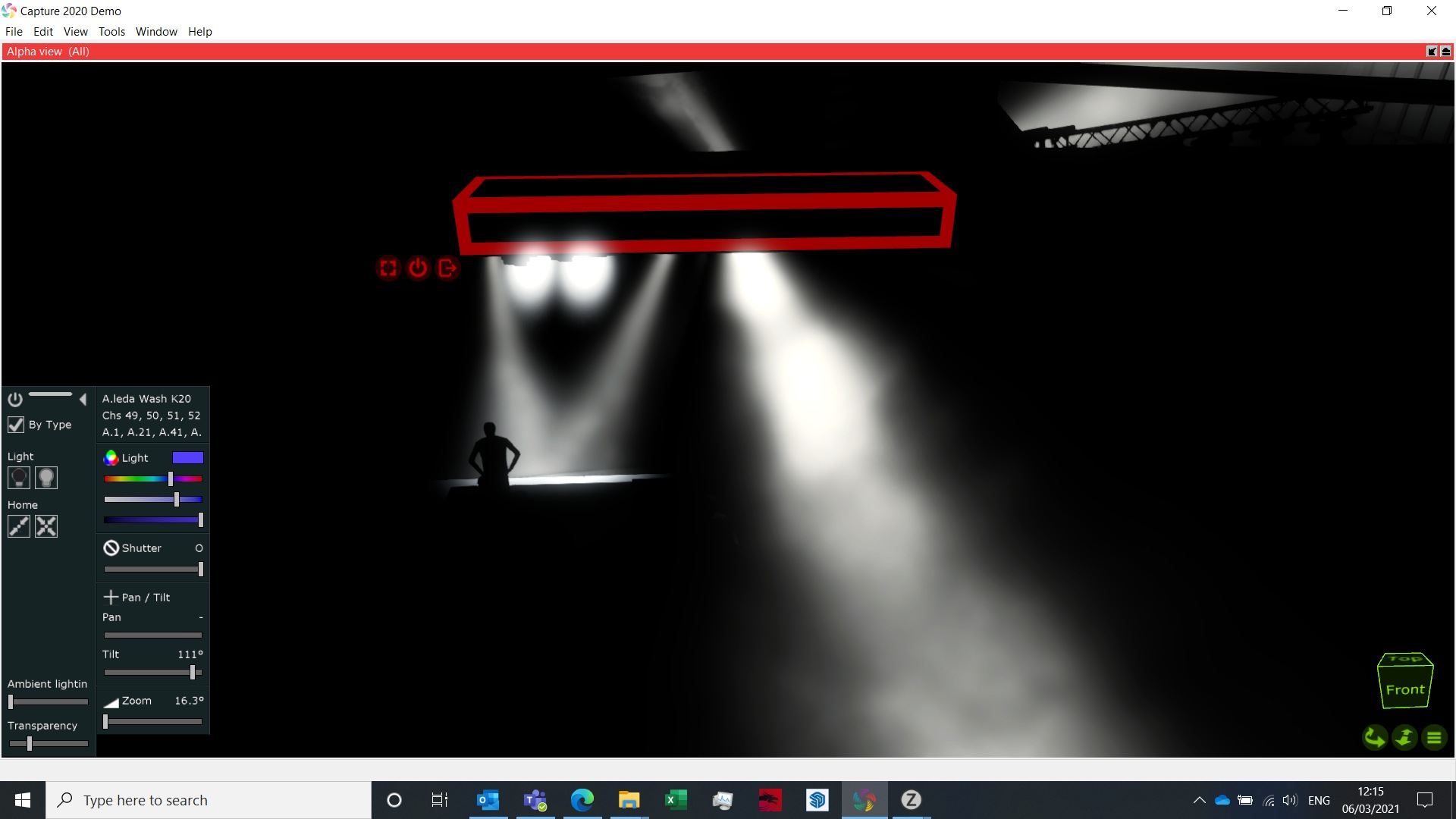

I've just loaded the same files onto my old laptop that is running a registered version of capture and the same thing happens. Another strange thing is that if I click the focus in the same place multiple times the light never goes to the same place and the pan tilt details in the capture panel never changes.
2092582038_2021-03-06(1).thumb.png.642e23c0ac934809328db73ab6290589.png2021-03-06.thumb.png.14b3b9d7542869132cbb5eb9ae42c610.png

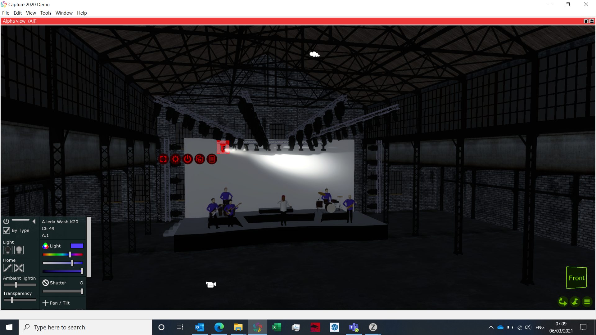

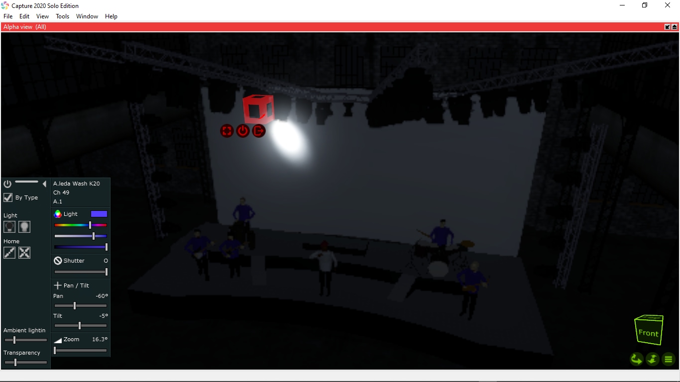

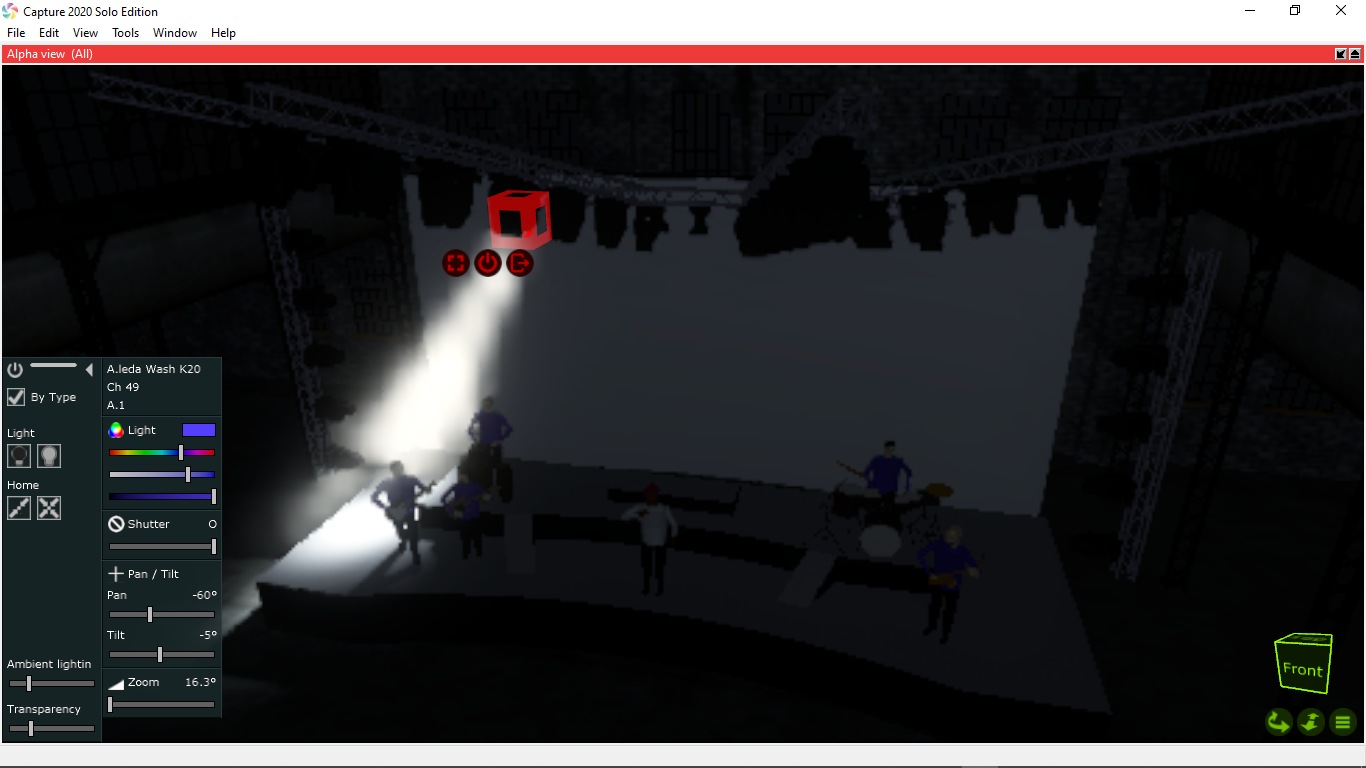

Hi Edward, I'm running the latest phantom download for these tests. I had the same experience on the flx yesterday at work.
I've rechecked the patch and all seems ok, so not sure what I was looking at before.
All the controls from the flx work as they should and the outputs look correct, it's the controls within capture that don't correspond or change regardless of light position.
382120719_Screenshot(10).thumb.png.68fe1555041e35f01b92561fe27fbcd8.png890364952_Screenshot(11).thumb.png.9323f631c12b487fbcd3c2c6ade91b1c.png
If I try to use the focus position in capture as you showed us the lights just point in random directions
This was the result of a single mouse click with the focus tool. You can also see that according to capture the light should be blue even though flx is outputting white.
It all returns to normal once phantom/flx is disconnected.

Hi Simon,
Thanks very much for the information and images. From the description, I think you may have come across an issue we are aware of in ZerOS 7.9.9.
I’m not in front of my laptop today, however I will drop you an email on Monday.
If you have any questions let me know.
Edward
