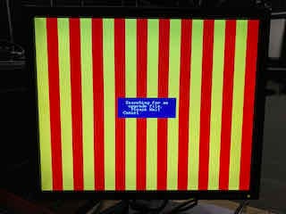

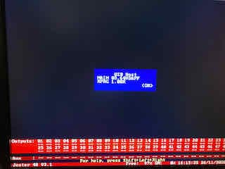

Jmax Posted November 26, 2020 Author Report Posted November 26, 2020 29 minutes ago, Edward- Z88 said: Hello, Welcome to the Zero 88 Forum. JesterOS 4.1 can be downloaded here... https://zero88.com/storage/downloads/248ce535-0aef-40ac-89a6-88e34e4f2cf1/Jester41.zip Once downloaded, extract the file to the root of a USB stick, and plug into the Jester. Then boot the Jester with the left and right arrow keys held down. If the Jester cannot detect the USB stick, turn the Jester off, and remove the USB stick. Then turn the Jester on, and go into Super User (SHIFT + MODE). Then arrow down to <USB Host>. Hold SHIFT and press ENTER, and you should see the option to choose <Upgrade>. Press this, and run the upgrade. If you have any questions please let us know. Edward Thanks for the reply. When I boot it with the arrows held down it goes into the update mode but it keeps saying "Searching for an upgrade file, Please Wait". I left it for 20mins before cancelling it as it didn't seem to find the update file. the usb has a light that was just solid red the entire time if that gives any info. When I go into the usb host mode option it doesn't come up with a upgrade option it just shows some text which I guess is some version info. I have included photos to see if that gives you any help. Josh Quote
Edward Z88 Posted November 26, 2020 Report Posted November 26, 2020 Hi Josh, Thanks for the photos. 14 minutes ago, Jmax said: When I go into the usb host mode option it doesn't come up with a upgrade option it just shows some text which I guess is some version info. When you chose <USB Host>, did you have Shift held down? 56 minutes ago, Edward- Z88 said: Then arrow down to <USB Host>. Hold SHIFT and press ENTER, and you should see the option to choose <Upgrade>. If you have any questions let me know. Edward Quote Edward Smith Formerly: Zero 88 Product Specialist - Email Support Currently: Obsidian Control Systems Product Specialist
Jmax Posted November 26, 2020 Author Report Posted November 26, 2020 Hi Edward 6 minutes ago, Edward- Z88 said: When you chose <USB Host>, did you have Shift held down? Yes I did have the shift button held down when I pressed enter. I have tried restarting it several times to see if that helps but it made no change. Josh Quote

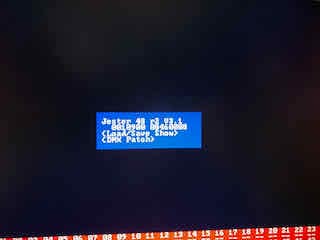

Edward Z88 Posted November 26, 2020 Report Posted November 26, 2020 Hi Josh, 31 minutes ago, Jmax said: Yes I did have the shift button held down when I pressed enter. I have tried restarting it several times to see if that helps but it made no change. Thanks for confirming. Please email us a picture of the console's serial number to support@zero88.com, displayed at the top of the LCD when you open Super User, and we will be able to advise the next step. If you are able to, it would also be worth copying the Jester4.1 software onto a different USB stick if you have one to hand, and try booting the console with the left and right arrow keys held down again. If you have any questions let me know. Edward Quote Edward Smith Formerly: Zero 88 Product Specialist - Email Support Currently: Obsidian Control Systems Product Specialist
