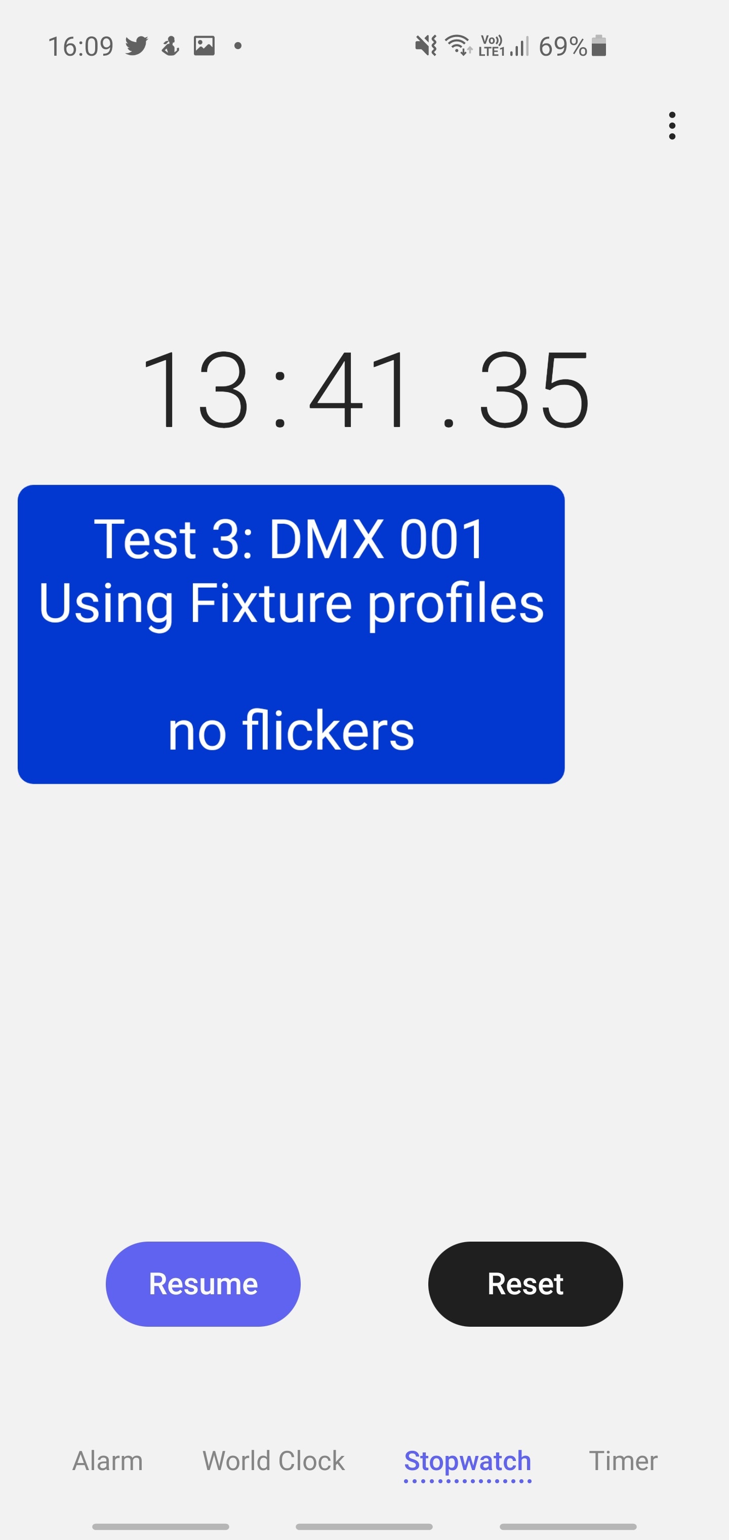

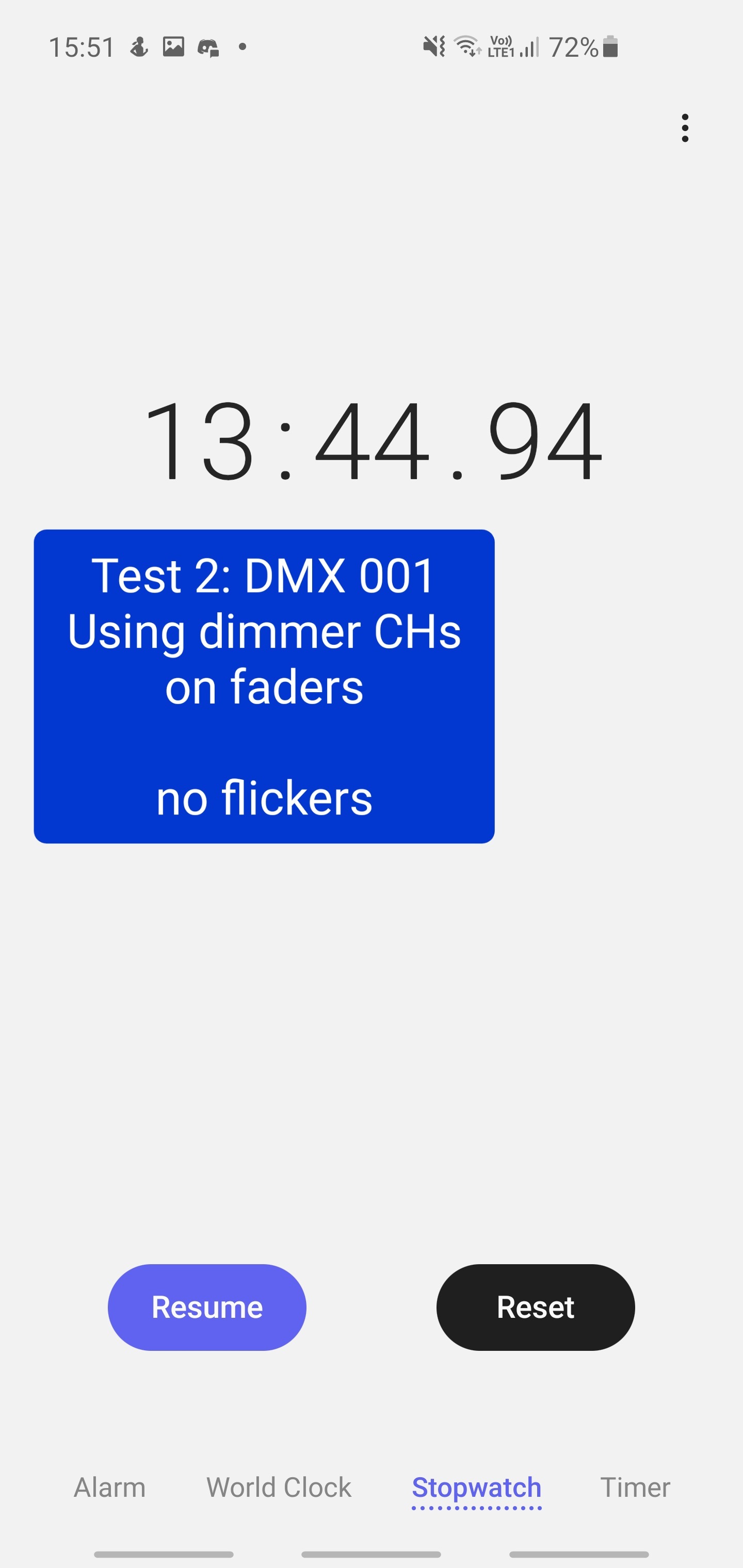

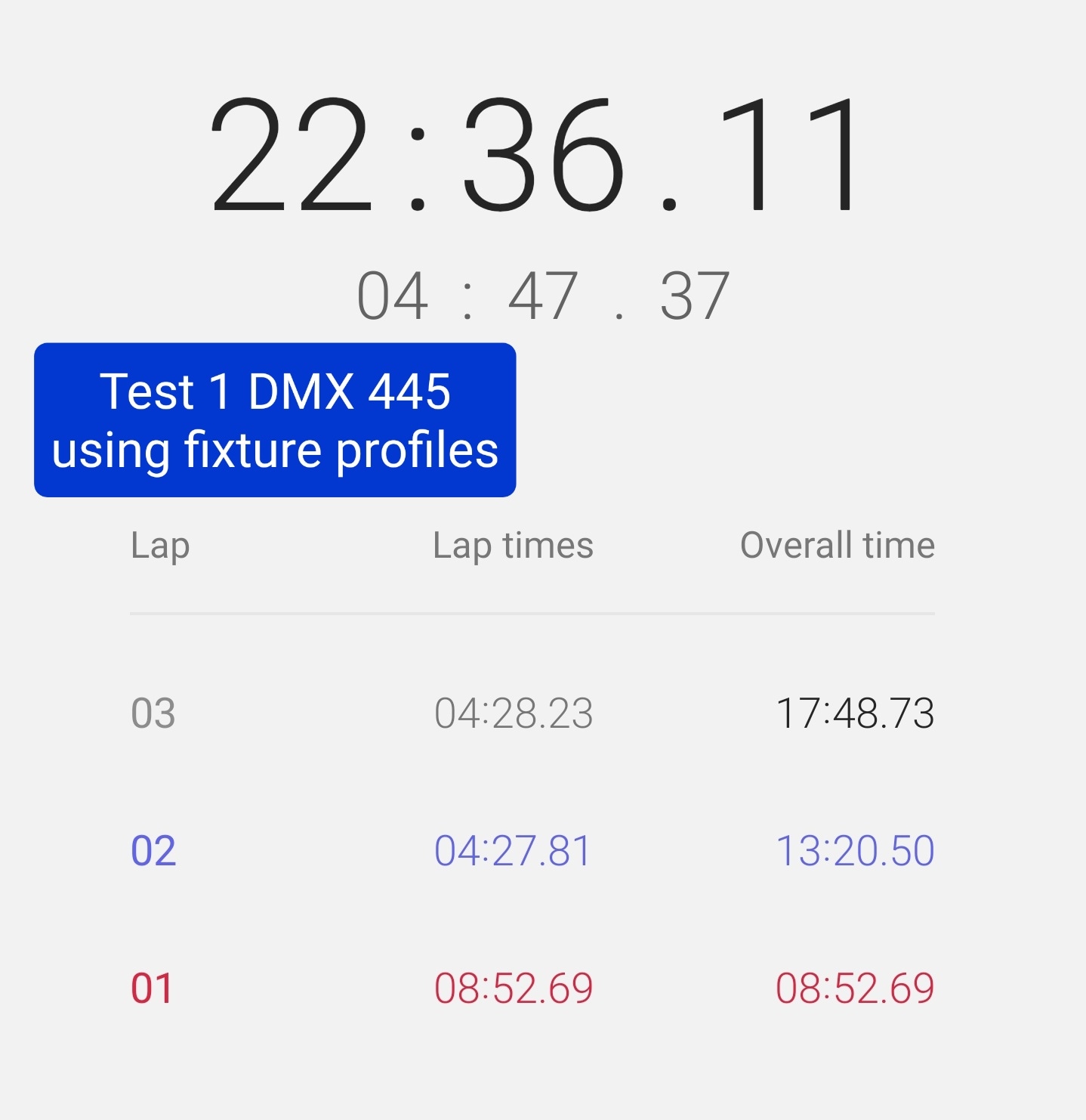

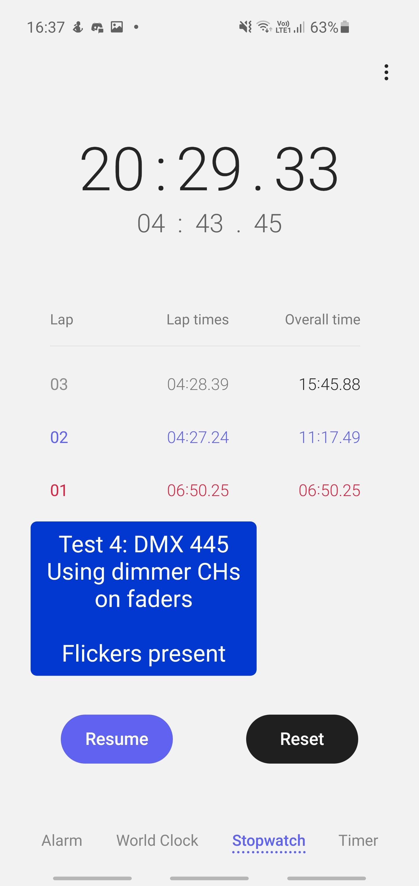

Gingersteve91 Posted October 20, 2020 Author Report Share Posted October 20, 2020 On 10/14/2020 at 9:34 AM, Edward- Z88 said: If you'd like to give me a call when you're in the venue troubleshooting it, drop me an email and I'll send you my number. Edward Hi Edward, Thanks for the response, So we re-rigged the cloth to do some more testing and found it seems to be nothing to do with the control. We did find however the issue only seems to occur in the higher DMX ranges. I ran 4 tests for the product 2 using the Fixture profiles mentioned at DMX 001 & 445. Then 2 More using dimmer CHs on faders only at DMX 001 & 445 The results were consistent showing flicker breaks at around 4:27-4:29 intervals on the 400 range meanwhile using the cloth at 001 there was no issue at all (See timed results attached). This proved to be the same running through a Zero88 Line backer to so the desk has definitely been ruled out as the issue. Do you or anyone here have any knowledge as to what could be causing this when used at a high universe range, Me & my colleagues are all out of ideas now, so any suggestions would be appreciated. Thanks, Steve. Quote Link to comment Share on other sites More sharing options...
Edward Z88 Posted October 20, 2020 Report Share Posted October 20, 2020 Hi Steve, 1 hour ago, Gingersteve91 said: ran 4 tests for the product 2 using the Fixture profiles mentioned at DMX 001 & 445. Then 2 More using dimmer CHs on faders only at DMX 001 & 445 The results were consistent showing flicker breaks at around 4:27-4:29 intervals on the 400 range meanwhile using the cloth at 001 there was no issue at all (See timed results attached). This proved to be the same running through a Zero88 Line backer to so the desk has definitely been ruled out as the issue. That is really interesting, thanks very much for the information and attaching the results of your testing. 1 hour ago, Gingersteve91 said: Do you or anyone here have any knowledge as to what could be causing this when used at a high universe range, Me & my colleagues are all out of ideas now, so any suggestions would be appreciated. This definitely sounds like a question for the manufacturer of the star cloth drivers. Is there a firmware update for these you can perform? The only thing I can potentially think of, is that maybe the refresh rate of the ORB XF is too high for the cloth drivers, despite the refresh rate being pretty much slap bang in the middle of the permitted range. Unfortunately on ORB XF you cannot change the refresh rate, and so the work around is likely just to address the star cloth drivers to address 255 or lower. I hope this helps, if you have any questions let us know. Edward Quote Edward Smith Product Specialist Link to comment Share on other sites More sharing options...
