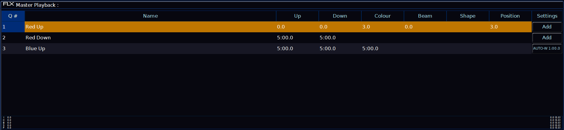

kgallen Posted October 5, 2020 Report Posted October 5, 2020 10 minutes ago, Jason Brameld said: 4. <AUTO 1 min after start of Q3>, start a 5 minute fade in of blues on the same fixtures as the reds (accepting that this will pass through various lovely shades of purple on the way (now I'm stuck.....red fade would then finish 1 min before the blues did). Q: So on the last part your timeline mismatch by 1 minute as you say. In what way were you wanting to make them align? If you wanted to keep the red and blue independent, then on your red fade out you would only tag the red colour and for the blue fade up only tag the blue colour. I believe this would require the desk to be set "keep parameters separate" for colour (that's probably the default). In both cues the intensity is retained at 100% so the fading of the colours is via the colour channel not the intensity channel. 1. I've probably misunderstood your requirements! 2. Yes I'd struggle to do this too! 3. Edward will give us the proper recipe in a minute!

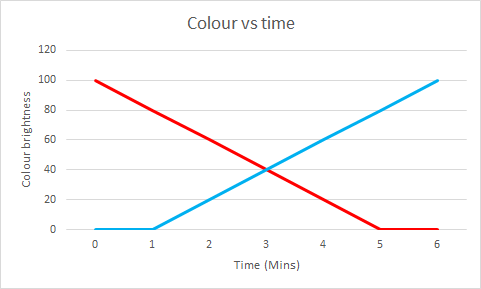

Jason Brameld Posted October 5, 2020 Author Report Posted October 5, 2020 54 minutes ago, kgallen said: Q: So on the last part your timeline mismatch by 1 minute as you say. In what way were you wanting to make them align? That's part of the problem - they don't time align - it's a 5 minute fade out of the reds, a 5 minute fade in of the blues, and a minute gap between the starts of the 5-minute fades. so: At time T+0: Start 5 minute fade down of reds @T+1 min - start 5 minute fade up of blues @T+5 mins - red fade out complete @T+6 mins - Blue fade in complete This was the subject of much confusion as it was being asked for by the designer (who wasn't very good at explaining things) as well!! Jason.

Jason Brameld Posted October 5, 2020 Author Report Posted October 5, 2020 Hi Ed, Your summary of the problem about separate PARS but in the same fixture is spot on! This is what we want to achieve: I think your first example is closer to the mark. - I may give this a try as an exercise So in your cue 2 - that is the fixture intensity at zero and the red colour remaining at 100% (G and B at 0) In your cue 3, fixture intensity 100%, R and G at 0, B at 100% So the question in my head on this one is would the colour crossafade in Q3 effectively slow down the red fade out in Q2, as the red fade down should be competed 5 minutes after the GO on cue 2, and not at the end of the 5 minute colour crossfade started when Q3 starts (If that makes sense?!) Also if you have the intensity dip and the colour crossfade do you end up with the brightness dropping more in the middle doing it this way? I'll have to go and play tonight now to satisfy my curiousity! Jason.

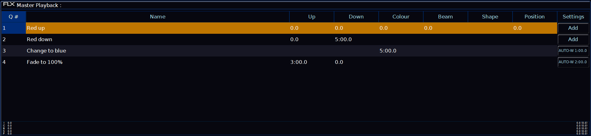

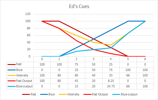

Edward Z88 Posted October 5, 2020 Report Posted October 5, 2020 Hi Jason, 39 minutes ago, Jason Brameld said: This is what we want to achieve: Thanks for the graph, that is great! Bet you wish your designer could have shown you that at the start! In that case, we'll be looking at this... In cue 1, your red lights are up. In cue 2, your red lights are fading down to 0% over 5 minutes. No colour information included, therefore no colour times are shown. [Minute 0 in your graph] In cue 3, your lights then begin the 5 minute cross fade from red to blue, which begins 1 minute after the reds started fading. There is no intensity information included, therefore no fade up/down times shown. [Minute 1 in your graph]. In cue 4, your lights then begin to fade back up to full over 3 minutes, 2 minutes after they started to change to blue. There is no colour information included, therefore no colour fades are shown. [Minute 3 in your graph]. Result once cue 4 has completed - red to blue fade ends at the same time as blue hitting 100%. [Minute 6 in your graph]. 39 minutes ago, Jason Brameld said: Also if you have the intensity dip and the colour crossfade do you end up with the brightness dropping more in the middle doing it this way? In theory the intensity of the colour will remain the same (assuming the red and blue LEDs are equally intense, which is unlikely), as you will go from one LED colour at full, to both LED colours at half (equaling the same intensity as one LED colour at full), to the other LED colour at full. In your graph though of course, you are dipping to 40% of the overall intensity mid fade. Hope this helps, Edward Edward Smith Formerly: Zero 88 Product Specialist - Email Support Currently: Obsidian Control Systems Product Specialist
Jason Brameld Posted October 5, 2020 Author Report Posted October 5, 2020 Ah - but the red fade out should finish at minute 5, and not minute 6.....leaving the blues to continue from 80% to 100% in the last minute. The actual time they spend cross-fading is only 4 minutes - in the first minute at the beginning only the red is coming down and in the last minute at the end only the blue is going up. Good brain teaser huh?
Edward Z88 Posted October 5, 2020 Report Posted October 5, 2020 Hi Jason, 32 minutes ago, Jason Brameld said: Ah - but the red fade out should finish at minute 5, and not minute 6.....leaving the blues to continue from 80% to 100% in the last minute. Good brain teaser huh? The intensity of red, as shown in your graph, will have completed its fade to 0 at minute 5. This is true of cue 2 in my image above, due to the 5 minute fade down. Red fading down between minute 3 and 5 is theoretical in this instance, as the intensity will have begun to rise again at minute 3 (cue 4 starts). However when red is at "0", there is still a minute of colour mixing left to complete, due to the 5 minute colour fade in my cue 2. If the colour needs to be full blue at minute 5, then simply change the colour fade in my cue 3 from 5 minutes, to 4 minutes. As cue 4 is set to "Auto With", not "Auto After", changing the timings of cue 3 will not affect cue 4. This would then give in my example: In cue 1, your red lights are up. In cue 2, your red lights are fading down to 0% over 5 minutes. No colour information included, therefore no colour times are shown. [Minute 0 in your graph] In cue 3, your lights then begin the 4 minute cross fade from red to blue, which begins 1 minute after the reds started fading. There is no intensity information included, therefore no fade up/down times shown. [Minute 1 in your graph]. In cue 4, your lights then begin to fade back up to full over 3 minutes, 2 minutes after they started to change to blue. This starts when they are magenta - 50% red and 50% blue, mid colour cross fade. There is no colour information included, therefore no colour fades are shown. [Minute 3 in your graph]. Result once cue 4 has completed - a minute after completing the fade to blue, the fixtures hits 100%. [Minute 6 in your graph]. Hope this helps, Edward Edward Smith Formerly: Zero 88 Product Specialist - Email Support Currently: Obsidian Control Systems Product Specialist

Edward Z88 Posted October 5, 2020 Report Posted October 5, 2020 Hi Jason, 29 minutes ago, Jason Brameld said: Given that we seem to need 3 cues to do this by your way or mine, Yes 3 cues is easiest here, as we turn lights off, change their colour, then turn them on again. You could probably get rid of “Cue 3” in my latest example, and also have the colour change from red to blue in cue 2, with colour having a 4 minute fade, and a 1 minute delay. My cue 4, would then need an Auto With wait time of 3 minutes. In many ways though, it is easier separating it out into separate cues for each part. 6 hours ago, Jason Brameld said: <GO> Start with general FOH wash (tungsten) <GO> Add in red from side LED fixtures on a 5 minute fade up time <GO> Start a 1 minute colour fade of the red leds to 80% of full value (lose 1/5 of value in 1/5 of the fade time) <AUTO after end of Q3>Start a 4 minute colour crossfade to take reds out and bring blues to 80% of full value (bring in 4/5 of blues in 4/5 of the time - take out remaining 4/5 of reds) <AUTO after end of Q4) Start a 1 minute colour fade of blues from 80% to 100% of full value Leaving fixture intensity at fixed level through Q3-5. This works, however the fixtures will be halted at 80% for the duration of the colour fade, rather than dipping in intensity, however this may be what you’re after. Edward Edward Smith Formerly: Zero 88 Product Specialist - Email Support Currently: Obsidian Control Systems Product Specialist

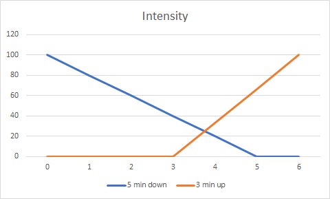

Jason Brameld Posted October 5, 2020 Author Report Posted October 5, 2020 This has been a great thought experiment for me. Thanks for all your input Ed. I was after the straight line performance in the graph without a significant intensity dip. Here are some more graphs: If the intensiity values are run on an HTP basis with a 5 minute down at minute 0 and a 3-minute up at minute 3, then I think you get what's shown on the intensity graph below If you then add in a 4-minute colour crossfade, and multiply the colour values by the intensity values to arrive at the fixture output for each colour then you get (with a slight approximation on the resultant intensity values) the output in the second graph below. The actual output values are not very linear and there is quite a dip in overall brightness at the 3 minute point. The eye doesn't really see the non-linerity, but the brightness dip is noticeable. Your last post above however did cause me to and figure out how to add a delay to a fade on a cue which i hadn't done before - very handy to know. Lastly, in programming your cue sequence I couldn't use Smart Tag for all the cues as cue 2 has the fixtures 'off' and cue 3 has no brightness information in so to program the color fade I had to use 'selected fixtures' to program that cue otherwise it didn't take any information into it - would that be right? Thanks again for the brain exercise! Jason

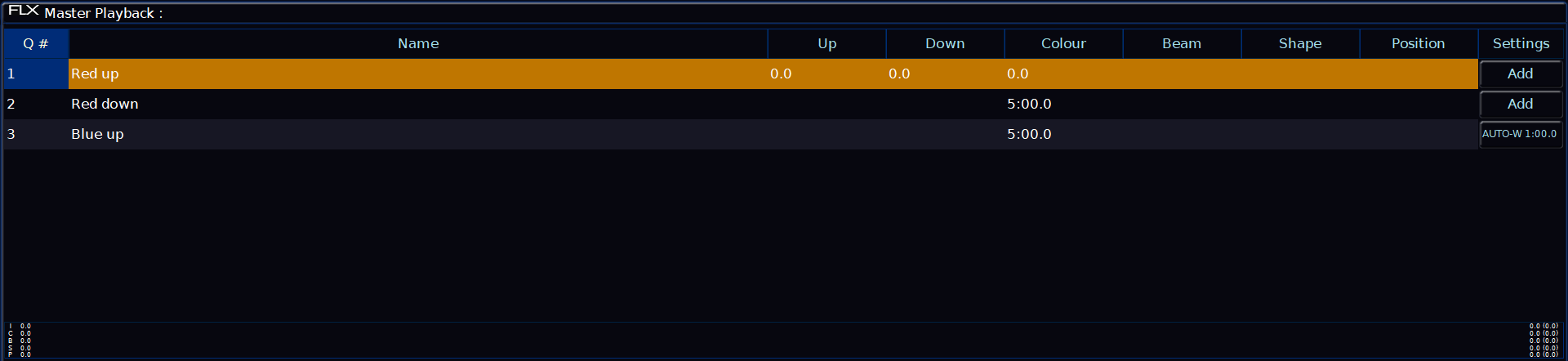

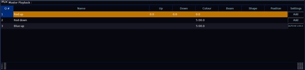

Edward Z88 Posted October 6, 2020 Report Posted October 6, 2020 Hi Jason, Here's another thought - we could just look at doing this with colour fades, and no intensity changes. This would mean we'd need to be careful with tagging as Kevin mentioned earlier. The cue stack would look like this... In cue 1, my fixtures are at full, in red. In cue 2, my fixtures are at full, in black. You can create black quickly by using the slider in the colour picker window to pull all colour mixing down. When cue 2 is triggered, I therefore have a 5 minute fade out of red. In cue 3, my fixtures fade up to full blue, a minute after cue 2 was triggered. The key however, is ensuring that only blue is tagged in cue 3. You can do this by creating blue, but then tapping on the "Red" and "Green" parameter displays so they have a dark blue background rather than light blue, which will display "Untag [Red]" and "Untag [Green]" in the command line. If red is tagged, it will not continue being controlled by cue 2, and so its fade out would slow, so that red would be out at the same time you reach full blue. 11 hours ago, Jason Brameld said: Lastly, in programming your cue sequence I couldn't use Smart Tag for all the cues as cue 2 has the fixtures 'off' and cue 3 has no brightness information in If SmartTag is enabled, the console decides what gets stored. When SmartTag is disabled, you decide. Therefore for all of this, I have had SmartTag disabled, as I need to be specific about what does and what doesn't get included. I hope this helps, let me know your thoughts. Edward Edward Smith Formerly: Zero 88 Product Specialist - Email Support Currently: Obsidian Control Systems Product Specialist

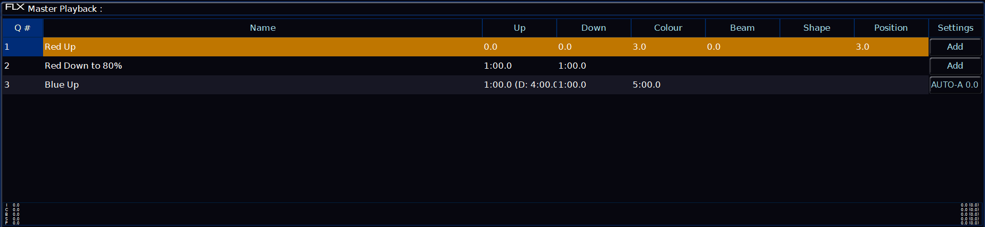

Jason Brameld Posted October 6, 2020 Author Report Posted October 6, 2020 Hi Ed, That all makes sense, and using colour fades only was my method as described in my original post - I was just using changes to colour values (no change to fixture intensity throughout) so my sequence was: Full reds to start (red at 100%, intensity at 100%) Fade red colour values 100% to 80% over 1 minute (minute 1) Crossfade red 80%-0 and blue 0-80% over 4 minutes (start at end of Q2) (minutes 2-5) Fade blue color values 80%-100% over 1 minute (starting at the end of Q3) (minute 6) I could do all of this with Smart Tag on and no tagging/untagging of different colours, but I had to do the maths (admittedly not difficult!) to split the fades up, and your method can do it with one fewer cues. There's always more than one way to skin a cat! Thanks again for the excellent contribution to the debate.
