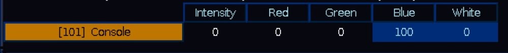

As an aside, I did find a small display bug. When creating cues with just one colour attribute to save into a playback, holding the the clear whilst jiggling the wheels deselected them Ok and the wheel background changed from white to blue, whilst the display changed from blue to black. However the white no colour attribute would deselect OK on the wheel but remain blue on the screen.Smart tag off, 7.9.7 on Leapfrog 48 and Phantom. The illustration shows the display with only blue selected at 100% but white misleadingly remains highlighted. The same seems to happen with intensity. It is immediately updated to show correctly if adding/deselecting fixtures or refreshing the outputs screen.
Well spotted - the parameter table is not updating the tag/untag state straight away when parameters with no Special defined and no details are manually tagged/untagged. The encoder displays are updating correctly, and tapping into the Output window updates the parameter table correctly.
