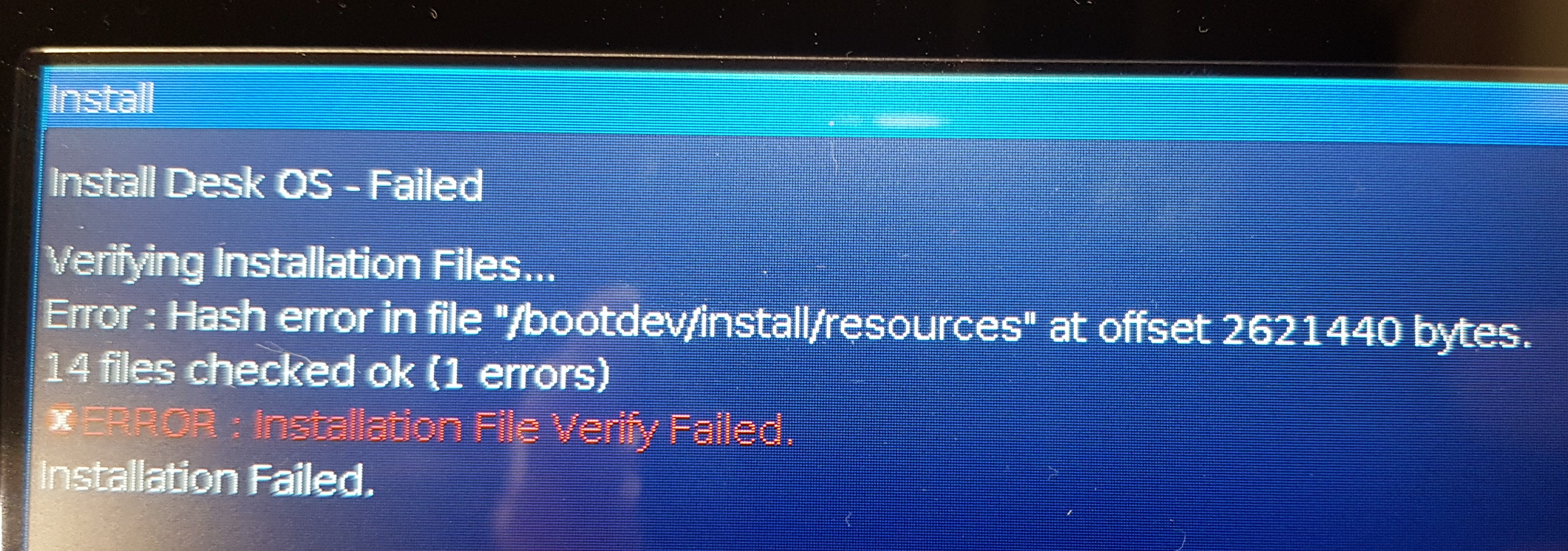

JWylie91 Posted October 6, 2020 Report Posted October 6, 2020 Hi, I've tried installing this beta version on to our FLX today and no matter how many times I run the usb creator (which builds successfully), when i put our zero88 usb that I always use the lighting desk throws up this error when I try to do the install. Any Ideas?? Quote
Edward Z88 Posted October 6, 2020 Report Posted October 6, 2020 Hi Joe, 48 minutes ago, JWylie91 said: I've tried installing this beta version on to our FLX today and no matter how many times I run the usb creator (which builds successfully), when i put our zero88 usb that I always use the lighting desk throws up this error when I try to do the install. Have you tried installing the software, by simply loading the ZerOS 7.9.7.28 application (.exe) into the console from Setup -> Load? Edward Quote Edward Smith Product Specialist Email Support
Jon Hole Posted October 6, 2020 Author Report Posted October 6, 2020 1 hour ago, JWylie91 said: ...no matter how many times I run the usb creator... Out of interest, why did you choose this method of upgrading? Quote Jon Hole Global Product Manager, Systems and Control
JWylie91 Posted October 6, 2020 Report Posted October 6, 2020 It's just the only way I've ever upgraded in all honesty and it has never failed me. I shall head back to the desk now and try the other method. Cheers chaps Quote
JWylie91 Posted October 6, 2020 Report Posted October 6, 2020 Installing it by loading the .exe file directly on the desk has worked. I was not previously aware of this method, Thanks guys. Quote
Edward Z88 Posted October 6, 2020 Report Posted October 6, 2020 Hi Joe, 12 minutes ago, JWylie91 said: Installing it by loading the .exe file directly on the desk has worked. Great, glad to hear it. 9 minutes ago, JWylie91 said: I was not previously aware of this method, Thanks guys. Ah interesting. I am guessing, that you have come to FLX from an older ZerOS console, and therefore this is the method you have always been used to? Loading the software application directly into the console like a show file, is the recommended installation method, and is the method detailed in the release notes. Performing the software update via the bootable drive method, is more of a recovery tool now. If you have any questions, please let us know. Edward Quote Edward Smith Product Specialist Email Support
JWylie91 Posted October 6, 2020 Report Posted October 6, 2020 We've had the FLX from very early on, I had worked with a colleague of mine back then who had some experience with older ZerOS consoles so I guess I picked up that method from him. You learn something new everyday 😃 Cheers! Joe Quote
