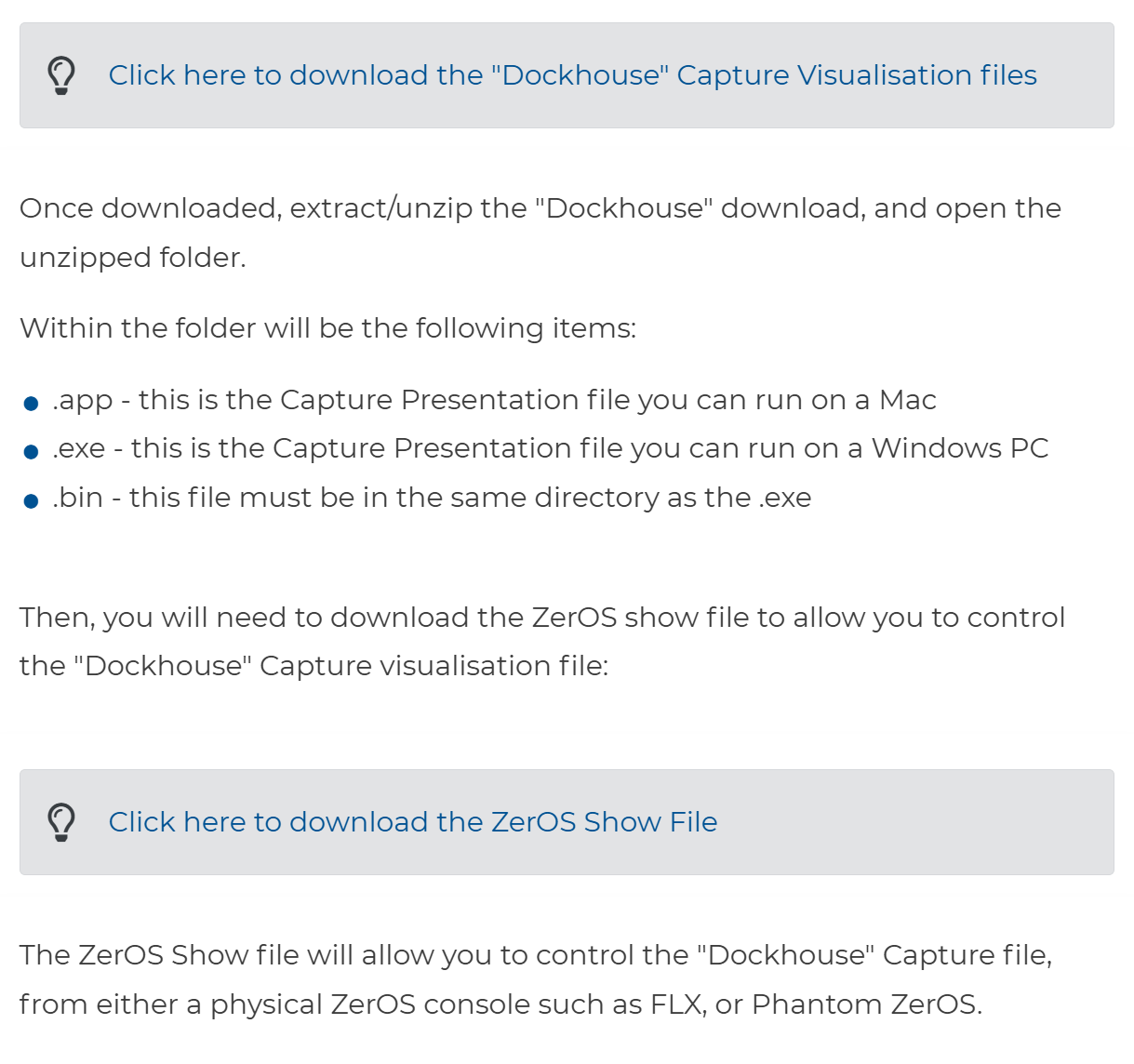

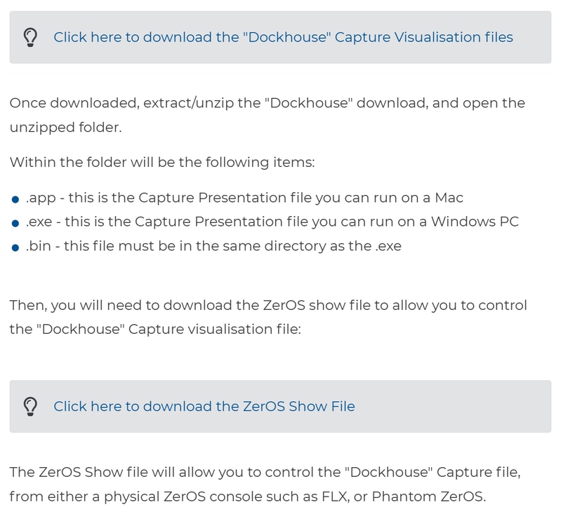

loui013 Posted May 22, 2020 Report Share Posted May 22, 2020 The "Let's Chat" thread in the announcement category mentions the following: Quote 1.Set you up with a free visualiser, allowing you to perfect your programming skills What would this free visualiser option be? I would really like to do some programming but I don't have access to my console at the moment. I have also watched some of your recent training sessions on the Zero88 YouTube channel, which were really helpful and I would like to apply some of things that I've learned to my own workflow. I noticed that you were using the Capture software in your session, but as one license for that costs around 400€ and I can't afford that, I would like to know what this free option you were mentioning would look like. Quote Link to comment Share on other sites More sharing options...
Edward Z88 Posted May 22, 2020 Report Share Posted May 22, 2020 Hello, For our training sessions, we use a free version of Capture, that can be downloaded from our website below... http://support.zero88.com/1004254221 If you don’t have a console, you can practice with the visualisation software by linking Phantom ZerOS to Capture. For more information see below... http://support.zero88.com/988883201 Hope this helps, if you have any questions please let me know. Edward Quote Edward Smith Product Specialist Email Support Link to comment Share on other sites More sharing options...
