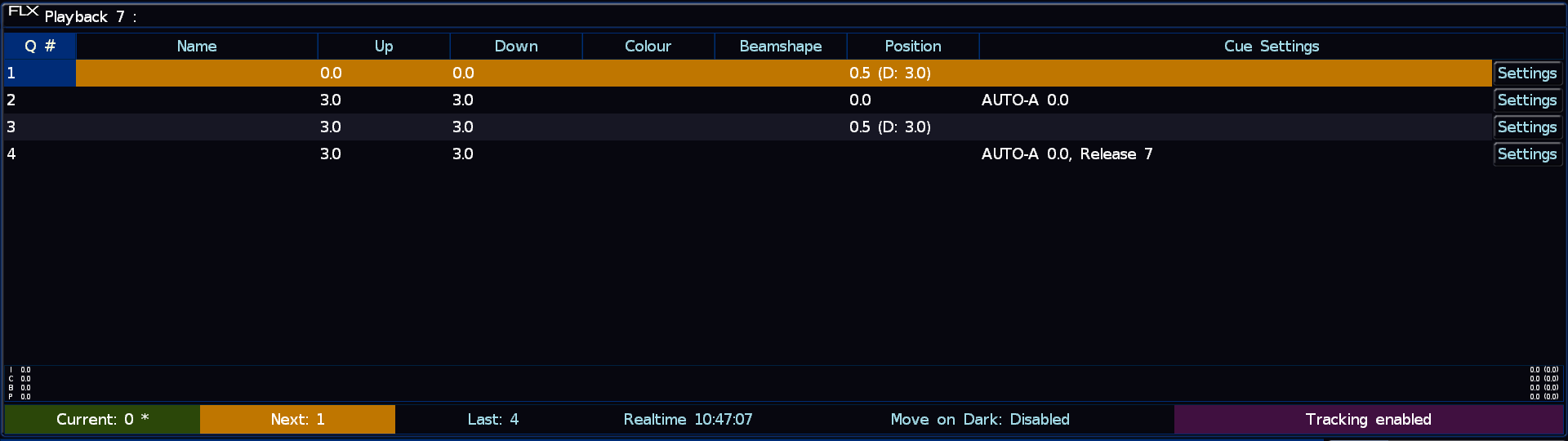

The other option, is to program the below cues...
Note that for this, Move On Dark is disabled, and positions are stored manually, with SmartTag disabled.
Cue 1: Select your "Piano" fixtures, @ ., apply the piano palette, and record as cue 1 on an empty playback.
Cue 2: Simply raises the intensity of the "Piano" fixtures, automatically after the previous cue.
Cue 3: "Piano" fixtures @ ., and apply the palette of the position the fixture should be in when this playback isn't active.
Cue 4: "Piano" fixtures @ ., Record as cue 4, and set this cue to auto follow, and release itself.
The intensity mixing of the playback should be Latest Takes Precedence.
To run this, you can then simply raise the fader, the light turns off, moves, and fades back on automatically. To release this playback, press the go button of this playback, to fade this fixtures off, move them, and fade back to the existing lighting state.
