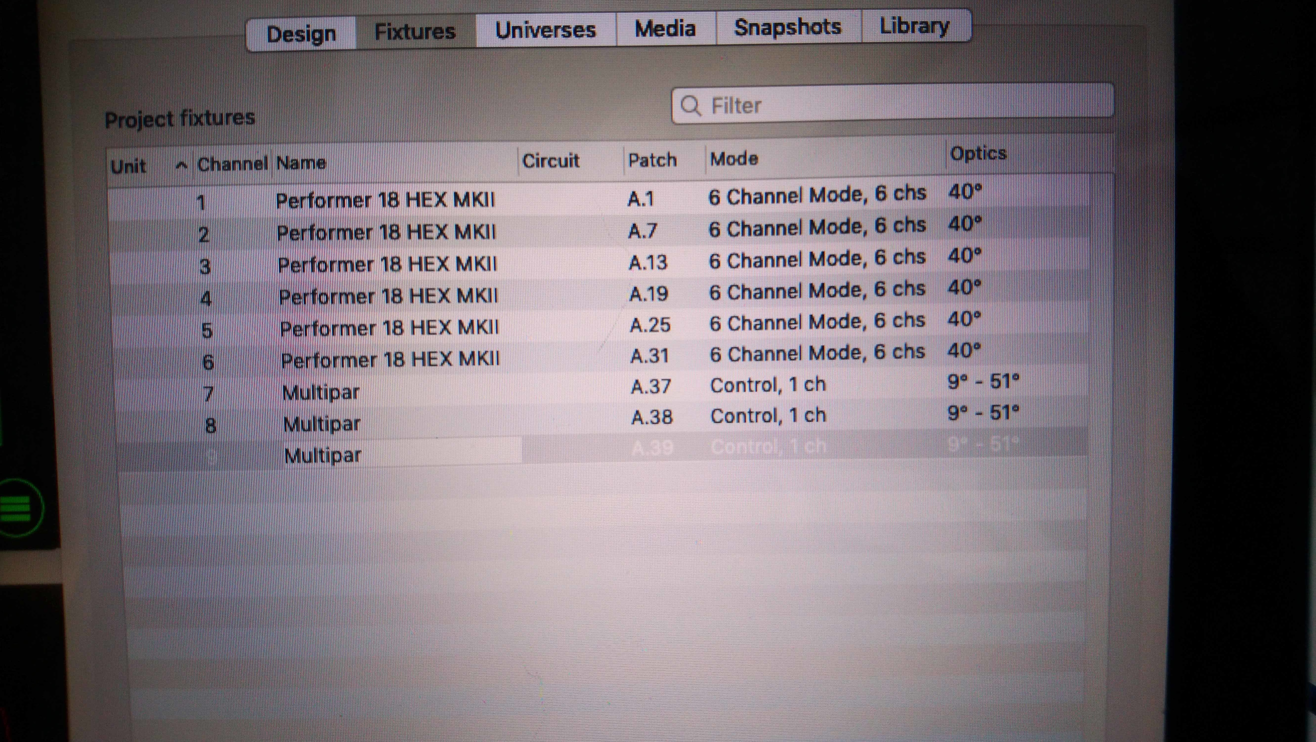

Hi. I use a FLX S24 and am attempting to link it to Capture Solo 2019 visualisation software on a Macbook Pro.
So far I have got the desk to communicate to the Capture software, using a single network a cable link, but that's as far as it goes. I have patched the fixtures in the software and set the channels up but no joy, the desk does not want to operate Capture. Any suggestions for something else to do to get it to talk to the desk?
Attached are a few photos of the setup so far.

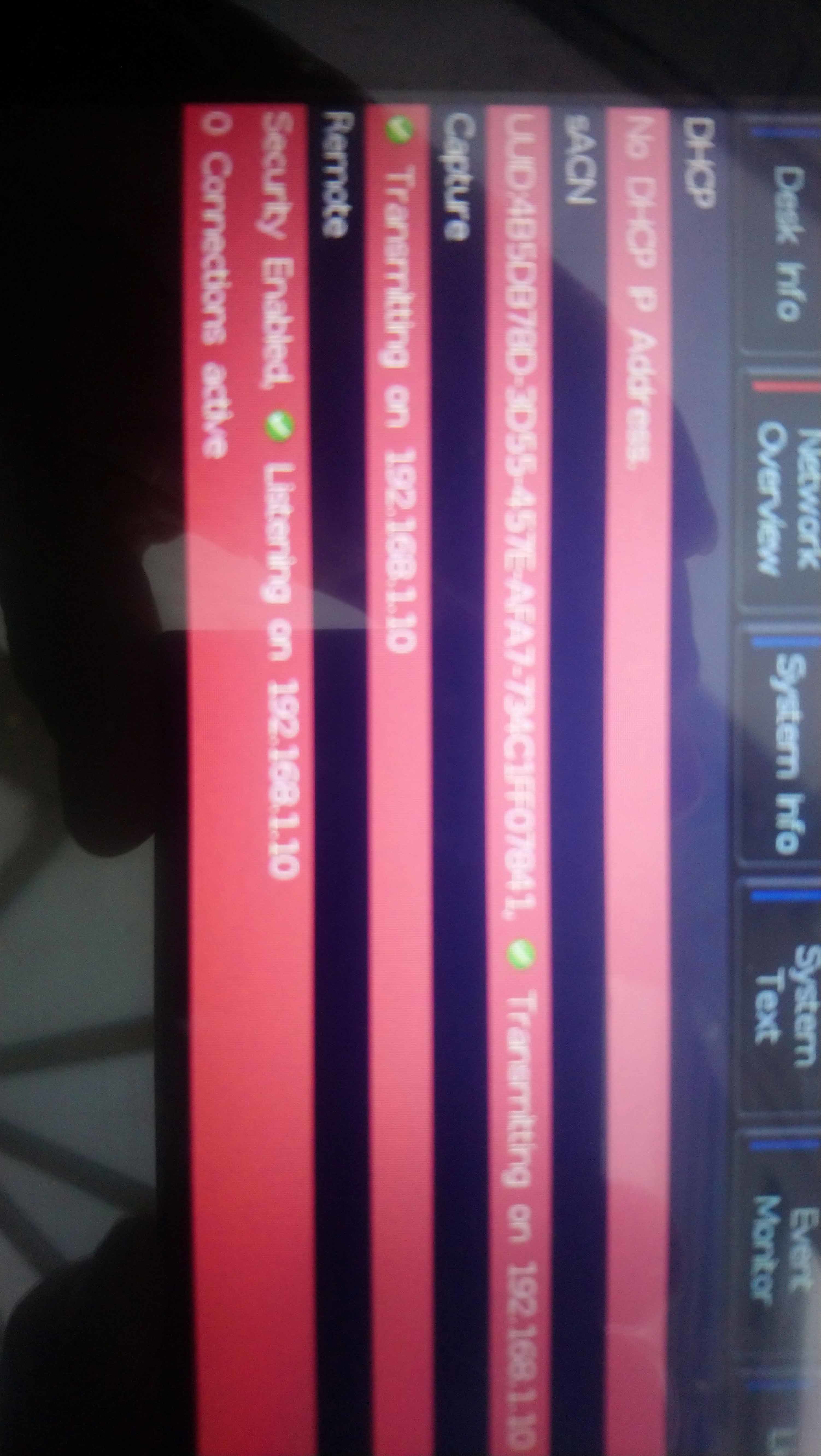

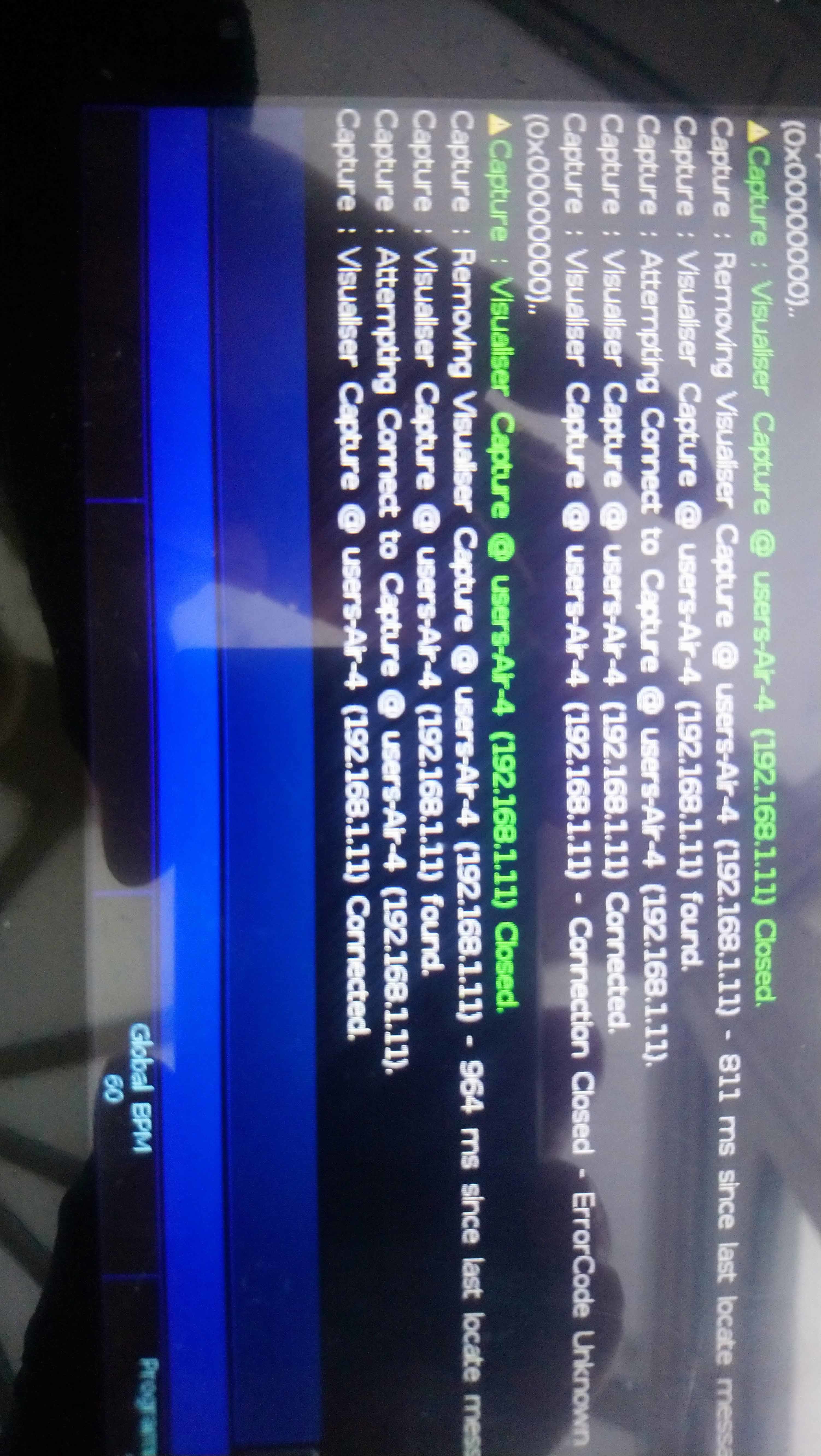

Firstly, you have both sACN and CITP enabled. Only use one protocol to communicate with Capture, otherwise Capture won’t know which stream to connect to. Either protocol can be used to send DMX data to Capture, however CITP allows for selection information and 2 way communication. If you wish to use CITP, disable sACN. This is why you also see the connection status in the System Text.
After doing this, restart Capture - does Capture respond to the console? If not tap SETUP -> Universes -> CITP -> Reset to Defaults, and start from universe 0.
