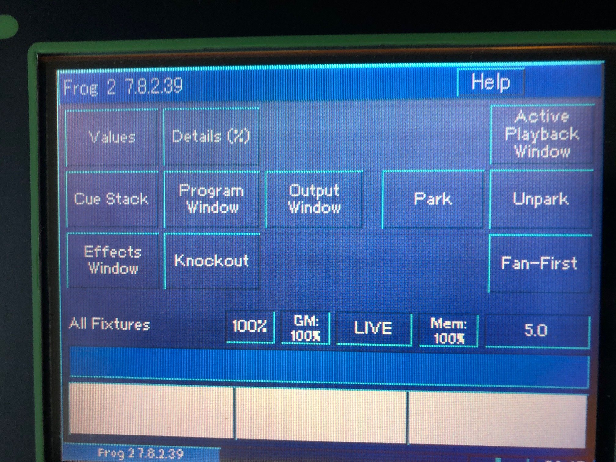

Chris Mower Posted December 31, 2019 Report Posted December 31, 2019 Been going through the Operating Manual and have hit upon an issue. On the Frog2 LCD when I press the Program Window button on the screen the window that appears on monitor one is the Fixtures window. The button is pressing, and even makes a click, but it only displays the fixture window. Am I doing something wrong, or have misread? any help appreciated chris running 27.8.2.39 Quote

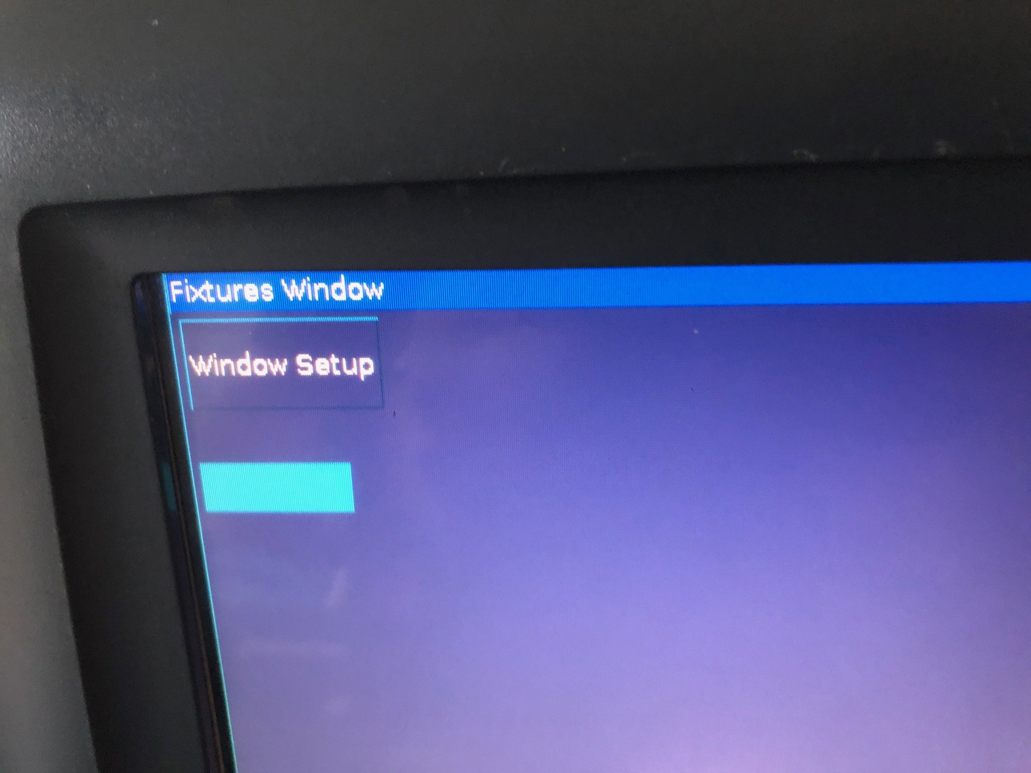

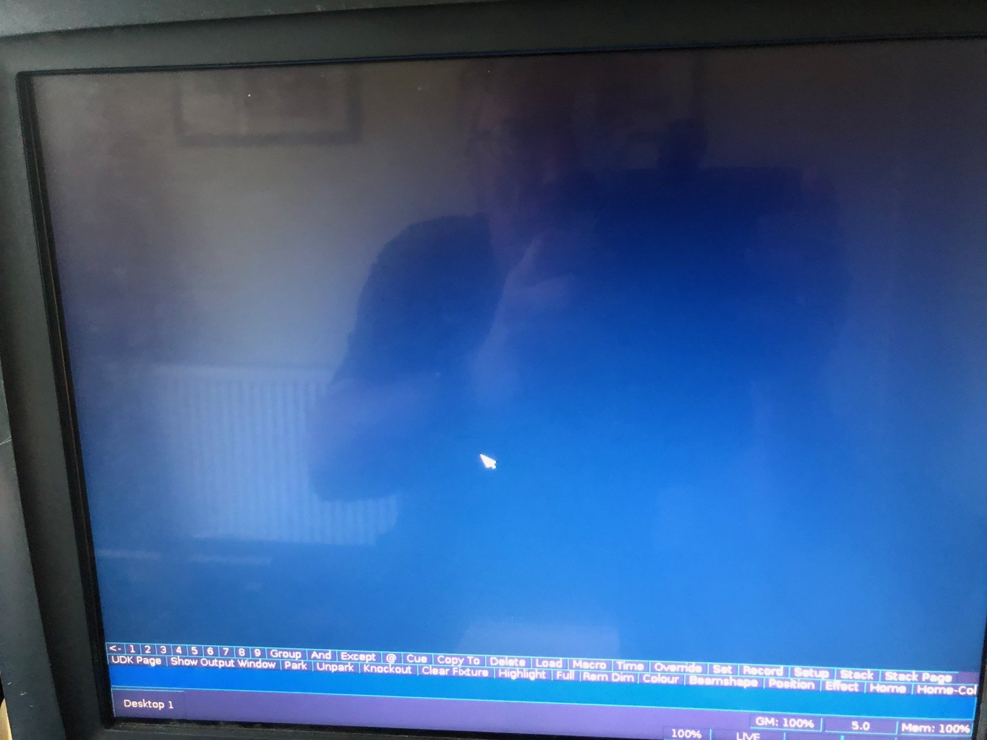

Edward Z88 Posted December 31, 2019 Report Posted December 31, 2019 Hi Chris, Please could you take a picture of the window that opens externally when you press the Program Window button, and post it/email it? If no windows seem to open, press SCREEN, until you see it on your monitor. Edward Quote Edward Smith Product Specialist Email Support
Chris Mower Posted January 1, 2020 Author Report Posted January 1, 2020 Edward Thanks for such a quick response, I hadn’t expected it on New Years Eve! You guys are good. I have attached three pictures. The first shows the display on screen one, which was blank as I had closed down all screens on both displays. The next shows the display after pressing the Program Window button on the LCD, which is shown in the third picture. Does this help? regards Chris oh, and Happy New Year to you all at Zero88! Quote

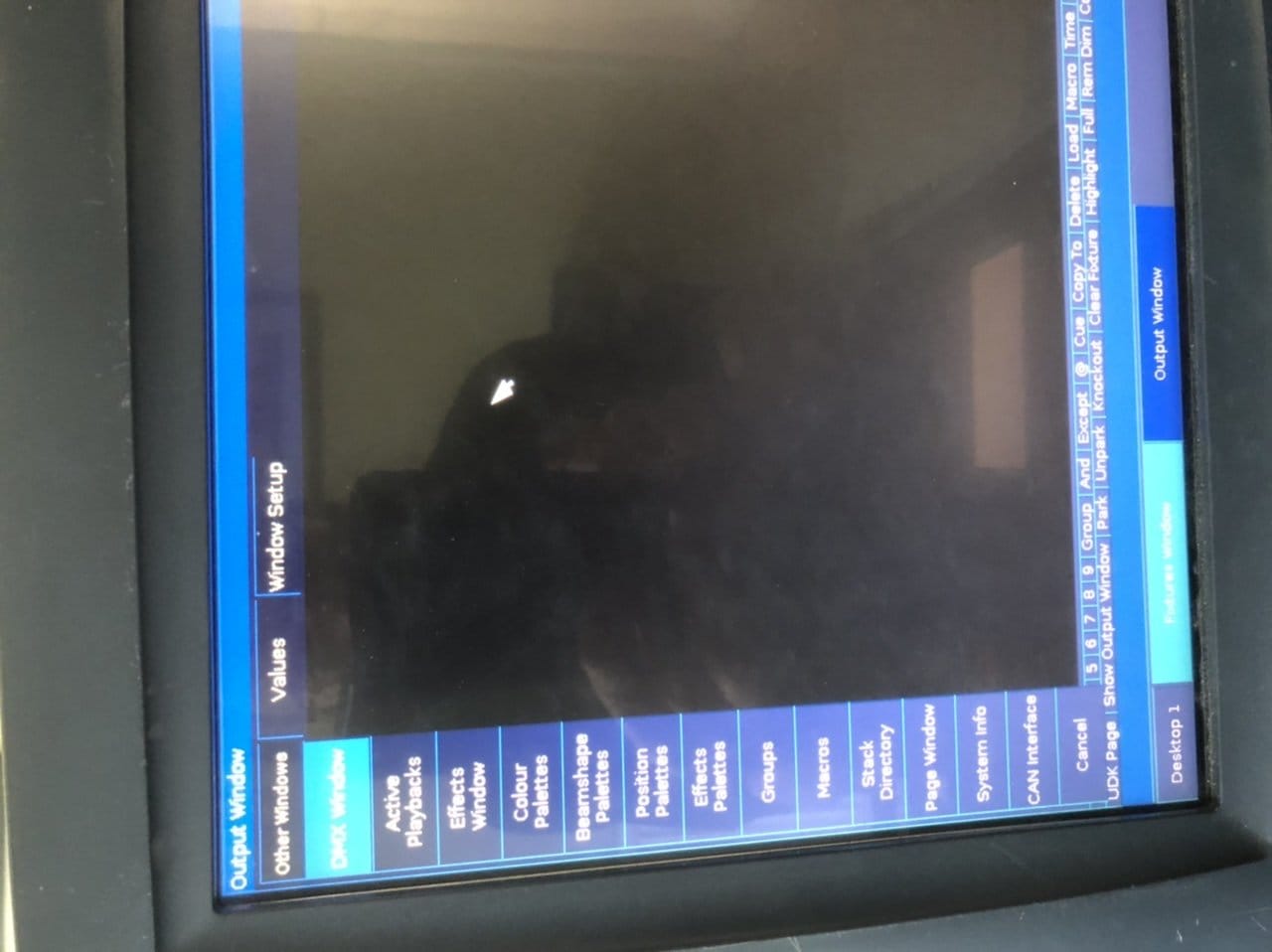

Edward Z88 Posted January 1, 2020 Report Posted January 1, 2020 Hi Chris, If you open the Output Window, tap the “Other Windows” button found top left, and from the drop down choose Program Window. Does this open the window you’re after? Edward Quote Edward Smith Product Specialist Email Support
Chris Mower Posted January 1, 2020 Author Report Posted January 1, 2020 Edward don’t you guys ever take a day off 😃 The Program Window option is not present. I have attached a picture. cheers Chris Quote

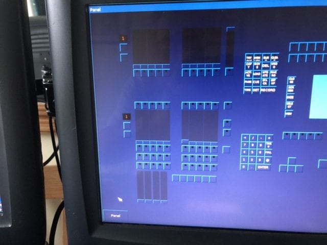

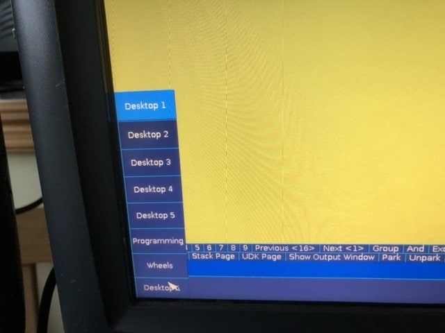

Chris Mower Posted January 1, 2020 Author Report Posted January 1, 2020 Further to the above I noticed that on the Desktop buttons there is one marked Programming on it but when pressed it brings up the Panel window. I have attached pics. Quote
Edward Z88 Posted January 2, 2020 Report Posted January 2, 2020 Hi Chris, Have done a bit of digging into this to remind myself how FROG2 operates. The Program Window was phased out of the FROG2 software in ZerOS 7.8.2.39 (the latest manual was written for software version 4.3). Instead all of the information that was in the Program Window, is shown in the bottom half of the Output Window, when fixtures are selected. Hope this helps, if you have any questions let us know. Edward Quote Edward Smith Product Specialist Email Support
Chris Mower Posted January 2, 2020 Author Report Posted January 2, 2020 Thanks Edward, that solves the issue. Thanks for the assistance. Regards Cris Quote
