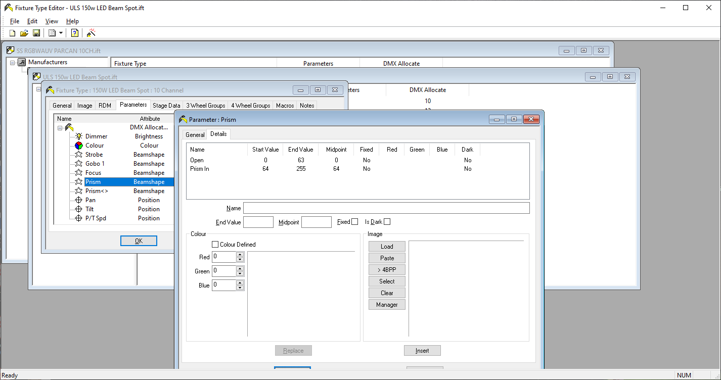

TomJosephSmith Posted December 26, 2019 Author Report Posted December 26, 2019 Hope everyone had a lovely Christmas! So I'm hoping to order my console 1st week of Jan. In the meantime I've been playing around with Phantom ZerOS and it's given me a great feel for the OS, which by the way has improved in so many ways since I last used it. Quick question regarding fixture profiles for movers and how they work with macros. I patched my venue rig and noticed that one type of mover we have did not display the macro tab when selected. I downloaded the fixture type editor software to inspect the fixture profile and indeed there are no macros set up for this particular fixture. Based on the values in the fixture manual, I've created a reset macro setting channel 13 (function) to 201 (the reset range of the fixture is between 200-209). The Edit Macro window looks like this:- Command: Set Channel Level / Data: Funct to level 201 Command: Wait / Data: 10000 ms Is this all I need for an effective fixture reset macro or have I left something out? I won't be able to test it until I get the console and patch in but I'd like to get everything ready in advance if poss as time at the venue for fiddling around with things like this is minimal. This fixture doesn't include remote lamp on/off so it's only the reset macro I'm after. Second question and I really hope it doesn't sound stupid....... I've now saved this modified fixture as it's own file, so I have a .ift file with my new profile sitting on my desktop. I've fiddled for ages in Phantom ZerOS but I still can't figure out how on earth to import a custom fixture type that isn't part of the standard library to the S24. I feel like I'm missing an obvious button. When I tap 'Add Fixtures', it sends me directly to the list of manufacturers. If I tap 'Load' in the sidebar, it seems to only be looking for showfiles. Your help is greatly appreciated. Tom Quote
scottydog75 Posted December 26, 2019 Report Posted December 26, 2019 Hi Tom, Afraid I can't help with your macro question directly however I might try the following approach. Within the parameter of CH13, go to the 'Details' tab. In here create two positions. One to take you to your 'reset' position (values 200-209), and one back to 'default' (I assume 0). Once created these can be accessed by pressing the 'middle button' on the relevant encoder wheel. I have attached a screenshot for a similar set up for a prism, however you should be able to apply this to your situation. I should also be able to help with load fixtures into Phantom. On 12/26/2019 at 7:24 PM, TomJosephSmith said: Second question and I really hope it doesn't sound stupid....... I've now saved this modified fixture as it's own file, so I have a .ift file with my new profile sitting on my desktop. I've fiddled for ages in Phantom ZerOS but I still can't figure out how on earth to import a custom fixture type that isn't part of the standard library to the S24. I feel like I'm missing an obvious button. When I tap 'Add Fixtures', it sends me directly to the list of manufacturers. If I tap 'Load' in the sidebar, it seems to only be looking for showfiles. Expand Simply copy the fixture file into your 'My Documents' folder (this is where Phantom ZerOS is looking for files - or at least on my PC!) and go to the 'Load' page in setup. You should then be able to select your new fixture file and press load. Merry Christmas! Alex Quote
Edward Z88 Posted December 26, 2019 Report Posted December 26, 2019 Hi Tom, Yes, that’s how you setup a fixture macro. From your description it sounds like you have done this correctly. When you save the fixture, make sure you save the fixture with a different name, so that when it is loaded into the console you know which fixture in the library is your edited one. To load into Phantom, save your .ift file into your Phantom Directory. In Phantom, this can be configured on the launcher screen by tapping Settings, and then choosing a directory. Now when you launch FLX S in Phantom, go into Setup (shortcut SHIFT + F10), press Load, you should see the fixture file. Choose it and load it in, and you can then go to Add Fixtures, to find and patch it in the usual way. As Alex describes above, you don’t have to configure Macros if you don’t wish to access functions such as reset. Instead you can go to Beam, find the control/special/reset parameter for the fixture, press the middle encoder button, and then press the function you’re after. Hope this helps, if you have any questions let us know. Edward Quote Edward Smith Formerly: Zero 88 Product Specialist - Email Support Currently: Obsidian Control Systems Product Specialist
TomJosephSmith Posted January 9, 2020 Author Report Posted January 9, 2020 Alex / Edward - thank you very much for your help. I now have a new profile for my fixture including a reset macro which I will test with the fixtures themselves next week. I took delivery of my console yesterday and I've been playing with it for hours. Even though I haven't connected a single light yet, I couldn't be happier. The hardware is very solid and the software is so snappy. My first show of the year isn't until February 15th so I've got loads of time to get used to my new desk. I'll be taking it into my venue beginning of next week to have a proper play with a full rig. I'll probably be back in the very near future with questions. So far I've been able to find my way around very easily thanks to my previous Leap Frog experience, and the fact that the S24 is extremely intuitive. Thanks again for all your help guys. Tom Quote
