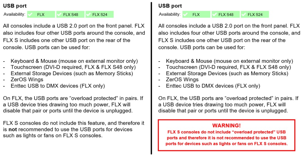

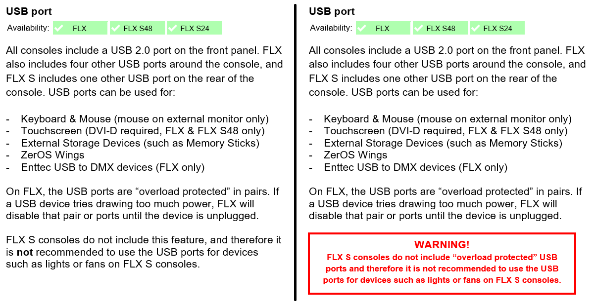

Edward Z88 Posted November 20, 2019 Report Posted November 20, 2019 Hello, Page 15 of the manual states: "FLX S consoles do not include this feature (referring to self healing USB ports), and therefore it is not recommended to use the USB ports for devices such as lights or fans on FLX S consoles." https://zero88.com/storage/downloads/7f906b85-80f1-4646-bd18-d2327d94fc60/FLX-Range-&-ZerOS-Accessories-User-Manual-v7.9.6.pdf Page 82 of the manual states that USB ports are for keyboard & mouse, external touchscreen (S48), and external storage devices. If you have any questions let me know. Edward Quote Edward Smith Formerly: Zero 88 Product Specialist - Email Support Currently: Obsidian Control Systems Product Specialist
Jon Hole Posted November 20, 2019 Report Posted November 20, 2019 56 minutes ago, drscoop said: Edward, is it worth a note to that effect in the manual? I don’t think we’d been advised of that, but may have missed it? 31 minutes ago, Edward- Z88 said: Page 82 of the manual states that USB ports are for keyboard & mouse, external touchscreen (S48), and external storage devices. On page 15 of the manual, it also states: Quote On FLX, the USB ports are “overload protected” in pairs. If a USB device tries drawing too much power, FLX will disable that pair or ports until the device is unplugged. FLX S consoles do not include this feature, and therefore it is not recommended to use the USB ports for devices such as lights or fans on FLX S consoles. As Edward says, we've updated the manual to put this in a nice big red box, on both Page 15 and Page 82. We haven't released this version of the manual yet, but it'll be included within the next public revision. Before / after: Quote Jon Hole linkedin.com/in/jonhole
