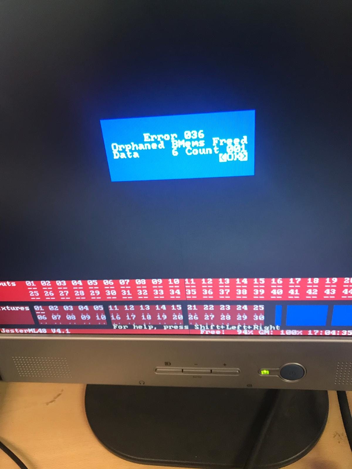

Can anyone explain? - Error 036 Orphaned Bmems freed?
Don't normally see that message on an ML desk.
It would indicate either attempting to load a show file saved on desk running an older show file or the show file has become corrupted, possible due to a flat battery.
Pressing enter should remove the message and allow the desk to operate as normal.
If you have loaded an old show then save it under a different name and reload it to cover it to a 4.1v.
If its a battery issue check the date and time as this will have reset to a much older one.
