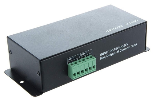

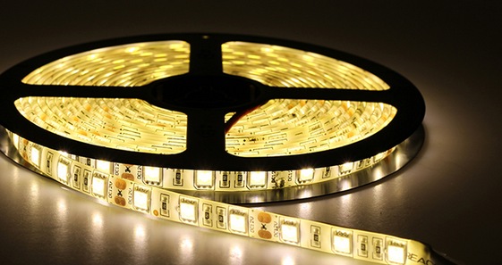

Zulu Posted September 25, 2019 Report Posted September 25, 2019 Hi, all. I wonder if anyone can help with this problem . . . I am planning to control RGB LED tape from my FLX S24 desk. I have bought and connected some RGB 5050SMD 10mm tape, similar to this: I have bought and patched a DMX Decoder, 3 Channel, Generic maunufacturer, similar to this: I've used the 3 Channel RGB LED fixture in the Generics section of the Fixture Library on the FLX S24. I'm getting no life from the set up at all. I have connected the same arrangement to a laptop running LightFactory software, and the LED tape responds correctly. So that means the LEDs, DMX Decoder, and cables are all good. Any thoughts why this arrangement doesn't work with the FLX S24? Note, I have used the 3-Pin DMX output from the desk, as I didn't have a 5 pin adapter handy. Thanks in anticipation . . . Zulu. Quote

Edward Z88 Posted September 25, 2019 Report Posted September 25, 2019 Hi Zulu, If you choose LED Unit under Generic manufacturers in Add Fixtures, and see a 3Ch RGB LED with virtual intensity fixture, ensure you patch this. If you just see 3Ch RGB LED, choose this (depending on the version of the Fixture Library on the console, you will see different fixtures). As Kevin describes, always use a virtual intensity if there isn’t a dedicated intensity parameter. Have you got a 2 universe or 1 universe FLX S. If you have a 2 universe console, the 3 pin output will be universe 2 by default. You therefore need to patch your RGB LED unit onto desk universe 2, or under SETUP -> Universes -> Desk Universe 1, also add DMX output 2. You will then need to ensure the DMX address configured on the dip switches/ the address you have used in LightFactory, is matching on FLX S. If this still doesn’t help, patch 3 dimmers to channels 1 through to 3, on DMX 1 through 3. Address the decoder to DMX address 1, and ensure both DMX Outputs are outputting the required universe. You can then use each channel fader, and should control RGB. To see the raw DMX you are sending, tap Z/Shift -> System Information -> DMX Outputs. Hope this helps, if you have any questions let us know. Edward Quote Edward Smith Formerly: Zero 88 Product Specialist - Email Support Currently: Obsidian Control Systems Product Specialist
Zulu Posted September 30, 2019 Author Report Posted September 30, 2019 Thanks, Ed. I've tried a couple of fixture profiles . . . 3Ch (RGB), 4Ch (RGB-D), (D-RGB), with no joy. I was doing this at home, where I only had 3-pin DMX cables available, hence using the 2nd DMX output. I have a 1-universe desk, so was expecting identical behaviour from each DMX output. However, when trying the set up at the theatre, with the 5 pin cable from DMX Output 1, my LED strip behaved properly ! All is well ! So I now wonder if there is a problem with my DMX Output 2. Is it "switched off" ? So for now, my LED Tape problem is solved, but I now need to do some more specific testing on the 2nd DMX output of the desk. This is the 1st time I've used this output since I bought the desk a few months ago. thanks, Zulu Quote
