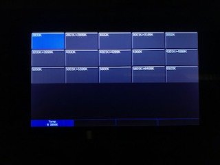

.... yes think so...  it's the tab the appears on the screen directly above the encoder wheel. Since I've disabled RigSync the flat panels (Velvet1's and Velvet2's) have also begun to behave themselves, and even more impressively, if I press the centre encoder button I get a 15 panel on-screen matrix of selectable CCT values (i'm really impressed... I've uploaded an image) I know they use a shed load of these at ITV in Leeds so didn't think a chap had to keep running up and down a ladder to change the CCT. If I can do the same (or something similar) for the fresnels, I think I'm home and dry!
That's a job for tomorrow... thanks so much for your help.
Expand
That's great, really glad to hear it. When pressing the middle button of a parameter's encoder, this opens the parameters details. An indication to whether a parameter has details, is if the parameter has a function name below the parameter name, rather than simply a DMX level value.
