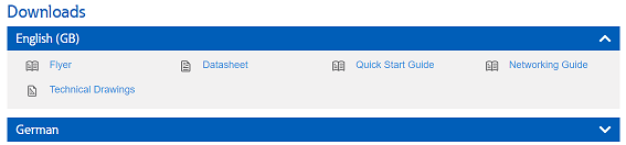

1) All downloads for current products (such as ZerOS, Fixture Library etc) will be much more simply downloadable directly from the relevant product page, and looks a little like this:

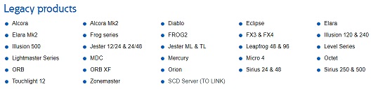

Completely agree, which is why we're trying to bring it all together onto the new website. This will happen in phases, but the end goal is a single website, with a single search function. However, the website is also a marketing tool - so current product will always take "pride of place" and have all the pictures etc! Legacy products will then be listed as-per the screenshot above.
