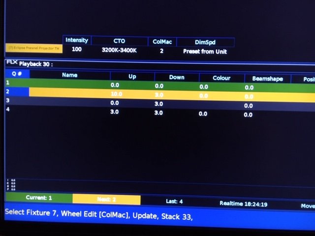

hansreinhard Posted December 7, 2019 Report Share Posted December 7, 2019 Hi, here my answers: I live in Munich, Germany Use FLX since September 2019 FLX plus 1 wing plus touchscreen Mainly theater, occasionally small concerts We have 17 LED fresnel, 2 LED Profilers, 4 Moving Heads, some dimmers. FLX is used stationary in a venue for 120 pax 2 to 5 shows a week. I don't know any FLX user in bavaria, all hints came from the system house. we used a Jester before, this was rock solid over years (but way too small for our new fixtures). FLX is a little trickier, we had some issues with 7.9.5, most of them were gone with 7.9.6. For me it is always a bit shocking, when the console will not boot up completely before a show (occasionally some of the funktions are missing, e.g. cursor up/down not working or touchscreen not showing up), a quick restart usually helps. Always a bit struggling with the fade up- and down-times of cues: seems that I need to proggram the *down* time to get a nice *fade-in* - weird.... Quote Link to comment Share on other sites More sharing options...
Edward Z88 Posted December 7, 2019 Report Share Posted December 7, 2019 Hello, Thanks for your comments. 9 hours ago, hansreinhard said: Always a bit struggling with the fade up- and down-times of cues: seems that I need to proggram the *down* time to get a nice *fade-in* - weird.... Remember, when you Go into a cue, any lights that have to fade up to get to the programmed intensity will use the cue you’re going into’s up time, and any fixtures that have to go down to get to the programmed intensity will use the cue you’re going into’s down time. Therefore if you are going into a cue from a blackout, only the fade up times are relevant, and if you are going into a blackout only the fade down time is relevant. Hope this helps, Edward Quote Edward Smith Product Specialist Email Support Link to comment Share on other sites More sharing options...

hansreinhard Posted December 7, 2019 Report Share Posted December 7, 2019 Edward, this is the way I expected the fades to work. in my example (screenshot!) cue #1 has no fade in or fade out. when I go to cue #2, it fades in in 10 seconds (as expected) BUT: cue #1 fades out in 3 sec. Did I get anything wrong? Have a nice weekend! Hans Quote Link to comment Share on other sites More sharing options...
Edward Z88 Posted December 7, 2019 Report Share Posted December 7, 2019 Hi Hans, 38 minutes ago, hansreinhard said: Edward, this is the way I expected the fades to work. in my example (screenshot!) cue #1 has no fade in or fade out. when I go to cue #2, it fades in in 10 seconds (as expected) BUT: cue #1 fades out in 3 sec. That is correct. Don’t think of it as cues fading in/ fading out, think about what the fixtures do when you press GO. For example when you go into cue 2, any lights that have to fade down, use the down time of the cue 2. It therefore doesn’t matter if you run the cue list out of order. The fade down time of cue 1 would only be used if you went from a cue back to cue 1, and fixtures had to lower in intensity. Hope this helps, Edward Quote Edward Smith Product Specialist Email Support Link to comment Share on other sites More sharing options...
hansreinhard Posted December 7, 2019 Report Share Posted December 7, 2019 3 hours ago, Edward- Z88 said: Don’t think of it as cues fading in/ fading out, Uh, that's crazy! I will try to keep that in my mind... It's weired for me, because in my eyes every cue (=scene) should have it's fade-up and down time stored within. That's the way, theatre people think... in Jester it worked like this. cheers! Hans Quote Link to comment Share on other sites More sharing options...

Edward Z88 Posted December 8, 2019 Report Share Posted December 8, 2019 Hi Hans, 12 hours ago, hansreinhard said: Uh, that's crazy! I will try to keep that in my mind... It's weired for me, because in my eyes every cue (=scene) should have it's fade-up and down time stored within. That's the way, theatre people think... in Jester it worked like this. cheers! Hans The way FLX handles cue fade times is the same way that Jesters work, with the down time effecting any fixtures fading out when go is pressed, not the speed of the previous lighting state to “fade out”. As far as I’m aware this is how all lighting console cue fades work. Edward Quote Edward Smith Product Specialist Email Support Link to comment Share on other sites More sharing options...
kgallen Posted December 8, 2019 Report Share Posted December 8, 2019 1 hour ago, Edward- Z88 said: As far as I’m aware this is how all lighting console cue fades work. And also effectively how we worked in the "old days" with a manual preset desk - executing the cue was by moving a number of master (or group) faders from max to min, so the "down" time for lights in cue (n-1) was enacted by the speed we moved the outgoing scene fader from max to min when enacting cue n. Similarly the "up" time was for the incoming cue n. Quote Link to comment Share on other sites More sharing options...
hansreinhard Posted December 9, 2019 Report Share Posted December 9, 2019 thank you, Edward, got it now.... hansreinhard Quote Link to comment Share on other sites More sharing options...
Edward Z88 Posted December 9, 2019 Report Share Posted December 9, 2019 Hi Hans, 20 minutes ago, hansreinhard said: thank you, Edward, got it now.... hansreinhard Glad to hear it! Any questions let us know. Edward Quote Edward Smith Product Specialist Email Support Link to comment Share on other sites More sharing options...
