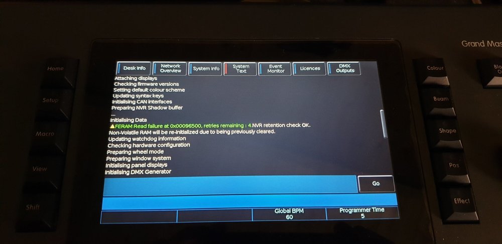

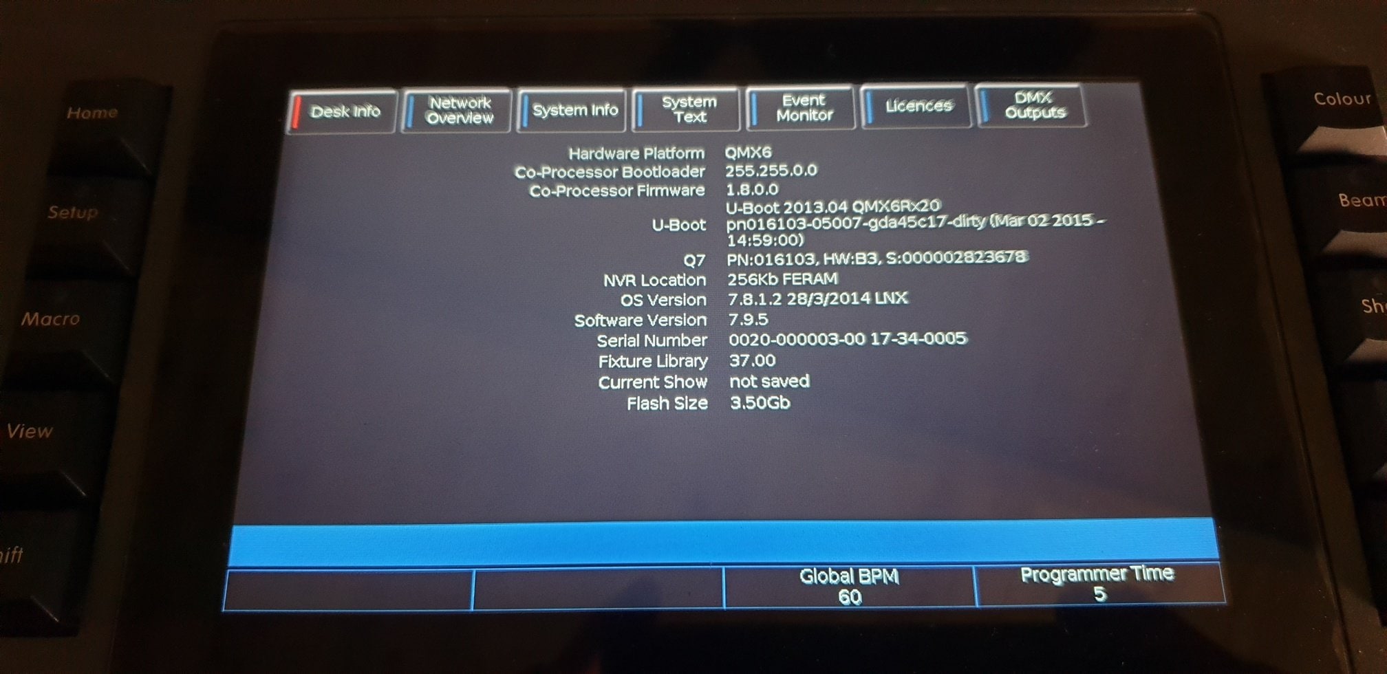

Hi all,
I have also just installed ZerOS 7.9.5 with the same issue.
I spoke to Keith who has directed me to this post. The file below is no longer "available", please can you re-upload it?
On 5/20/2019 at 12:03 PM, Edward- Z88 said:
If you can't seem to get the Auto-Effects to generate, please download the file attached...
I also got an error during boot which may or may not be part of this common issue. Pictures attached for reference. Edward/Nathaniel, please can you forward these onto Keith for his info.
Cheers,
Alex
