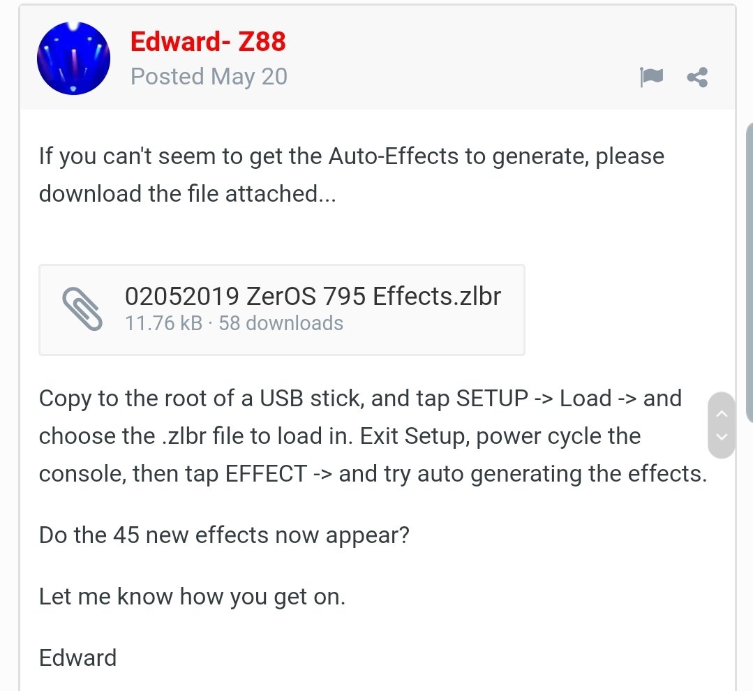

Howartp Posted July 14, 2019 Report Posted July 14, 2019 Help.... Dress Rehearsal in two hours.... We've just updated desk from 7.9.4 to 7.9.5 to get the additional effects that @robhurt has been waiting for. However when you go to "Automatically update effects" it says there are NO effects - even the ones from 7.9.4 have disappeared. This is with a blank show file and a single patched fixture (Martin Mac 250 Krypton - Enhanced mode) , not even using our existing show file. I've downloaded Phantom 7.9.5 and can see that all the effects are working in there. This was originally with the "prep USB stick, then power up with stick inserted" method; we tried "Setup > Load > install" but this bricked the console, wouldn't boot pass the segments going dizzy on the channel/page LCD. Reloading via prepped stick has got the console working again. Any advice? Peter Quote
Howartp Posted July 14, 2019 Report Posted July 14, 2019 On 7/14/2019 at 11:56 AM, Howartp said: Help.... Dress Rehearsal in two hours.... We've just updated desk from 7.9.4 to 7.9.5 to get the additional effects that @robhurt has been waiting for. However when you go to "Automatically update effects" it says there are NO effects - even the ones from 7.9.4 have disappeared. This is with a blank show file and a single patched fixture (Martin Mac 250 Krypton - Enhanced mode) , not even using our existing show file. I've downloaded Phantom 7.9.5 and can see that all the effects are working in there. This was originally with the "prep USB stick, then power up with stick inserted" method; we tried "Setup > Load > install" but this bricked the console, wouldn't boot pass the segments going dizzy on the channel/page LCD. Reloading via prepped stick has got the console working again. Any advice? Peter Expand Right, i've subsequently found the two threads below (neither called "...effects..." so I didn't see them): Downloading the library file within the second thread has fixed the issue, so please add us to the list of customers affected by this problem. (Original FLX for reference) Peter Quote
Edward Z88 Posted July 14, 2019 Report Posted July 14, 2019 Hi Peter, As mentioned in the thread you linked to, the new effects aren’t loaded, if software is installed from a bootable USB drive, rather than running the install application on the console. On 7/14/2019 at 11:56 AM, Howartp said: we tried "Setup > Load > install" but this bricked the console, wouldn't boot pass the segments going dizzy on the channel/page LCD. Reloading via prepped stick has got the console working again. Expand I haven’t seen this before. So when FLX displayed switch off the console, how long did you leave after turning the console off and on again? How long did you wait whilst the page segment display was loading? Did you see anything on the internal or external screens? All the best, Edward Quote Edward Smith Formerly: Zero 88 Product Specialist - Email Support Currently: Obsidian Control Systems Product Specialist

Gingersteve91 Posted August 22, 2019 Report Posted August 22, 2019 On 8/22/2019 at 12:51 PM, Edward- Z88 said: Hi Steve, For information on setting Max Level and fixture Defaults, see the article below... http://support.zero88.com/1011707631 Hope this helps, if you have any questions let us know. Edward Expand Thanks for that Edward, Just what I needed. NEW issue/bug maybe?: All of our previously saved effects pallets (and subs) no longer work and hitting "create effects automatically" button just deletes all old palettes and leaves us with nothing (not that the older ones work anyway) 1) Do we have to rebuild everything from scratch? 2) Why are our old palettes/subs not working? Again TIA Quote
Edward Z88 Posted August 22, 2019 Report Posted August 22, 2019 Hi Steve, Just to confirm, what console is this on? What software version were you running previously before updating? I would recommend doing a fresh install of ZerOS 7.9.5, using the instructions available here... http://support.zero88.com/1518910761 Once ZerOS 7.9.5 is freshly installed, you should find new effects are available when you press the "Auto Create Effects" button. If loading in the show file into the freshly installed software is still causing issues, please send us a copy of your show file to support@zero88.com, and one of the team will take a look to see what may be causing the issues. Hope this helps, Edward Quote Edward Smith Formerly: Zero 88 Product Specialist - Email Support Currently: Obsidian Control Systems Product Specialist

Gingersteve91 Posted September 14, 2019 Report Posted September 14, 2019 On 8/22/2019 at 4:30 PM, Edward- Z88 said: Hi Steve, Just to confirm, what console is this on? What software version were you running previously before updating? I would recommend doing a fresh install of ZerOS 7.9.5, using the instructions available here... http://support.zero88.com/1518910761 Once ZerOS 7.9.5 is freshly installed, you should find new effects are available when you press the "Auto Create Effects" button. If loading in the show file into the freshly installed software is still causing issues, please send us a copy of your show file to support@zero88.com, and one of the team will take a look to see what may be causing the issues. Hope this helps, Edward Expand Hi Edward, The console is a OrbXF fully up to date. The problem occurred after we updated (with fresh install from USB). Now when selecting our fixtures no effect (from pallet) can be used and as stated above the "auto create effects" detelets all pallets and doesnt replace them with any new ones. Going to do abit more digging if no success we'll send through file. Quote
Gingersteve91 Posted September 14, 2019 Report Posted September 14, 2019 Hello all update on my situation I found the attached library patch on another thread which has solved my effects issue. Working fine now. Some nice new effect in there too. Quote
Edward Z88 Posted September 14, 2019 Report Posted September 14, 2019 Hi Steve, On 9/14/2019 at 3:44 PM, Gingersteve91 said: Working fine now. Some nice new effect in there too. Expand Great, glad to hear it. For reference, the reason the effects didn’t load, is due to installing the software via the old installation method. Loading the software into the console via SETUP -> Load, loads the new effects. All the best, Edward Quote Edward Smith Formerly: Zero 88 Product Specialist - Email Support Currently: Obsidian Control Systems Product Specialist
