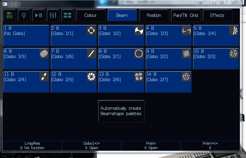

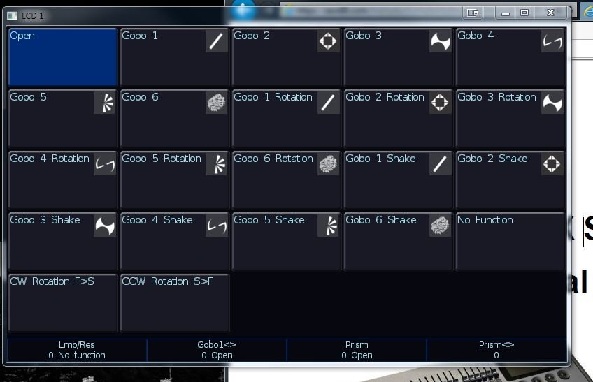

drscoop Posted April 27, 2019 Report Share Posted April 27, 2019 Hi, I noticed that, when auto-generaing profiles, the rotating gobo profile on the MH-5 is slightly out from those in the fixtures - they're all offset by one position. So, Gobo 2 in the wheel is gobo 1 in the auto-palette, Gobo 3 as palette gobo 2 etc, with gobo 7 being gobo 1 in the palette. However, if I tap on the encoder, the renderings are correct - there seems to be a bug in the generation of the image capture in the profile generator? Screen grabs from PhantOS attached... Quote Link to comment Share on other sites More sharing options...
Edward Z88 Posted April 28, 2019 Report Share Posted April 28, 2019 Hello, Interesting, thanks for letting me know. I will take a further look into this. If you have any queries let me know. Edward Quote Edward Smith Product Specialist Email Support Link to comment Share on other sites More sharing options...
