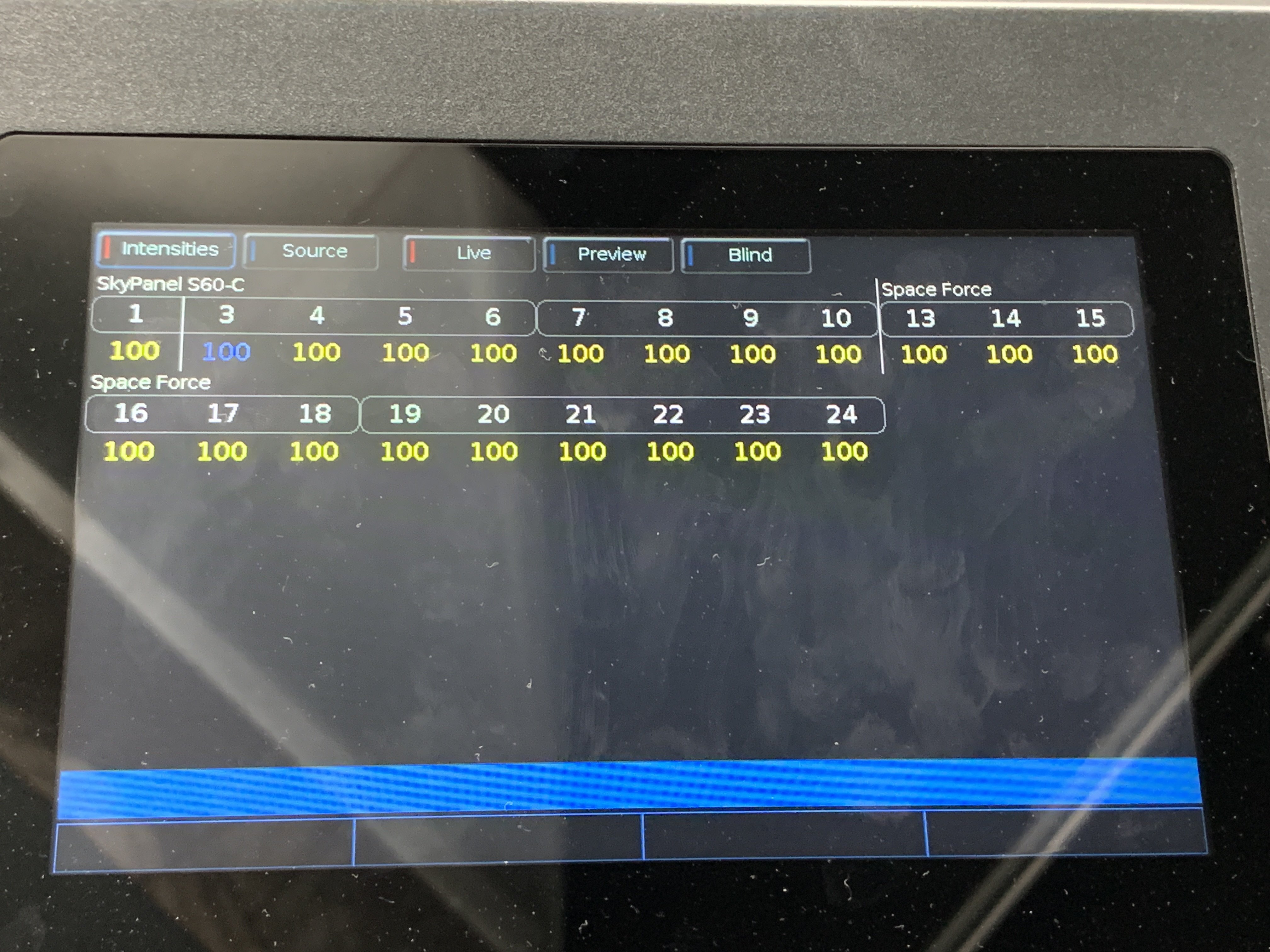

JMorgan Posted April 15, 2019 Author Report Share Posted April 15, 2019 Hi Edward, nothing is set to inhibit. By playing around some more my playback 2 seems to be working okay now by having the various playbacks set to LTP catch. In other settings, it doesn’t play the intensity changes. regarding playback 1, even by updating the playback or saving it as a snapshot, it still only seems to operate the single fixture. I’ve attached an image of the output window. would a show file benefit? I can hunt down a USB stick if so. thanks Quote Link to comment Share on other sites More sharing options...
Edward Z88 Posted April 15, 2019 Report Share Posted April 15, 2019 Hello, Yes a copy of your show file may be handy to take a look at what is going on. From the picture it shows all except fixture 3 displayed in yellow. This means their intensity is being controlled by a UDK, they are Highlighted, or their intensity default values have been changed. More on Output Window colours can be found here... http://support.zero88.com/1011707591 UDK data and playback data will be mixed HTP, and therefore as they are at 100% this will be output. All the best, Edward Quote Edward Smith Product Specialist Link to comment Share on other sites More sharing options...
