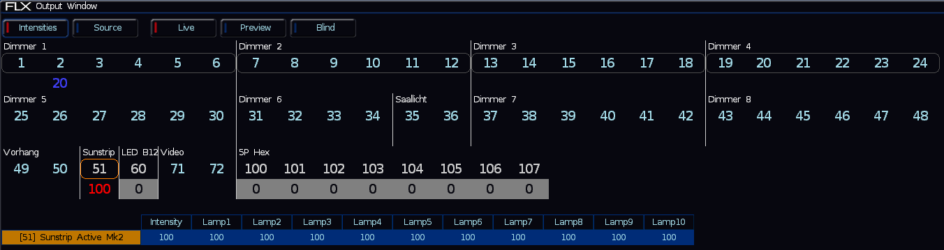

martin-144 Posted May 12, 2019 Report Share Posted May 12, 2019 On 5/8/2019 at 10:37 AM, Peachy001 said: The way I've done this with our sunstrips is to go into EFFECTS press the WAVEFORM and add a RAMP or RAMPINV to each lamp followed by setting different offset values to each lamp. Save the effect to an effect palette, you should now be able to select the effect and control the speed. Doing it this way means you don't have to define each lamp as a separate fixture. Have a go and see how it works for you. Hi folks, I have tried to reproduce this on Phantom. If I select a patched Sunstrip and try to apply an effect like described, my output window looks like in the attached picture. I can see there is something going on in the DMX output view. But you cannot see any effect applied in the channel view (here it is channel 51). Is this how it's intended to be? Martin Quote Link to comment Share on other sites More sharing options...
Peachy001 Posted May 13, 2019 Report Share Posted May 13, 2019 15 hours ago, martin-144 said: Hi folks, I have tried to reproduce this on Phantom. If I select a patched Sunstrip and try to apply an effect like described, my output window looks like in the attached picture. I can see there is something going on in the DMX output view. But you cannot see any effect applied in the channel view (here it is channel 51). Is this how it's intended to be? Martin Yes Martin, when an effect is running the output window in phantom doesn't show the intensity moving on the individual lamps. You'll find when you run it on the desk with the Sunstrip connected to the desk, this will be working. If you record this into a playback fader, make sure the intensity on the Sunstrip is on FULL before recording. This will allow you to adjust the overall intensity of the effect when the trigger on fader is enable on the playback settings (raise and lower setting). Quote Link to comment Share on other sites More sharing options...
Edward Z88 Posted May 16, 2019 Report Share Posted May 16, 2019 Hi Martin, As Peachy says, this is correct. If you select the fixture and go to effects, you'll get the details on how these parameters are being adjusted. The values in the output window are their base levels the waveform is manipulating. Hope this helps, Edward Quote Edward Smith Product Specialist Email Support Link to comment Share on other sites More sharing options...
