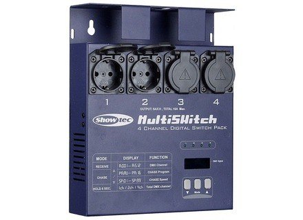

Where your equipment can be mains on-off switched you should use a DMX-controlled switch pack that uses relays rather than triacs, like the Showtec RP-405 (https://www.thomann.de/gb/showtec_rp_405_mkii_relay_pack.htm). I use such a switch pack for turning on and off mirror ball (motors) for example.
