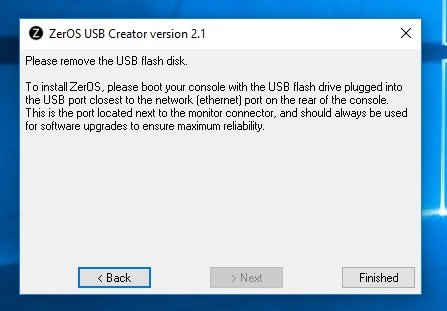

jb07 Posted November 23, 2018 Author Report Posted November 23, 2018 I have fallow the instruction of the software cf picture If I go to load; I have no file on the USB drive If I see the usb drive on a computer; I have a directory "install" and a file "6q_bootscript" Quote
Edward Z88 Posted November 23, 2018 Report Posted November 23, 2018 Hello, Running this software on PC is only required if your console is running ZerOS 7.8.3 or later. As you are currently running ZerOS 7.9.4.3, simply download the software from our website and, extract/unzip it to the root of a USB stick. Then plug into your FLX S, tap SETUP -> Load File, and choose the ZerOS .exe file. The console will run the software update, and when complete ask to you to turn the console off. The next time you switch the console back on the latest software will be installed, and the console will be completely factory reset. Hope that helps, any queries let us know. Edward Quote Edward Smith Formerly: Zero 88 Product Specialist - Email Support Currently: Obsidian Control Systems Product Specialist
