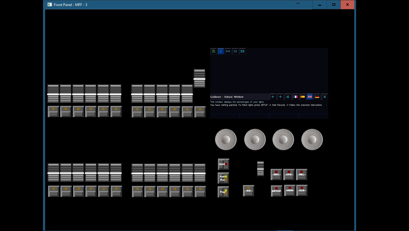

The Phantom ZerOS has a cleaner more native pixel allocation, except for the Front Panel window, which is almost unreadable, even at full maximised state. (please see screen shot attached).   And this happens for both "High Quality Scaling" on or off, in the settings.
Please advise if there is a way to setup the computer of FLX to obtain better images for any of the above.
Phantom ZerOS will scale the LCD on the front panel based around the rest of the console layout - this is why there's also an option to "Show LCD" as a separate window at the correct resolution.
