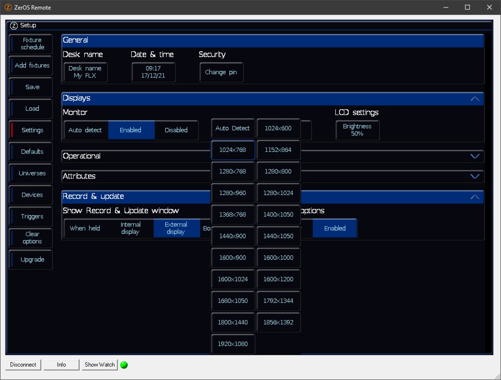

Kauz Posted December 16, 2021 Report Posted December 16, 2021 On 11/15/2018 at 10:09 AM, Edward Z88 said: (...) You can manually force your own resolution if you wish from the list of options FLX displays in SETUP -> System Settings -> External Display. I am trying to attach a VGA monitor using an active DVI-D -> VGA adapter. Therefore I have to select the resolution manually. However, with ZerOS version 7.9.9 I am unable to find a list of options in the Setup. I just find "Auto detect", and "Calibrate". I believe Auto detect will hardly work with the adapter. Even though the monitor is old, I would like to keep it if possible. Its form factor, fits perfectly to our operator's room. Can anyone tell me how to set the resolution manually? Quote
Edward Z88 Posted December 17, 2021 Report Posted December 17, 2021 Hi Kauz, 11 hours ago, Kauz said: with ZerOS version 7.9.9 I am unable to find a list of options in the Setup. I just find "Auto detect", and "Calibrate". On FLX, there will be a "Resolution" button available if the Monitor option is set to "Enabled", or if FLX detects a touchscreen when set to "Auto Detect". The following resolutions will be available... Hope this helps, Edward Quote Edward Smith Formerly: Zero 88 Product Specialist - Email Support Currently: Obsidian Control Systems Product Specialist
Kauz Posted December 17, 2021 Report Posted December 17, 2021 Hi Edward, thank you for your screenshot! I am still unable to find the resolution button on PhantomZerOS 7.9.9. I will double-check with our actual console asap and come back to you (i. e. to this thread). Have a nice weekend! Martin (alias "Kauz") Quote
Edward Z88 Posted December 17, 2021 Report Posted December 17, 2021 Hi Martin, 1 hour ago, Kauz said: I am still unable to find the resolution button on PhantomZerOS 7.9.9. I will double-check with our actual console asap and come back to you (i. e. to this thread). Have a nice weekend! The Resolution option won’t be available on Phantom ZerOS, as Phantom ZerOS will use your Windows resolution settings. (My screenshot was of ZerOS Monitor running on PC, connected over a network to a FLX). Let me know how you get on. Edward Quote Edward Smith Formerly: Zero 88 Product Specialist - Email Support Currently: Obsidian Control Systems Product Specialist
Kauz Posted December 19, 2021 Report Posted December 19, 2021 Hi Edward, today I spotted the button on the FLX. Must have overlooked it before 🙄. Thank you for your hint and your patience with my blindness! /Martin Quote
