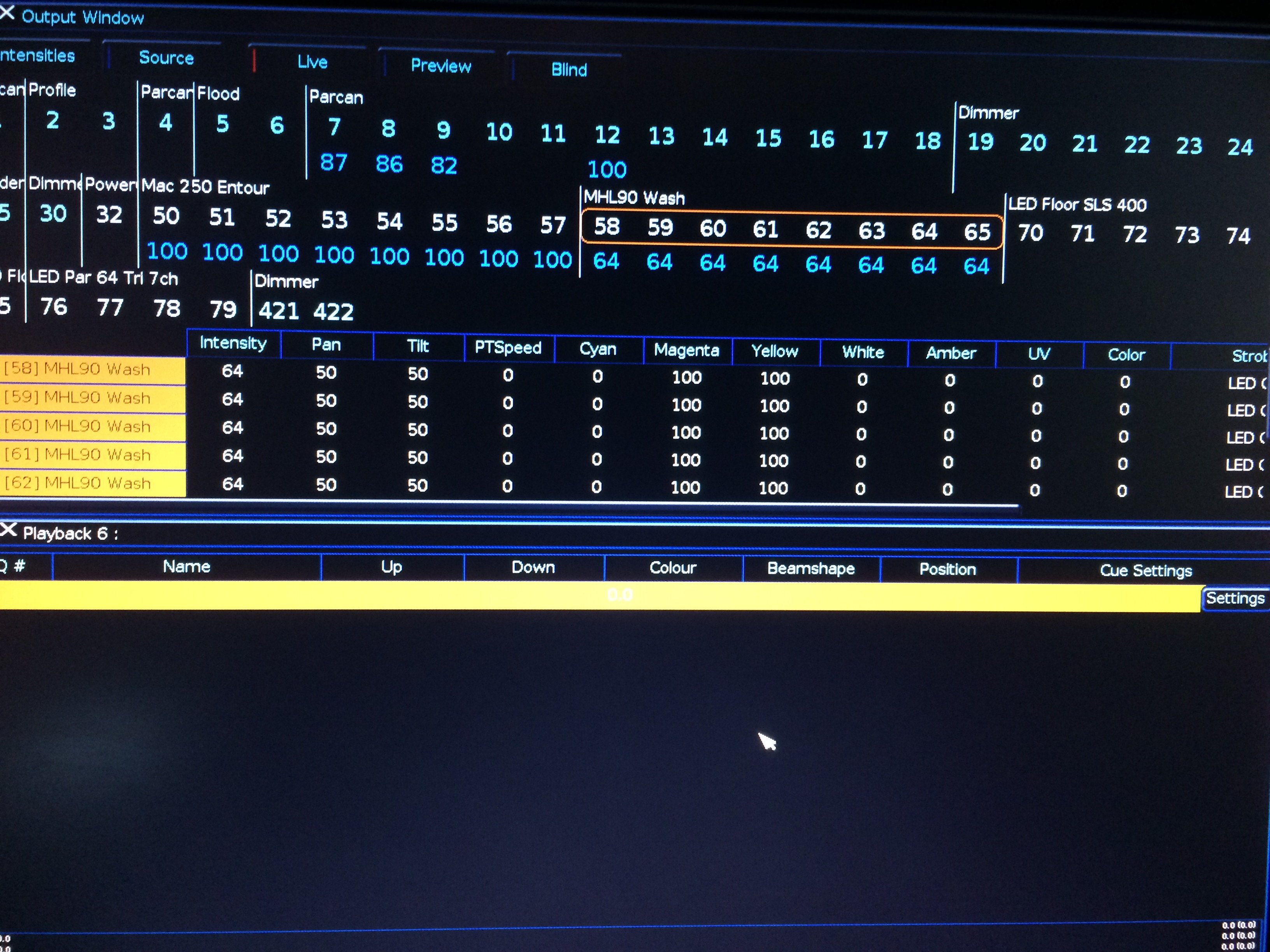

stowedout Posted September 29, 2018 Report Share Posted September 29, 2018 Hi Folks, See attached photo. I have chosen a group of LED washes and on my external monitor I can see the current setting for each fixture in the group. Playback 6 introduces a colour cycle to the fixtures. where do I see how this colour cycle is being generated? I expect it's an effect but where do I see what effects are attributed to each playback? (interestingly when playback 6 introduces the colour cycle the visible current fixture colour settings don't appear to change on the monitor ) Cheers Chris Quote Link to comment Share on other sites More sharing options...
Edward Z88 Posted October 1, 2018 Report Share Posted October 1, 2018 Hi Chris, The parameter table shown at the bottom of the Output Window in your screenshot, should show you whether an effect is running or not. You will see the effect palette number written instead of a value percentage for the parameters included in the effect. In your screenshot, cue 1 in playback 6 is displayed as yellow, meaning it hasn't yet been triggered. If you would like to preview this cue, make sure that you are viewing its playback, and then tap "Preview" at the bottom of the Output window. Selecting the fixtures included in this cue will then open the parameter table to show you what levels parameters are at, and whether any effects are included. Any queries let me know, Edward Quote Edward Smith Product Specialist Email Support Link to comment Share on other sites More sharing options...
stowedout Posted October 1, 2018 Author Report Share Posted October 1, 2018 Thanks Edward I will give that a try. (as you pointed out at the time I took the photo the cue was not triggered) Chris Quote Link to comment Share on other sites More sharing options...
